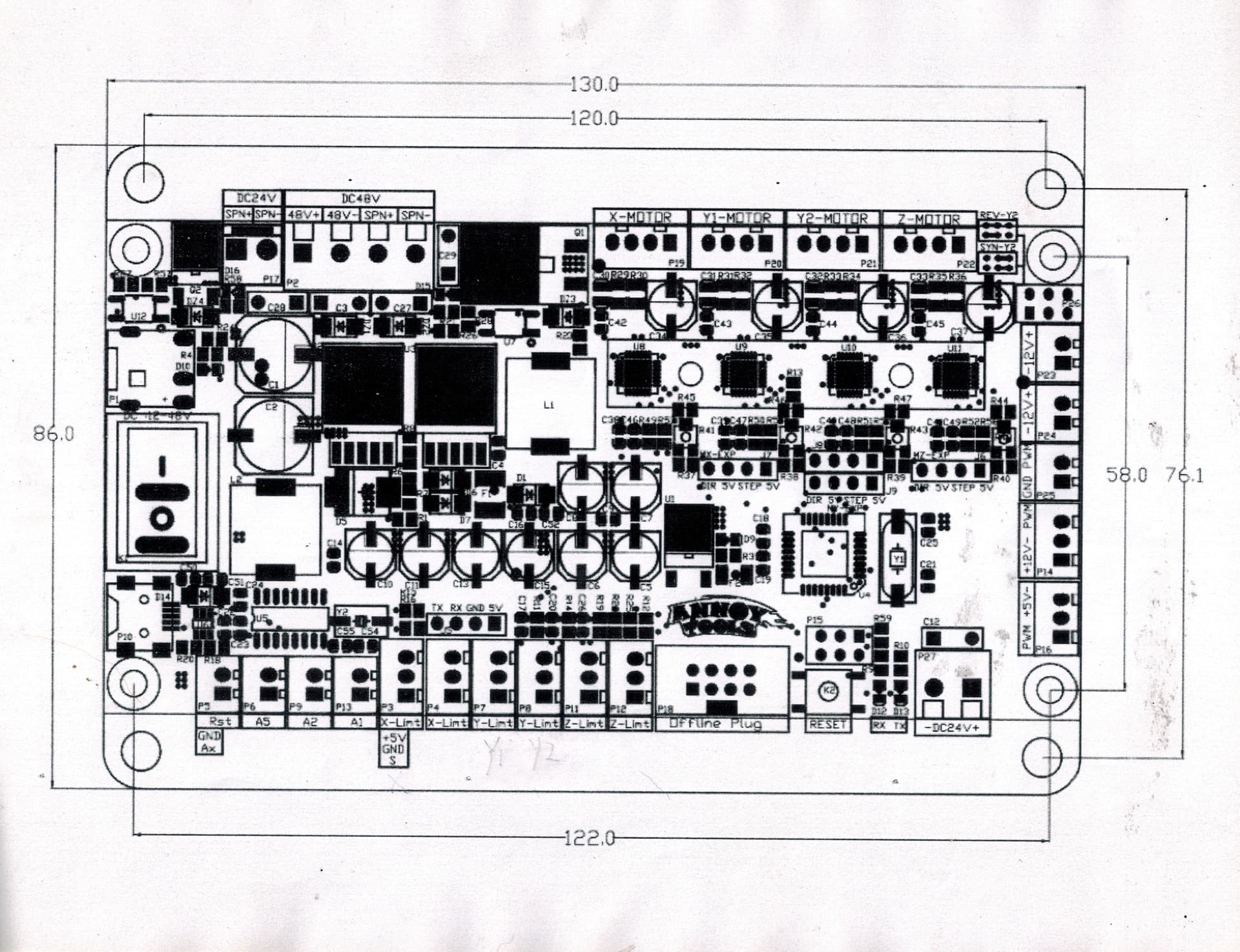

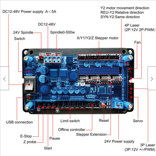

There are six connectors on the controller for the limit swictches…marked as X-Limit X-limit Y-limit Y-Limit Z-limit Z-Limit. I am only using X and Y…and those in the first X-Limit and first Y-Limit connectors just for homing…nothing on the other end for maximum hard limit. If you recall I switched the NC to NO switches. Z is disabled in the software.

The model # of the controller is model number: CB-3018-3Axis-5.3-B. As per the seller.

I’m trying to determine if the machine is having an issue moving or an issue with the addition of the limit switches. I’d like to know if it attempts to home with the limit switches ‘un plugged’ from the controller. It will help eliminate the switches, I’m hoping.
