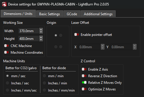

I have a custom built machine using a MKS-DLC32 V2.0 controller. When I am homing the machine the following is happening.
  1. Machine home fine
    2 Machine moves to the X3, Y3 offset that is programmed into the firmware to step off the switches

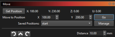

    3 Lightburn initially shows X0.00 Y30.00 and then switches to X0.00 and Y30.00
    4 I move the head to X100.00 Y100.00
    5 Lightburn reads the position as X100.00 y130.00 and physically that is where it is per measurements
    6 I repeat the move to X100.00 Y100.00 and the machine moves back 30mm
    7 Lightburn now reads X100.00 Y100.00
    8 everything works as expected until I re-home again
Video attached
Lightburn Homing Offset
Correction for step 3
3 Lightburn initially shows X0.00 Y30.00 and then switches to X0.00 and Y0.00

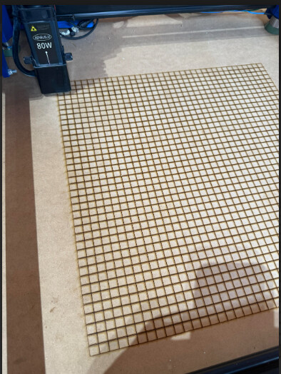

Using Absolute Coords, low laser power, and a 100mm square (anywhere in the grid), Does it etch a 100mm square where it is supposed to?
I used the Go button the Lightburn Screen to tell it to move
I engraved all of these as individual squares and they are all in the correct locations ( per measurements ) after completing the double move after homing

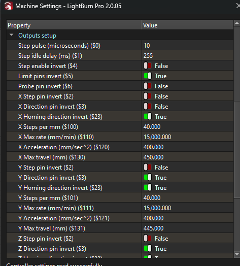

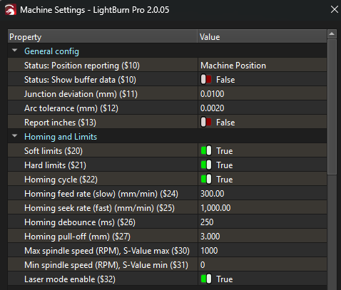

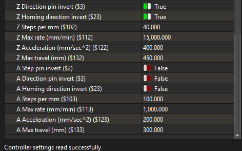

here are my GRBL settings

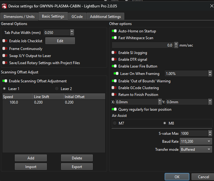

I have also checked the device settings in Lightburn - Cannot find anything the references 30?
Also - no matter what i put in for the goto location initially it is off by 30mm in the Y
Solved - Using OpenBuilds There is an option for resetting WCO ( I assue is Working Coordinate Offsets. This cleared what ever was set.
Is there someplace in Lightburn where you can see and set WCO’s ?
Not that I have ever seen. I only know about the $# command for GRBL to view them.
Glad you solved the mystery!
Yes. Not in LB, but in the firmware in general. Openbuilds is just using those commands in the background.
$# → show the offset coordinates
$RST=# → reset all offsets to zero
But you also can change the parameter $10 to make the firmware report either WCO or MCO. You can use the G10 command to set offsets. But that is usually also done via GUI in most tools.
