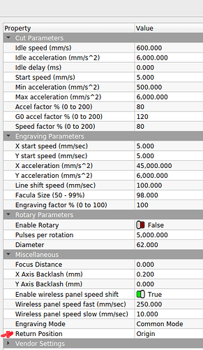

I have laser set to home to the back right when powered off. My question is as follows. I want the laser to home back to the start point of the job after completion, not to the back right. but upon turning the machine off and on I want it to home to the back rear. Can this be accomplished?
I am using Lightburn, and running a Laguna MX laser.

Set the origin on the console to where you want it to be.
In the Ruida controller you can set it to go to the origin when powered up… or done with a job. This is the return position in the Machine settings.
If this isn’t what you want… you need to clarify…
