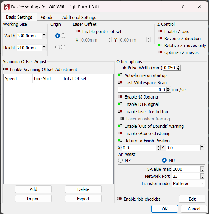

I have an K40 Laser with GRBL 1.1h (Arduino Uno CNCShield) and can not fix a problem.
Homing switches are at the left rear position and the Homing command is working fine (right direction).
Moving the Laser-Gantry by the Arrows in the move Menue is also working fine (right direction).
But if I draw something in the Workspace and send it to the machine it will not work.
The soft-limits are reached - if I disable soft limits the machine runs into negative coordinates and makes horrible noise.
I try to fix the issue since weeks but without any success.

Normally GRBL based devices for K40 machines use a bottom-left origin even while homing top-left. This doesn’t have to be the case, where Monport K40 is an example. Can you confirm that your preference is to work top-left origin with positive values as you move to the right and down?
Can you provide the following:
  1. Run these commands in Console and return output as text:
$H
$I
  1. Create a square in LightBurn and then do File->Save gcode, save with a .txt extension, and upload file here.

If I am using the arrows in the menu Move the directions working as expected - no issues.
Moving the gantry by this function → something went wrong:
Here is the requested data:

Can you clear the work offset by issuing this in Console:
G10 L2 P1 X0 Y0
$H
Can you return those results? If you get back something that looks like this can you please retest?
<Idle|MPos:0.000,0.000,0.000|Bf:15,137|FS:0,0>
So basically showing no WCO or a WCO of 0,0,0.

This time it says:
[VER:1.1h.20190825:]
[OPT:VMZ,15,128]
Target buffer size found
Next to the console commands - After that the machine is working :heart_eyes:
Even after restart it is working! :+1: Is there anything else I have to know?
