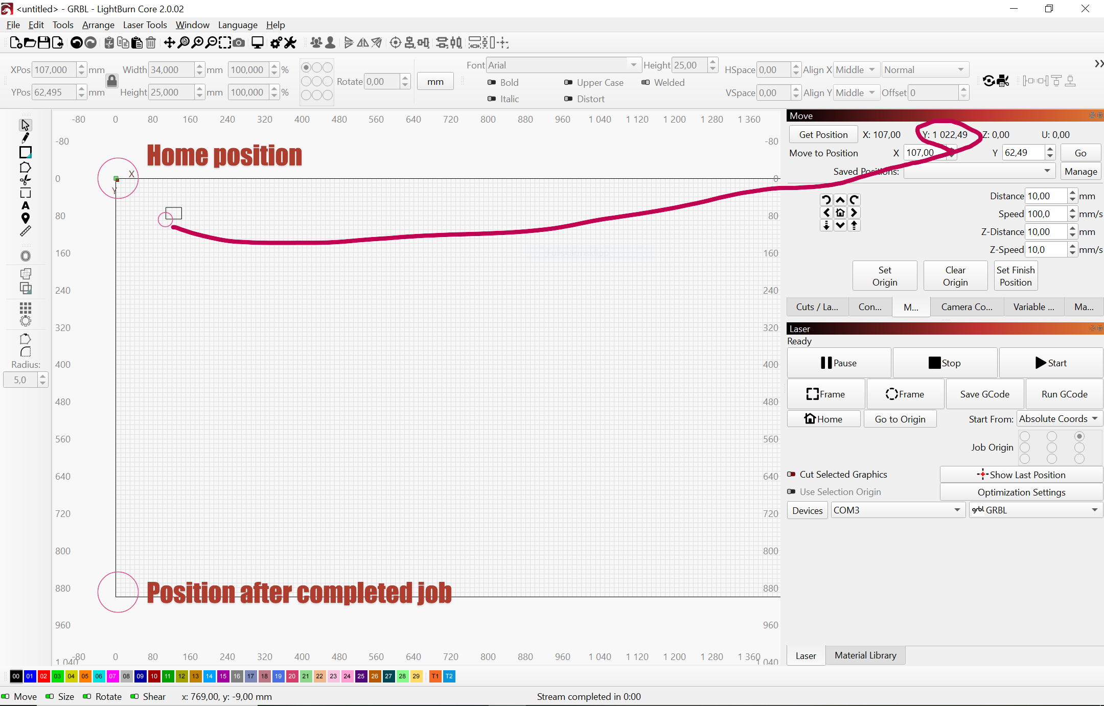

I have a problem that I hope someone can help me with. Homing works, but when I then press Frame, the laser head moves in the wrong direction along the Y-axis. If I press Frame again, it moves correctly (and then I can run my job correctly). Under the Move tab, I can only move the laser head along the X-axis.
Hardware MKS DLC32
I think I have tried all different settings of $2, $3 and $23
Error messages:
ALARM:1
Hard limit triggered. Machine position is likely lost due to sudden and immediate halt. Re-homing is highly recommended.
On or near line 1:
Stream completed in 0:00
SimpleLaser 1.1h [‘$’ for help]
[MSG:‘$H’|‘$X’ to unlock]
[MSG:Caution: Unlocked]
<Idle|MPos:3.525,6.293,0.000|FS:0,0|Pn:PY|WCO:0.000,-900.000,0.000>

This works, but Y now starts at 900 and goes to 1800 instead of going from 0 to 900. However, after a job is finished, the laser head moves to the lower left corner (0,1800) instead of the home position (0,900).
