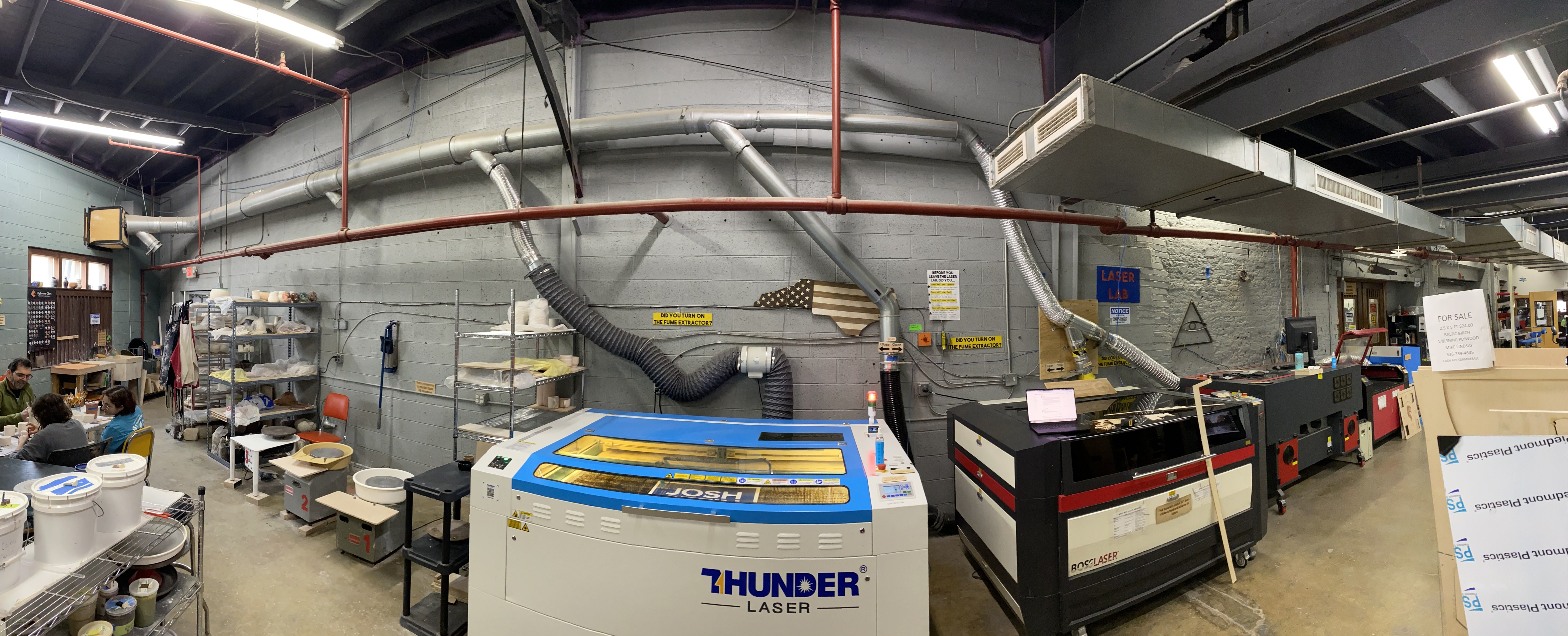

Hello! I run the laser shop at ForgeGreensboro.org community makerspace. We have multiple lasers all hooked up to a central exhaust. At the moment we are operating blast gates by hand to concentrate exhaust on the machines that are actually running. A fancy new exhaust system is being donated to us and it will include motorized blast gates!
My question is how to wire them up so they can open and close automatically when you turn a machine on and off. We’ve got three Ruida based machines, one Trocen based machine, and one Universal laser. We have a mix of brand names (Thunder, Boss, Universal) and two generics. I don’t yet have specs on the motorized blast gates, but I assume they’ll be powered directly from the wall and will just need a low power (5v?) signal to trigger them on or off.
Has anyone else worked with such a system, or set one up? I’d appreciate any insights anyone might have. Thanks!

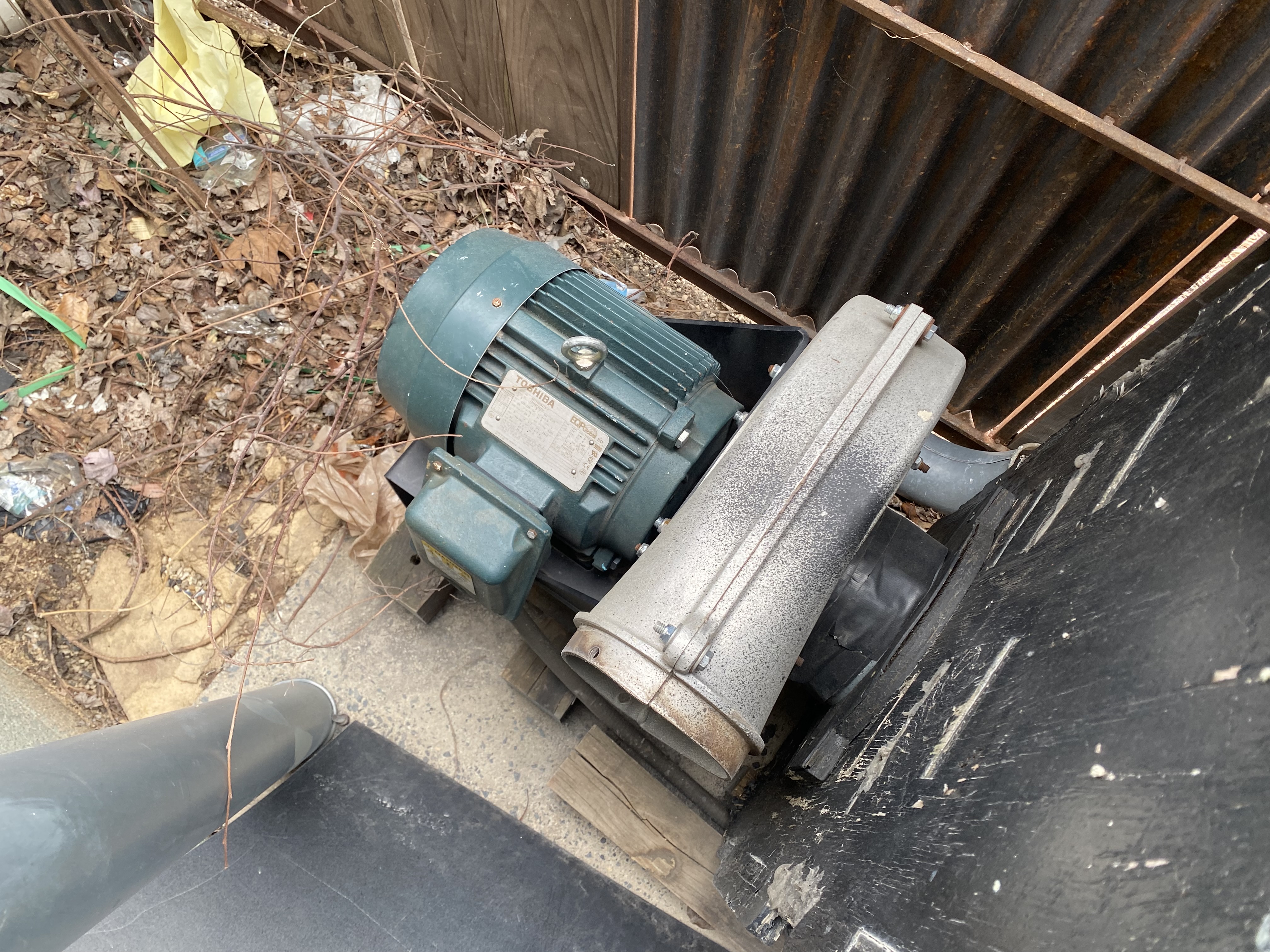

We currently have a system with an industrial blower outside, and ducts going to the four currently-online lasers, each of which has manually-operated blast gates already. The blower is on a dial (rheostat? potentiometer? not sure) which we adjust as needed. The new system will mostly be replacing cheap aluminum hoses and other “what we had lying around” wyes and other parts with custom built ducting. There is a weighted butterfly on the end of the central duct, which I imagine might address your concern, at least in part? But exhaust systems like this are not my area of expertise.
This is our current exhaust setup. The blower is outside.
