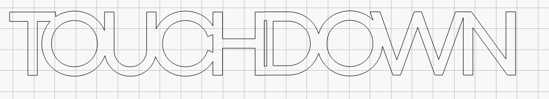

Horizontal spacing with letters
I used horizontal spacing to weld this word together. When I try to create the dividing areas between the H and D letters, it looks odd. Is there a way to correct this? If I reduce the spacing, it separates and doesn’t ‘weld’.
Font is called Fornix.
Thanks!
If you only want to change it between the H and D, you can use Edit>Convert to Path on your original text, to switch it from being recognised (on the back end) as text to it being lines/curves. This will mean you can no longer edit the text, but I assume if you’re welding it, that’s what you want anyway.
Then you can select the word “DOWN” and move it closer/further from the “TOUCH” as you see fit.
Then run your weld using the boolean tools: Modifier Tools - LightBurn Software Documentation

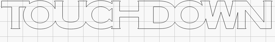

Tried a different font with your suggestion. Best I can do. Looks normal?
I’m not sure what you’re hoping to achieve, but that looks fine to me!
