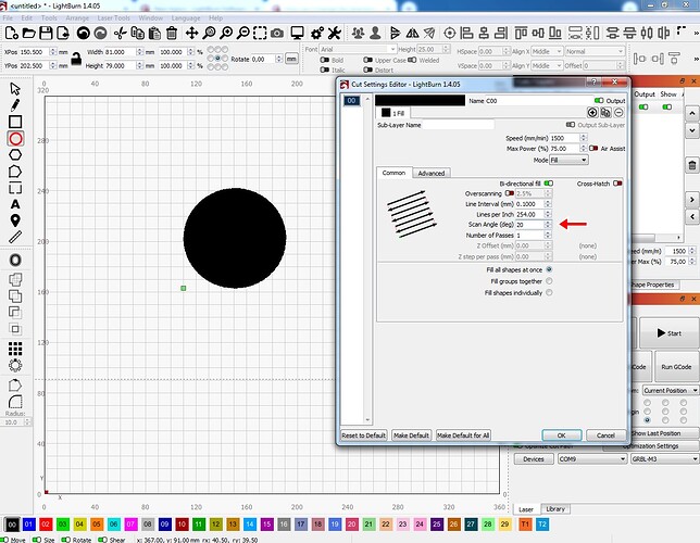

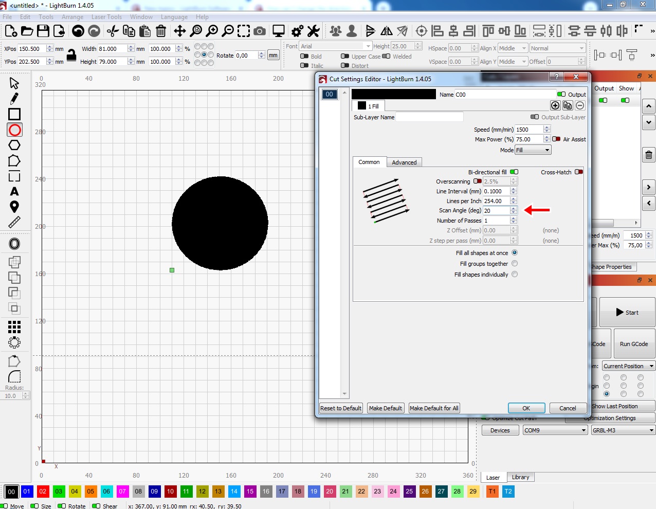

Before in old version I can double click on layer and select the scan angle but now I can not found the way for that ?
What version is in question?
In version 1.4.05 (which is the one I’m using) this option is found in the layer settings window and must be set to “Fill”
Thank you for reply, I know that but now I don’t find that option ! please see my shot screen

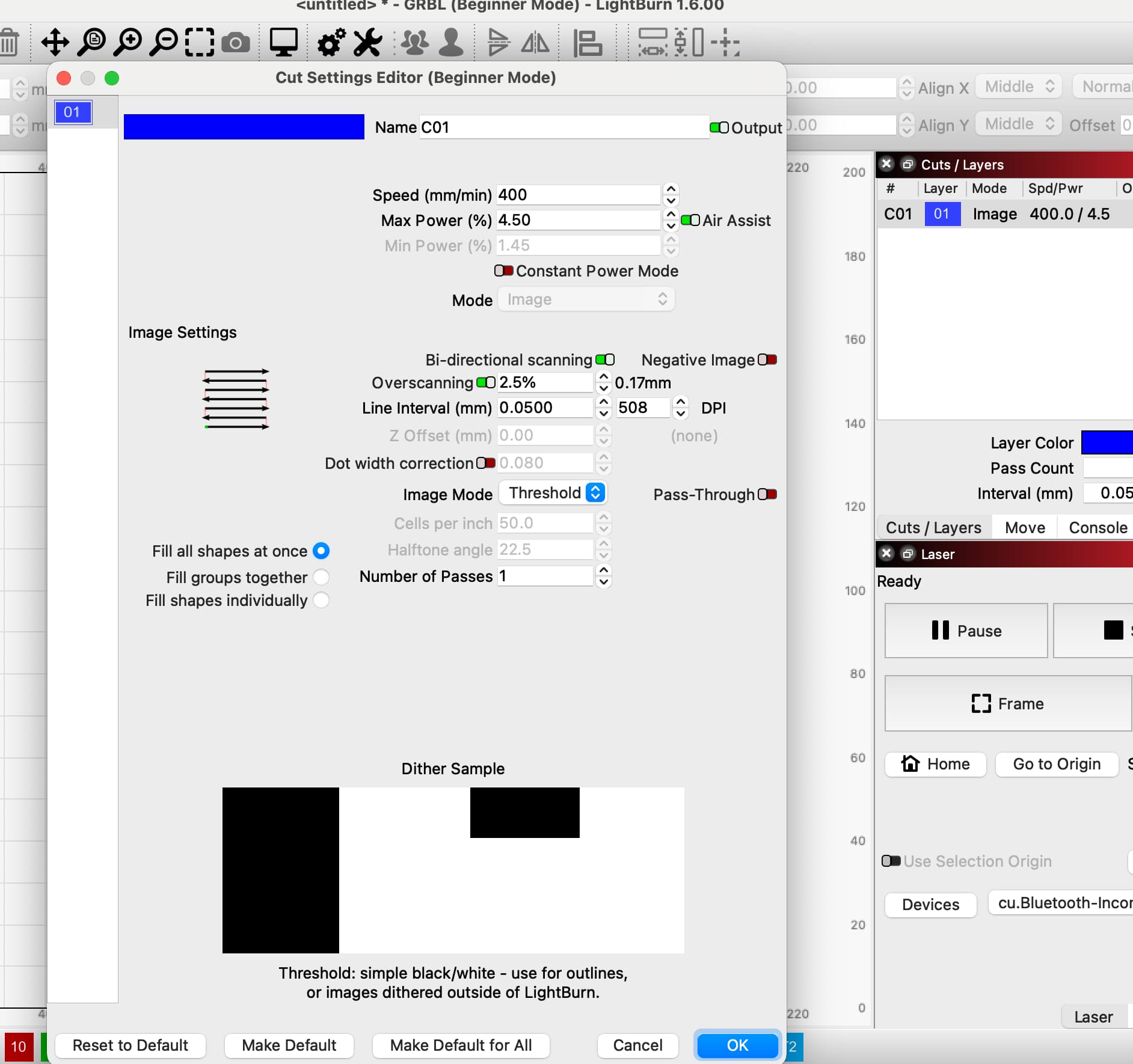

You are in ‘Beginner Mode’ switch that off in the Settings drop down menu and it will re appear
