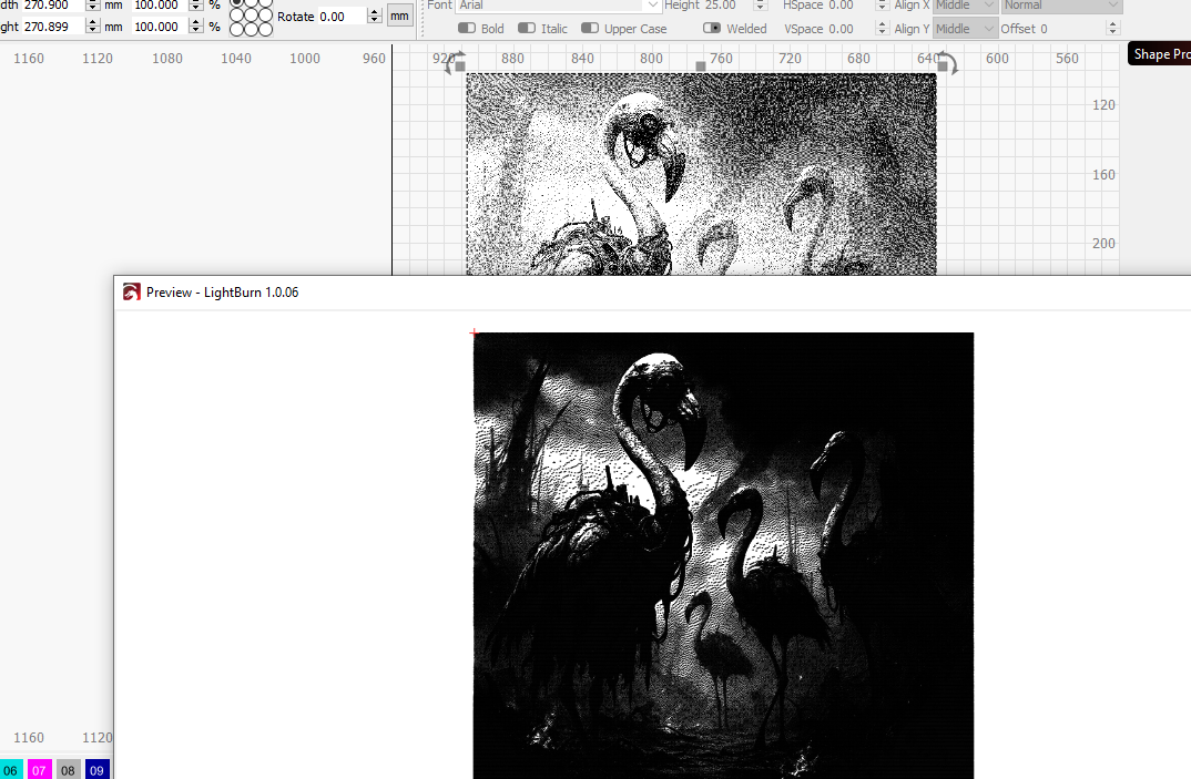

How can I import properly PNG files that are already dithered?
I want to burn a png file that is 10x10cm. I dithered it outside lightburn and the only way that it is imported with the correct size is if I save it 96dpi.
If I save it with 254 dpi then it gets a bigger size, but as I already did the dithering I assume I can’t just scale it back to 10x10cm.
What is the best way to do this?? Should I save it 96 dpi and then when burning the image how does it affect if I put it to 254 DPI? Also I note that if I press the icon to preview, it looks all very dark when I use threshold, which is not matching the dithered file, and only if I put greyscale it looks ok. Now this is confusing me a lot.
Thanks for your help

Yes I tried also with that option. Actually with all even dithering even I dithered before. The only one that shows ok is with greyscale.
Preview only shows you where it will lase. It cannot determine material or speed and power for that material.
Ok, so basically that is only the area? As it says to shade according to power I assumed it was going to be this dark. Thanks then I will give it a try to burn it. I did some tests of power previously so will use those settings.

Might try zooming in on the preview screen, it might help you out as far as seeing what it’s attempting to display.
I think you’ll find, that most images don’t look awful when previewed. I think it’s a lot of time and practice.. images are the most difficult thing to lase.

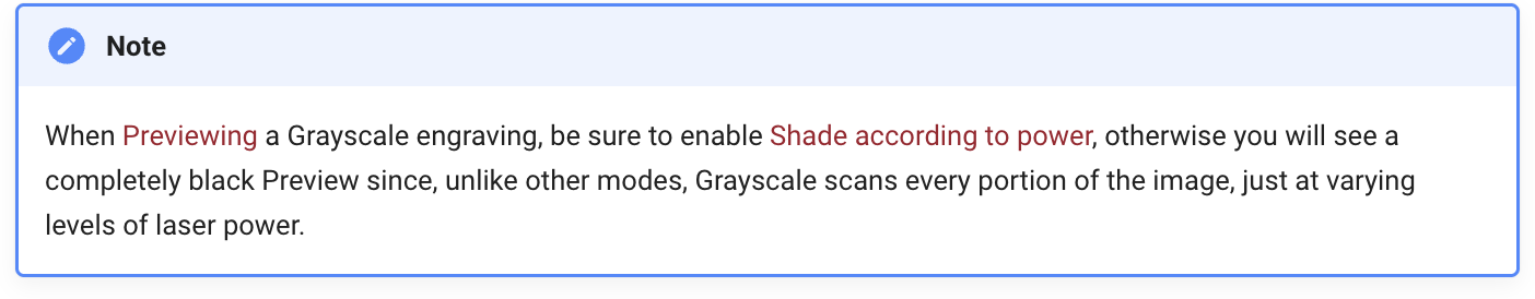

Yes and no. A dithering image does not use different power levels. It only uses black and white. So if it looks too dark, the DPI might be set too high (too many black dots). You can zoom into the preview to see how the dots are aligned.
Shade according to power is for grayscale image mode. Per documentation.
