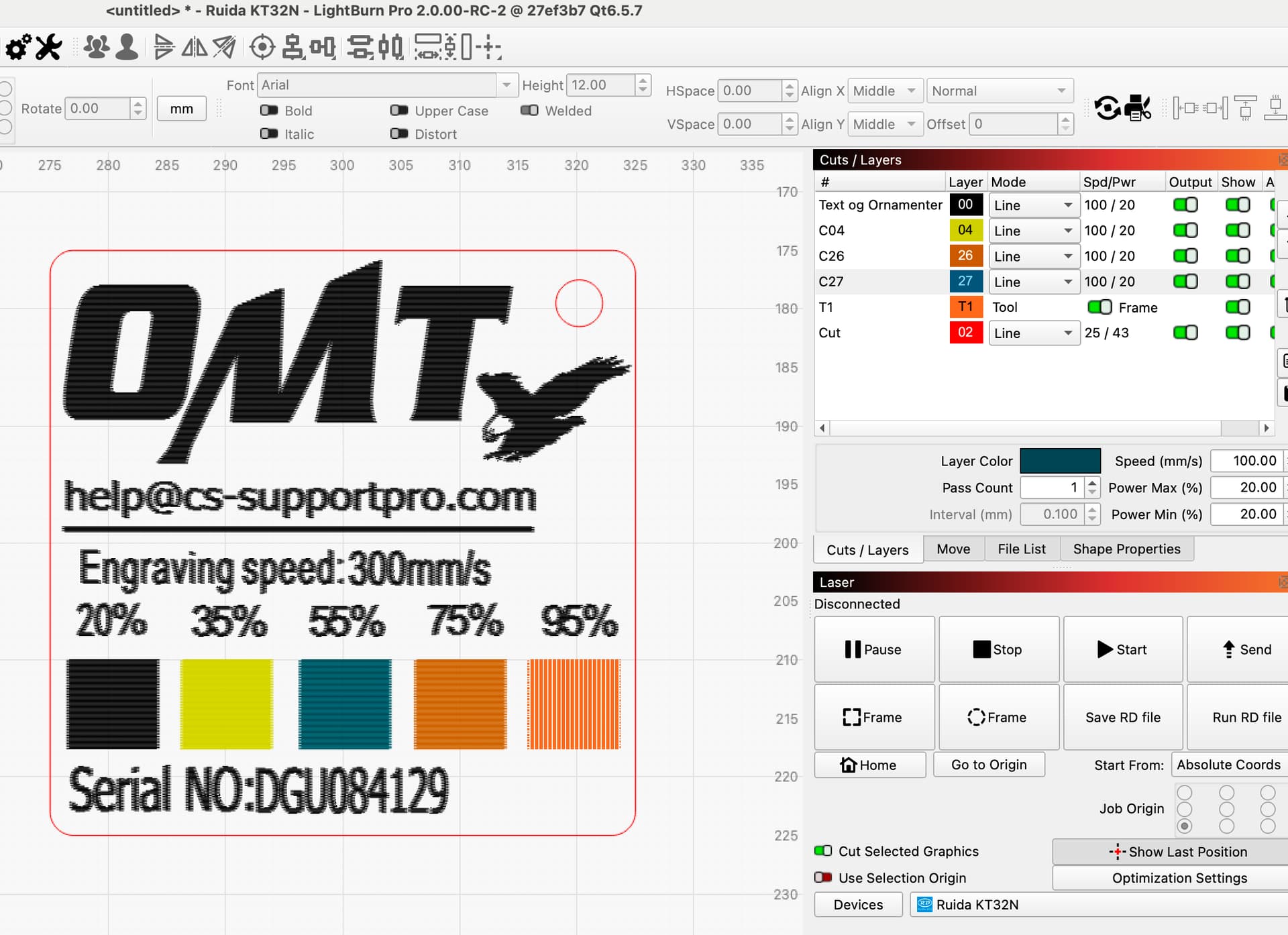

… you can import a .rd file but whether it opens as “drawing” - try it ![]()
I don’t think it displays anything, just ships it to the Ruida if remember correctly.
You MAY be able to write the rd file to a USB stick from the controller. My machine (Omtech, not Thunder) has that option, but I was unable to get it to work. I just tried it. Mine will not read from a USB stick either though.

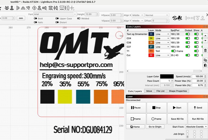

I formatted a USB Stick as FAT32, saved a rd file to the stick (test.rd), inserted it into my machine’s Udisk port, navigated to Udisk on the controller and chose load file. It said no files. When I tried to write from the controller to the Udisk, it said copy failure.
I did not try unplugging the extension cable and connecting directly to the controller with the memory stick, the cable chase is too close to the controller and I would need to disconnect the controller from the frame or rework the cable chase to have room to connect directly.
It’s not an issue for me as I connect via LAN. I was just trying to help the OP by seeing if it was possible to copy from the controller to Lightburn.
This is probably where the problem must be found. The Ruida Controller wants it “direct”.
And the File List menu from LB is also only a half solution because you cannot directly send and download files from there.
But, it just has to be said that I do not use this feature daily (in fact, not at all), it could be that there is a more smart fashion to share RD files on … for those who now need it .
