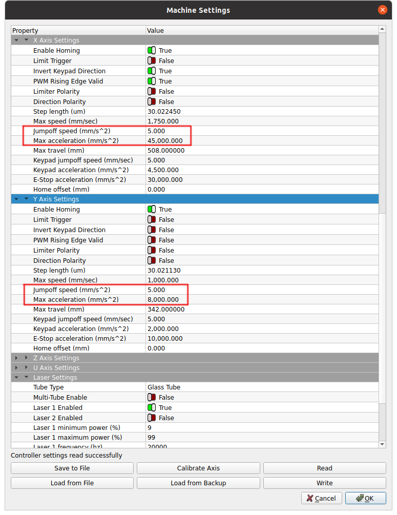

There are a few values you can change that will likely help you out.
  1. decrease acceleration values (not increase) on the offending axes, usually Y
  2. decrease the jumpoff speed values. This is how fast it accelerates to rotate initially.
  3. be aware of how the start speed setting relates to minimum/maximum power
  4. if possible, use a scanning operation over a vector, reduces movement on Y
Using the machine normally still makes use of min/max power settings.
There are also limits that can be set in the cut and engraving sections. I don’t know how they relate, such as how does the Ruida know a cut from an engrave.
Once you find these, you can save the file under a different name. When you’re done with the rotary, reload the machine settings you saved and you’re back to ground zero. If you want to use the rotary, you can read/load the rotary file. Of course you have to write them to the controller.
