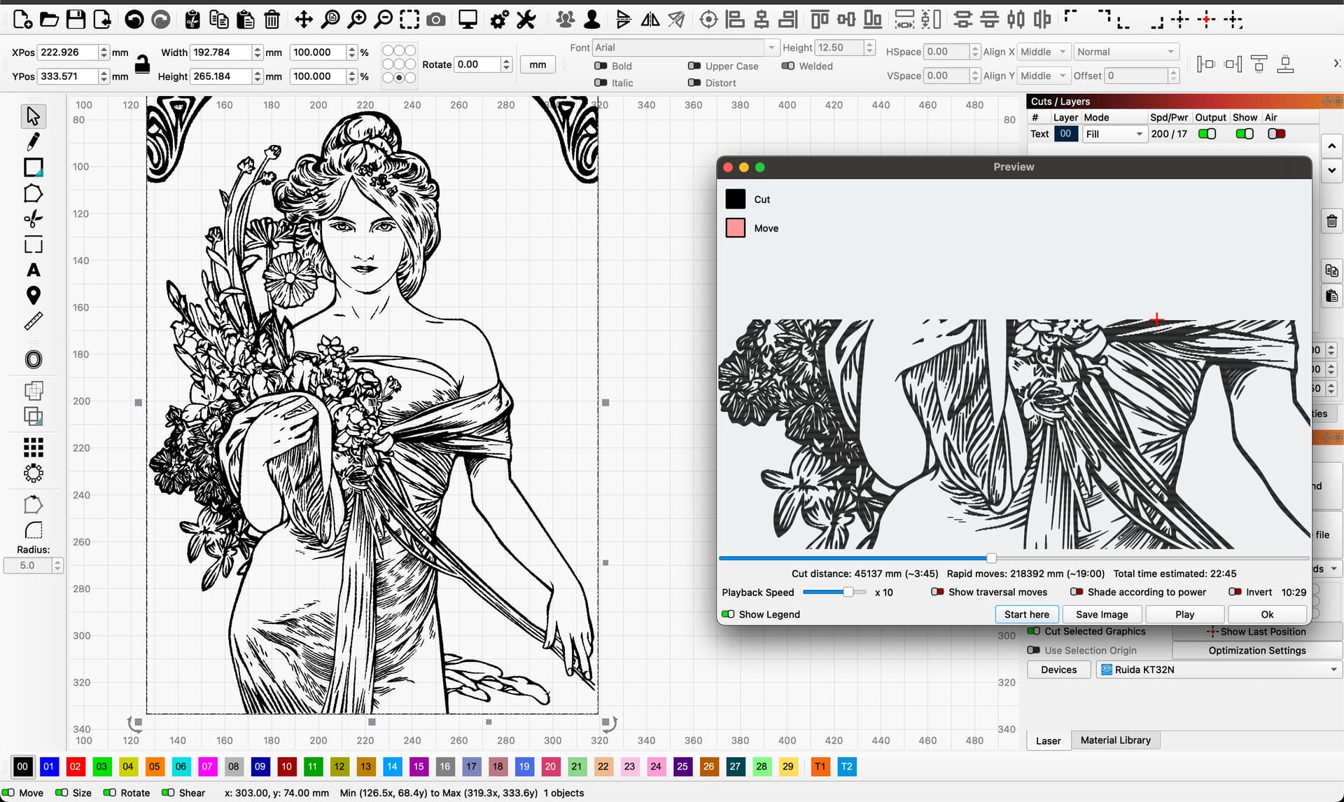

You can try to find a significant point in the file where you can stop the current job. By using the preview window and the “Start here” button, you should be able to continue without visible overlap. But of course you must not touch/change the position of your semi-finished product in the laser.
The best way, however, is to divide a big project already in the design phase into several segments and use a rig with repeatable coordinates, then you can in principle continue a product when it suits you.

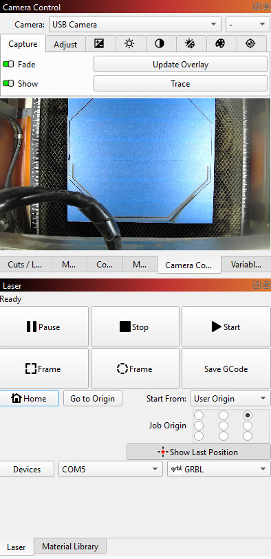

I am new to laser engraving, and I need more help. I don’t know what you mean by “use a rig with repeatable coordinates”. What is a rig?
I also, I don’t think I have a preview window in my version or with my laser. I do have the camera view, is that what you mean by preview window?
I also don’t have a “Start Here” button.
Here is an image of what my desktop looks like.

Let’s start from the back. In my picture you can see the preview window on the right side with a slider that can be used to manually simulate a scan/cut process. If for some reason the process was stopped, it could be during the cutting operations that the laser did not cut through all the wood…, then you can move the slider to the point from where you want to start again - “Start here”.
This function and display is there in all LightBurn versions (for fiber optic galvo machines, I don’t know if the functions are also used, it is a fairly different process though)

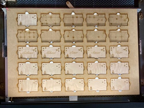

It’s probably more correct to call it a jig and not a rig, but it means the same thing.
What I mean is that you should have the ability to fix your material/part in your machine - on your machine bed, so that you can continue a job by placing it in its original position, if you need to continue the same job or make a 1 to 1 copy.
By using a fixture (rig) and absolute coordinates, you can use a project you have made before and fairly quickly start making new products again.
In the picture you can see a rig to hold place cards.
I have mounted 2 pieces of aluminum angle, which are exactly 90 degrees to each other. By using material that typically (should) have at least a straight 90 degree angle, the material is placed very precisely with the left top corner in the same position. The template for the cards refers to a LightBurn file, all I have to do is insert new cards and use a file with names to automatically make new cards. When the front is finished I turn the cards and change the motif and continue.
A template / rig is characterized by being able to fix material precisely and repeatedly.
The LightBurn file must always be adapted to the specific template / rig.

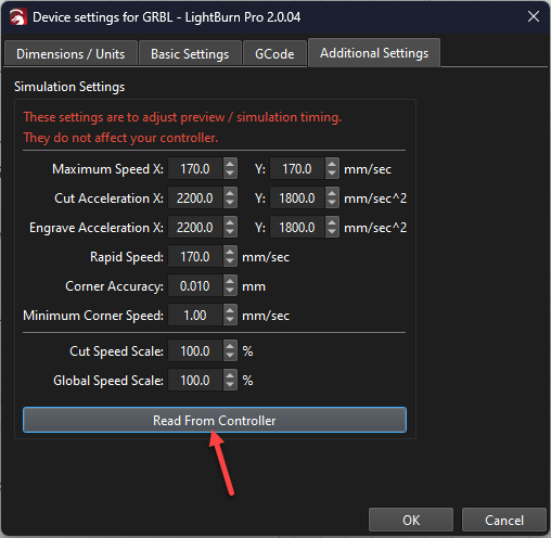

The other thing worth mentioning here is that the time remaining in the status bar in LightBurn is just an estimation, and if you haven’t already done it, in your Device Settings, click on ‘Read From Controller’ to update LightBurn with more information about your machine so the estimation can be more accurate:
See also: Get Accurate Job Times in LightBurn
