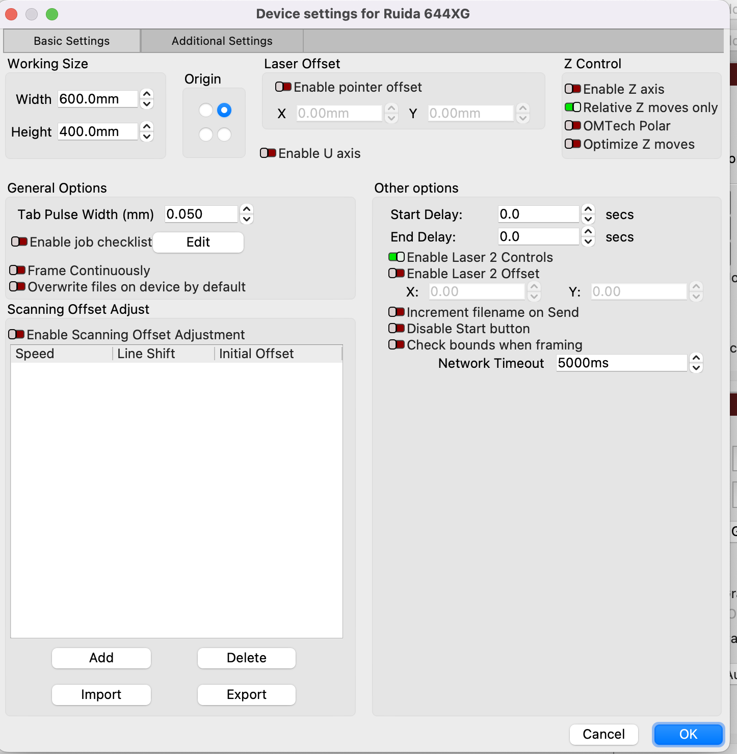

Hi,
I’m using Rudia 644XG and LightBurn 1.7.07.
I’m trying to calibrate the laser and want to add the test fire button. I looked in the device settings but can’t seem to find the option to add the fire button.
I’ve attached my device settings. Can you tell me how to add this?
Jake
It should be there under Other Options. See if you are in Beginner Mode. If so turn it off
Thanks for the quick reply. Beginner mode was already off.
As far as I am aware the Fire Button is not an option for Ruida controllers for safety reasons, at least it wasn’t.
Jake seems to be correct.
While LightBurn offers a “Fire Button” for certain laser types, it’s not directly applicable to machines using a Ruida controller. Ruida controllers, often used with CO2 lasers, have their own manual control mechanisms, and the LightBurn “Fire Button” feature is designed for GCode-based systems.
But I also found this.
To add a “fire button” functionality for focusing and positioning with a Ruida controller in LightBurn, you’ll need to enable the “Enable Laser Fire Button” setting within the Device Settings, then restart LightBurn.
So i guess if you have a GCode machine you can add it. It you have a CO2 machine you cant
