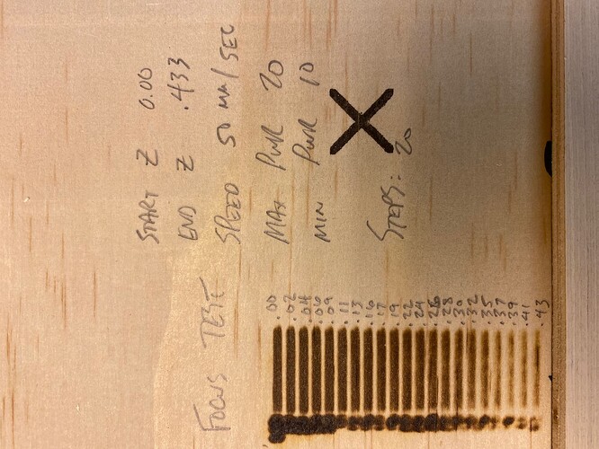

Yes, I’m trying to make the outline of the text thinner. I’m also having the same issue with a simple box that I drew around the text. I ran the text with two parameters - 100mm/sec speed and 40% power and then 100mm/sec and 20% power and the line thicknesses are the same. Can you tell me how to get the finest focus inside the software?
Maybe I wasn’t clear in my previous post. This is not a software thing. This is something inherent in lasering.
Essentially line operations in LightBurn assume the laser width is infinitely thin. The actual laser dot width is determined by physics. LightBurn isn’t really involved in focus other than potentially triggering an auto-focus request. However, it’s up to the machine itself to provide that capability.
Can you provide details as to the type of machine you have? Does it have auto-focus capability, and if it does, has that been calibrated? If it’s manual focus, how are you focusing the laser?
In any case, I’d suggest running some focus tests. If you have a motorized Z-axis you can use LightBurn’s Focus Test (Laser Tools->Focus Test) to confirm optical focus.
If you have manual focus then a ramp test may be the best approach for confirming focal height.

Hi berainlb, I ran a focus test with 20 steps which resulted in a series of lines that got lighter as it went along. The speed was at 50mm/sec, max power was 20 and min power was 10. I’m not sure what the results of the test is telling me. Could you provide some info on this?
After the focus test, I realized that I had the focal length set too far from the material. So I set the length using the gage and the lines were much thinner. I’ll keep tinkering with this. Thanks for your help.
Can you provide a photo of the results?

This was before I changed the focal length. Which is probably why the lines are so thick.
Is that the thickness of line that you’ve been dealing with?
If so, there’s something more fundamentally wrong with your setup.
You should have a very thin line no thicker than about .2mm.
Can you confirm the type of laser you’re working with? You list Ruida as your controller so I assumed this was a CO2 laser. Is that correct? What is the focal distance of your laser lens and how are you focusing the laser currently?
Start with what you think is ideal focus. Then I’d suggest rerunning the focus test at .5mm increments both higher and lower than starting focal distance. This should confirm whether or nor your focus is ideal.
Once you do that, identify the thinnest line, then repeat the focus test but at .1mm increments. Then identify the thinnest line.
Once you’ve done that, you should now know the proper focal distance. At that point you could create a new gauge that matches that distance or come up with some other method of getting to that ideal distance.
