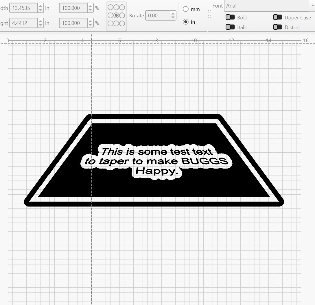

Lightburn can apply text to a wavy line. No need for Inkscape now.
To quote Bugs Bunny, “That’s great, doc, but can it do dis?”
Created using the linked tutorial with Inkscape, providing some options to the original query.
Is this close enough to illustrate a feature?
