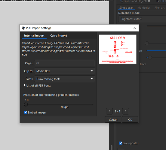

How do I engrave text from a jpg?
It shows me this box. Once I hit Okay, I get nothing
I just realized the file says exported from inscape. Sorry I was confused.
That looks good. Here’s what I get:
Pressing “OK” gives this:

When I tried to import it into Inkscape, something about the PDF made it just not work at all. Didn’t throw any apparent error messages, but nothing imported.
I don’t know what’s funky about the PDF that it glitches Inkscape’s native PDF import function, but fortunately, that shouldn’t be a problem. Don’t use the “Internal import”. Instead, click over to the “Cairo import” option (or in other builds of Inkscape, select “Poppler/Cairo import” on the import dialog). That’ll import it using the alternate method. It imported just fine for me using the Cairo import.

Switch the import to Cairo, then it works.

Strange, it worked fine for me without having to switch to “Cairo Import”, “Internal” works just fine in Inkscape 1.4.
@Marcus_Wakefield thanks for the heads up. I was using Inkscape 1.2 - just downloaded 1.4, and it works exactly as you stated

Yep, same here. If you uncheck “Import Pages” it won’t add a new page, it just imports the geometry.

I might have found a simple solution. I opened the original PDF you sent in Adobe Acrobat. I then went to print and printed it to PDF again. That file successfully imported into Lightburn.

Weird thing is when I printed to PDF everything’s there. It disappears on import to LB
Just so you guys know, we found a workaround. The person who created the pdf made a copy with very high resolution, then shrunk it to 7X5.5 and made it a jpg. I imported the jpg to LB and traced the image and it looks good. Here is a close up of part of the label.
