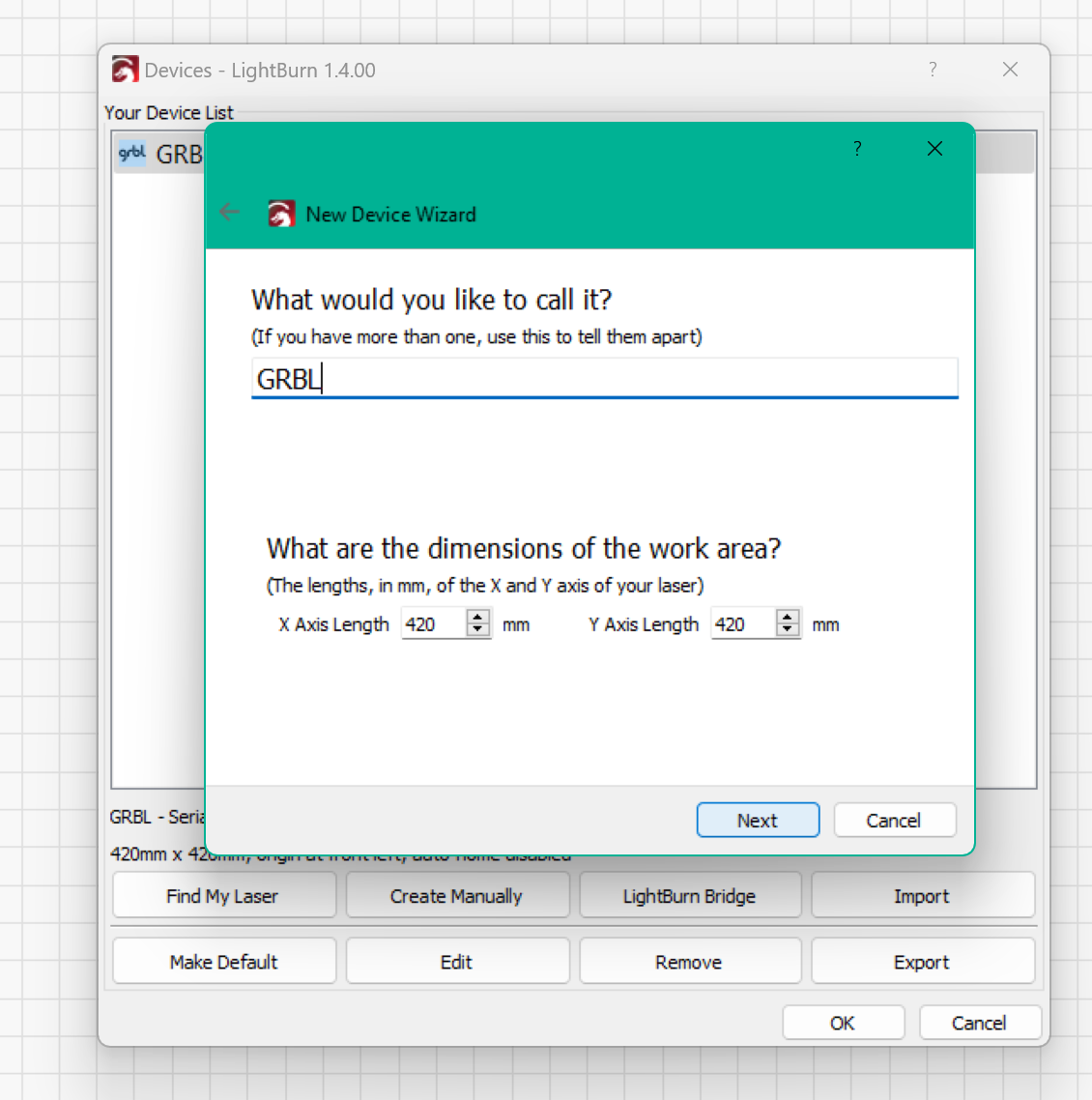

The grid is representing your work area, defined by your device settings.
You could change your device settings, but it might conflict with what your laser is able to do.
Not in front of my system at the moment, or I would give you more thorough information.
The grid is the actual size of your cutting area on your laser.
But you can change it, go to ââDevicesââ down on right side.
Highlight your machine and ââEditââ
^^ That ^^
But keep in mind⌠if you change this setting⌠just so your screen fills with grid⌠you have also redefined your work area for the device. You donât want Lightburn to send data that your device canât physically reach. And your warnings about âitems outside of work areaâ will not be correct either.
If all you want is more grid on your screen, you just need to zoom in.
Altering your device settings will truly alter your device.
Just my $.02.
Jim

You have the option to zoom your view of the grid, in and out, as well as pan around the view window. As others have mentioned, you do not want to change the defined size in the Device Profile, as that will produce your jobs incorrectly or in a different place than expected. The idea here is by defining the actual physical size of the laser in LightBurn, the software is informed of the real available space you are working with. If you modify those numbers, LightBurn will think you have that much room to produce, which you donât. ![]()
