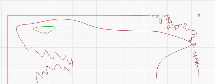

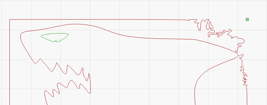

How do I fill in a missing line on the fin in a picture and then remove the outer lines leaving just the shark? Just started today with program:)?
quick answer:
node edit for the fin.
offset 0.00 inward to fill the body of the shark.
