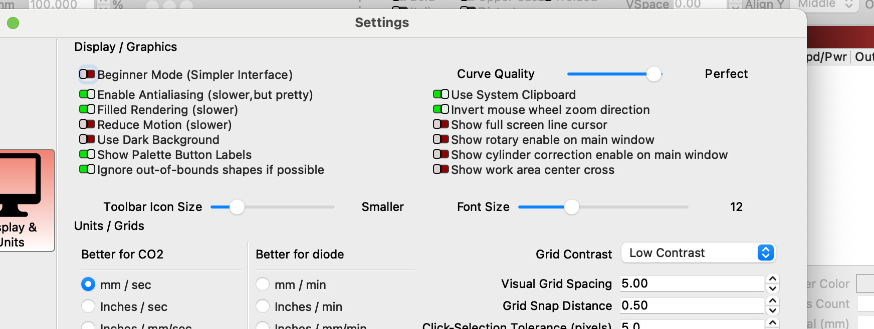

Hi folks how do i go back to a previous update
The reason i ask is i have updated and all the icons have shrunk in size im having difficulty seeing them :frowning:
It is not necessary if you have no other problems with this update. Go to the settings and decide how big you want your icons and the font.

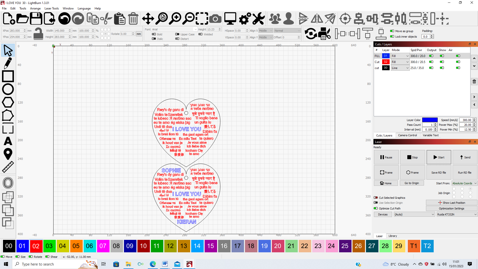

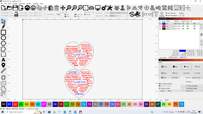

: i do have one more question
if i do text and click the fill
the text on the screen fills in but now it stays as line but it does engrave as fill
It’s fine that you didn’t have to install an old version.
Your other “problem” could be the font itself, but that’s not easy to judge. Try posting the file here, I’ll look into it.
This is a display property based on the View Style in Window menu. You are likely using a “Wireframe” instead of "Filled’ View Style. The LightBurn team generally recommends learning to use LightBurn with Wireframe for various reasons but it can be useful to use Filled at times to get a sense of how something might look while designing.
