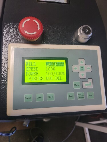

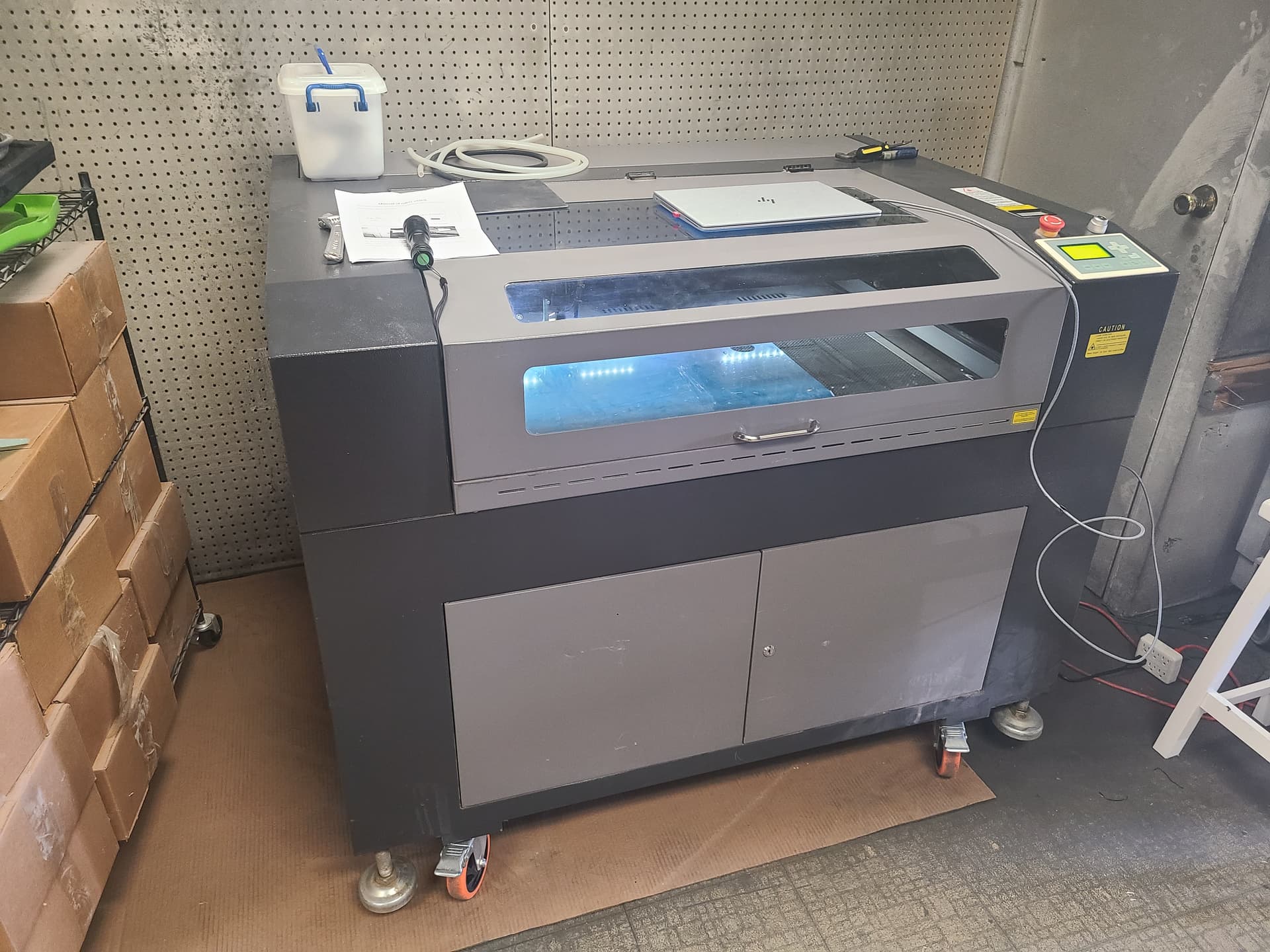

Here is a picture of the unit and of the control panel. The tag says it was made in 2014.
This looks like a Leetro DSP motion control system. We currently do not support this control system. LaserCut is the software used to drive this system.
From our nice friends over at https://lasergods.com/controller-dsp-identification/
Leetro AutoMation Co.,LTD (Leetro DSP)
LightBurn Software will not yet work with this controller. There are quite a few requests for this controller. They have an MPC6585 and are exploring the possibilities.
The Leetro Series controllers are very similar to the other DSP’s in function and form. These DSP’s use proprietary software called LaserCut and no other software solutions are available at this time.
