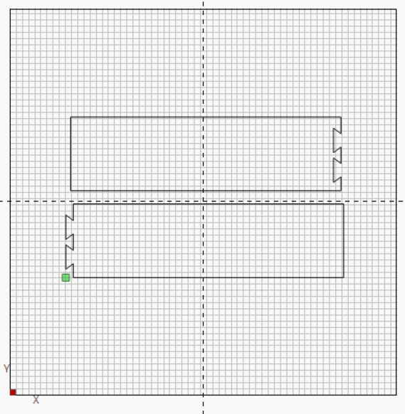

What I am looking for is taking the tabs I have created to connect a jig holder to a work piece.
Basically, how can I make them repeatable for other jobs as well. Connecting left and right then having tabs along the bottom.
What I have displayed took me all afternoon to figure out.
Thinking, (sorry for the grinding sound :zany_face:) I might should have saved some of my previous work. It may have made it easier.

All I want to do is duplicate my dovetail pattern repeatedly at the bottom of the current boards and future projects boards exactly.

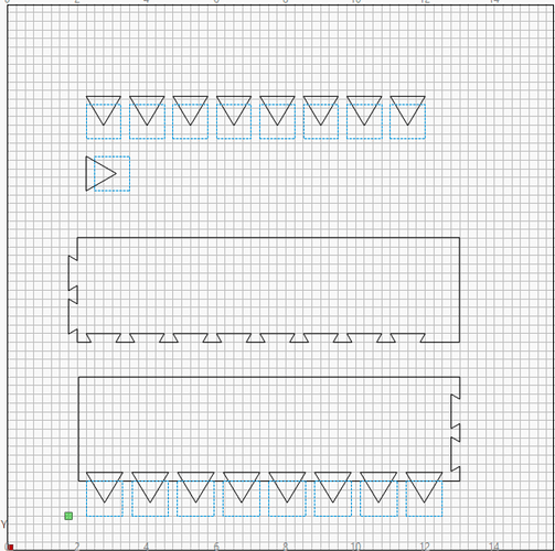

If you can come up with a single tab / socket pair that matches correctly, store it in the Art Library and deploy as needed.
To get consistent spacing, use the Grid Array tool to replicate that pair with exact linear spacing, then splice them into the perimeter of whatever you’re building.
I’d try really hard to lay out the tabs symmetric with the midlines of the shape, so I could snap / align the arrays to the shape without numeric fiddling.
If you design the tab sticking out of a rectangle, you can align the rectangle edge with the main perimeter, then Weld the shapes to put the tabs in place.
You can convert the socket into a positive shape (similar to the tab-on-a-rectangle), align it so the fake tab sticks into the main shape, then Difference it to leave the socket.
You can add construction shapes / targets / lines on Tool layers to the tab design to simplify snapping them into place.

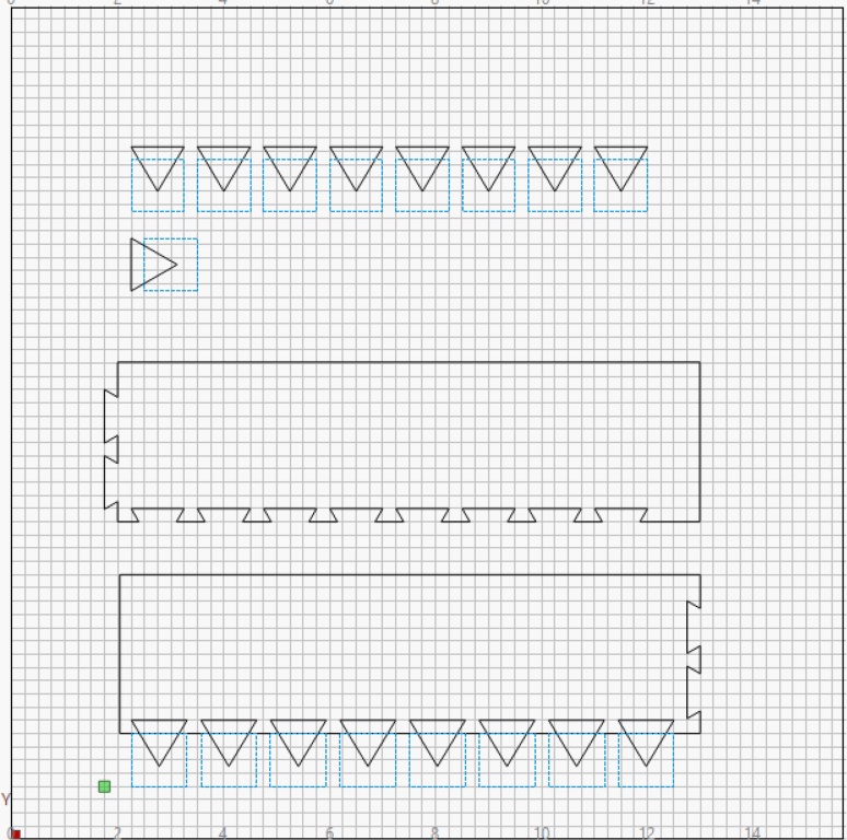

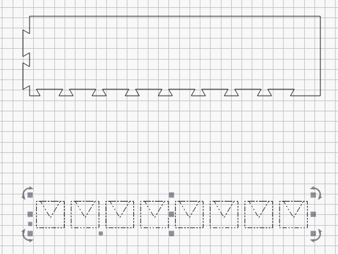

I created a square and triangle combination for size and depth duplication. Square is a Tool from the pallet and triangle using black. The square is placed to accurately place the depth of the tab, both the tab and the subtraction. Then used the array tool.

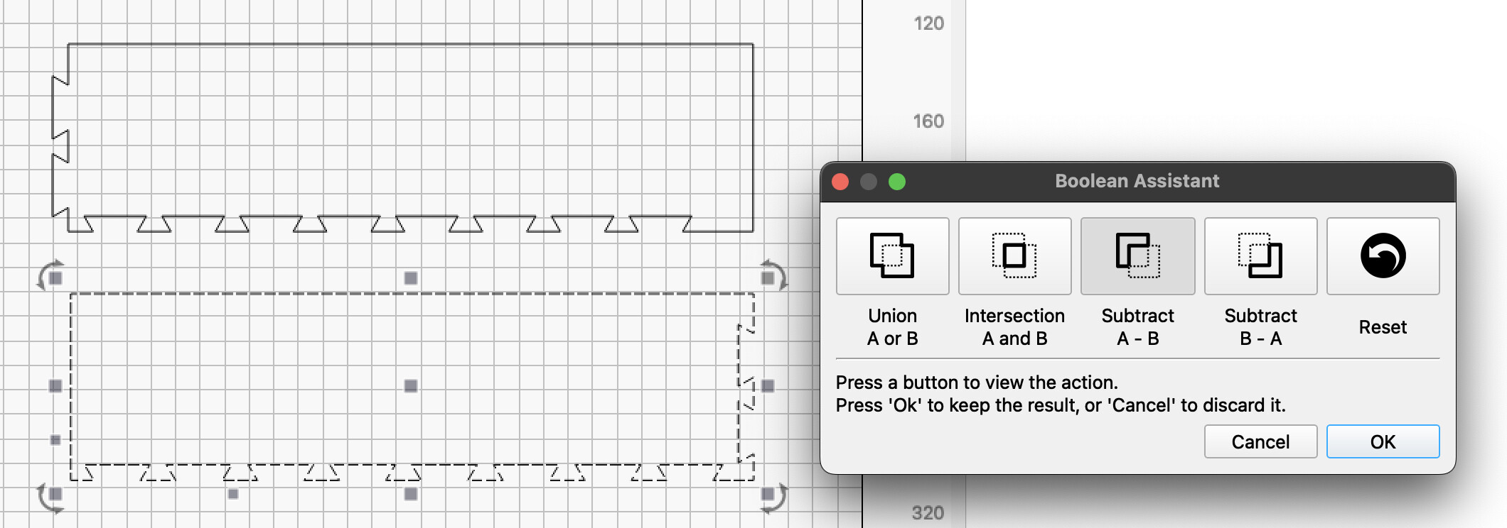

I have one half of my holder complete with Boolean Subtraction. However on the second half, for some reason, Boolean Subtract isn’t working properly? Including image and file for input as to why.

Is this the result you’re getting with subtract?
If so, it’s because of your selection order. There are a few ways to address this. First undo and select the subtract button again. That will change the subtraction order. Second option, select the other shape first, then subtract. Third, and my favorite, use the boolean assistant (Tools Menu> Boolean Assistant or CTRL + B). That way you can preview what will happen before committing.

Ah… Got it! Thanks.
Weird thing, I had saved the project and closed Lightburn.
I reopened Lightburn a minute ago and it worked fine not doing anything.
FYI, I always use CTRL + B to open the selection tool. For some reason it was acting up. Restarting must have corrected the issue.
