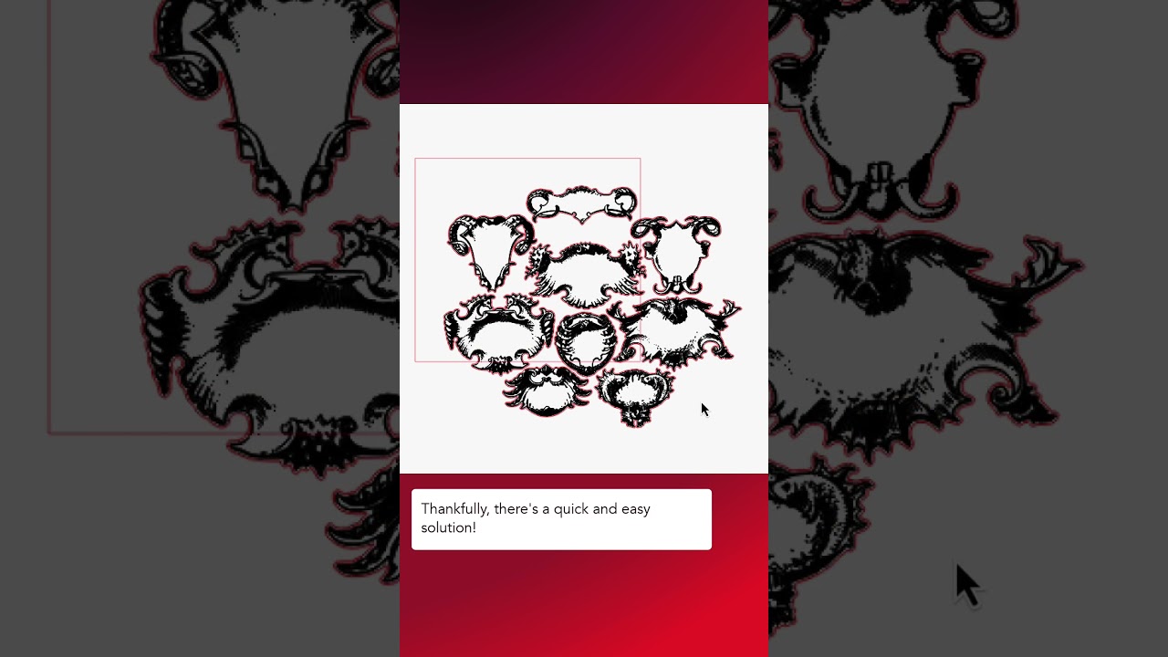

This video that LightBurn recently put out explains a feature that might help:
Unfortunately it doesn’t seem to work properly, for this job anyway. It leaves random letters ungrouped from the rest
Set your blue layer to “Fill” mode. I tested it with “Line” mode, and it didn’t work correctly, but it worked when setting the blue layer to “Fill” mode.
I’d highly recommend sending this issue to support@lightburnsoftware.com. I’d include files, as well as a description of the issue, so that they can either resolve the issue if it’s a bug, or advise as to why it’s doing what it’s doing. It certainly should include everything withing the outer perimeter though.
