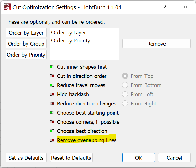

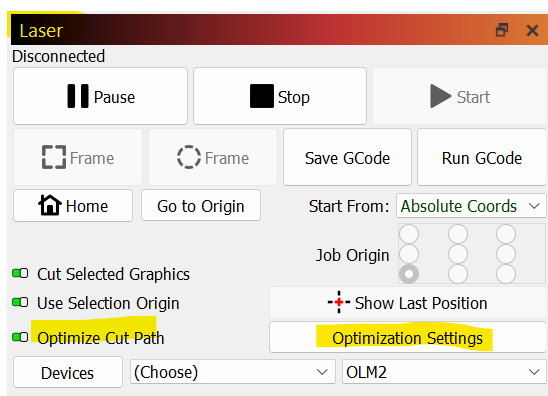

Assuming the shared line are directly on top of one another you can avoid the duplicate cut by using “Remove overlapping lines” option in Optimization Settings found in Laser window.

Optimization Setting is Literally a button in the Laser window:
Pushing that button will open a new window where you can enable “Remove overlapping lines”.
