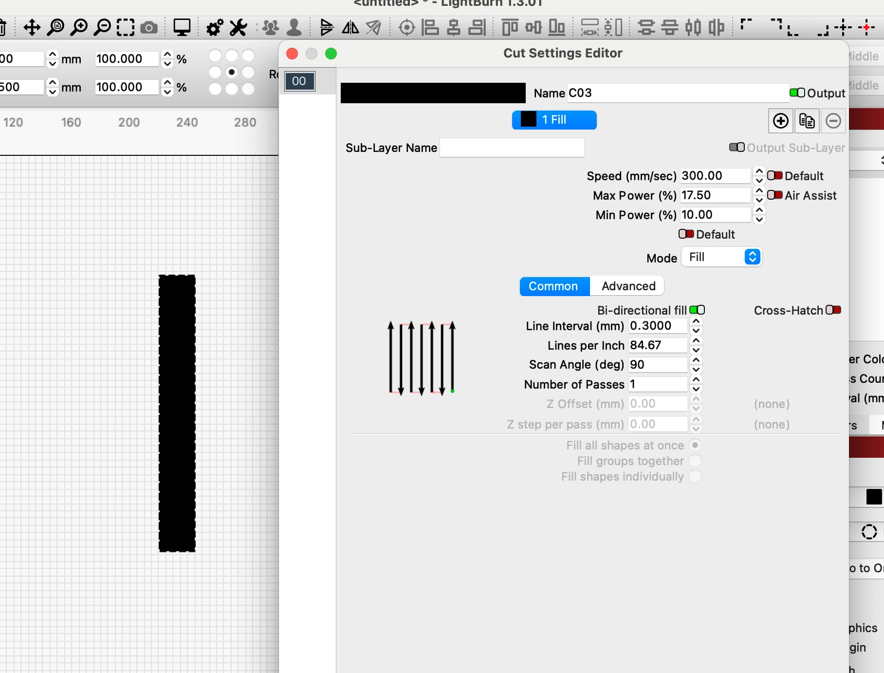

Can Lightburn travel vertically when burning as I often find my work is all staggered left to right.
I have the same problem when using LaserGRBL but can overcome the issue by burning Vertically.
desperate to get this going properly so I can make our FAMILY TREE for wife for Xmas.
Thanks in Advance for any help
I assume you’re referring to a fill operation.
You can change the angle of the scan operation in Cut Settings under “Scan Angle”. Change to 90 degrees if you want to scan vertically. Be aware, though, that for most lasers vertical operations are much slower than horizontal ones due to movement or more mass for gantry based lasers.
