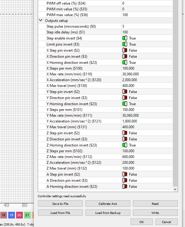

I used my AlgoLaser Delta two days ago and had zero issues. I did the update to 1.7.08 yesterday, and now every job I run gives me “error:9 G-code locked out during alarm or jog state” I’ve gone over everything, so now I’m wondering if I can revert back to the previous version to see if the problem persists.
And by the way, after the past three updates, I’m still getting “Cut may be out of bounds” warning - even though nothing is out of bounds.Oddly, that warning only shows up one time: when I fire up LB and start the first layer/burn. After that, it disappears until I shut the machine off, or start a new job, without fail. That also began after an update, when using the machine the day before without any issues. thanks.
You can download any previous version from the site linked below, however, before you do that, try loading a preferences file from before the update and see if that solves the new issue. File Menu> Preferences> Load Prefs Backup.

Thanks, I had seen others post a link to previous versions, but that didn’t have up to date info, this does. I tried as you suggested: I loaded preferences from about a month ago, ran the job, and I still get the ‘out of bounds’ warning, but I was able to run the entire job without error:9.

As mentioned by @thelmuth above, load an (automatic!) backup of the LightBurn configuration from before the update:
If that doesn’t fix things, report back …
so reading more forum posts found this one
checked my machine settings
it appears mine is the same as the post y max 400000 and i have the extended bed also, have had that for a year
i wonder if the lb v 1.7.8 has reverted device back to standard size bed
looks like that what’s happened
entered $131=850
and boom its working sweet again
The motivation for restoring the backup is to ensure all the settings match what they were earlier, rather than attempt to tweak the settings one-by-one.
If you encounter other problems, restore the backup file made before the update.
