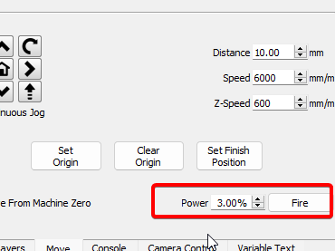

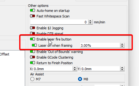

Hello, i have the Atezr l2 24w laser and am having trouble turning on the blue laser guide that shines inside the laser head, to make lining my projects up easier?
Is there a way to turn it on and have it stay on?
Hi Tanner
Couple settings you must toggle on
a) Edit > Device settings
make sure these two settings are on
b) in the move panel - which if you dont have it enabled you can get it by going to Window menu > Move
You can click the fire button and it will fire the laser at the power in the box behind
Also when you frame it will turn laser on
thankyou, I didn’t have those turned on,
