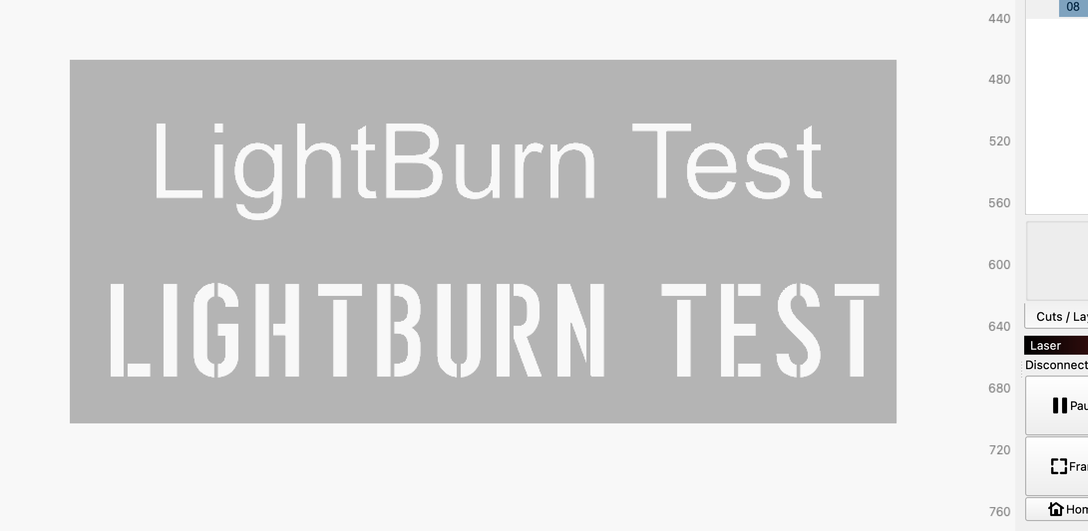

How do I use the offset tool in lightburn so I can cut names from acrylic without it breaking?
If I understand your question correctly, you need to find a font like “Ombudsman Stencil” for example, which ensures that the letters remain intact when cut.
You can also add the bridges manually, but it’s a bit cumbersome.
