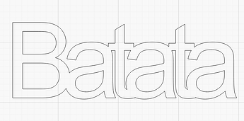

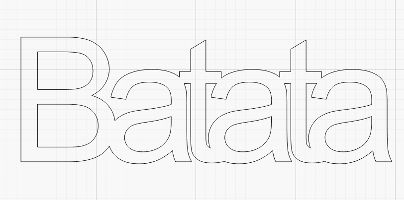

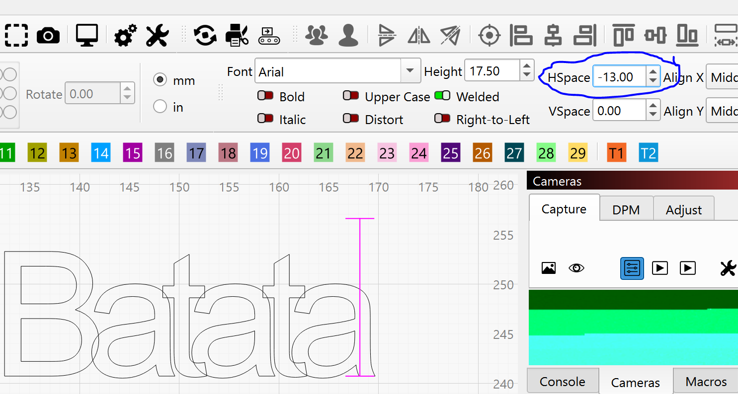

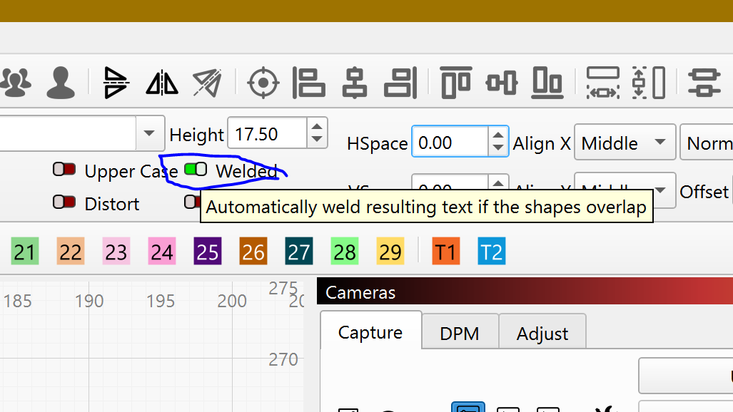

You´ll have to set the text to weld:
And change the Hspace
Then the text becomes “continuous”
The respective doc:
