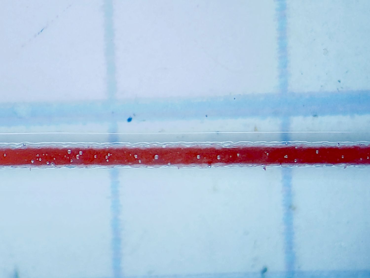

I used it to make a cursor hairline for a reproduction slide rule:
That’s 0.3 mm wide in a sheet of transparent PETG (atop on 0.1 inch grid paper). It’s filled with red enamel paint using the cut through the protective film as a mask.

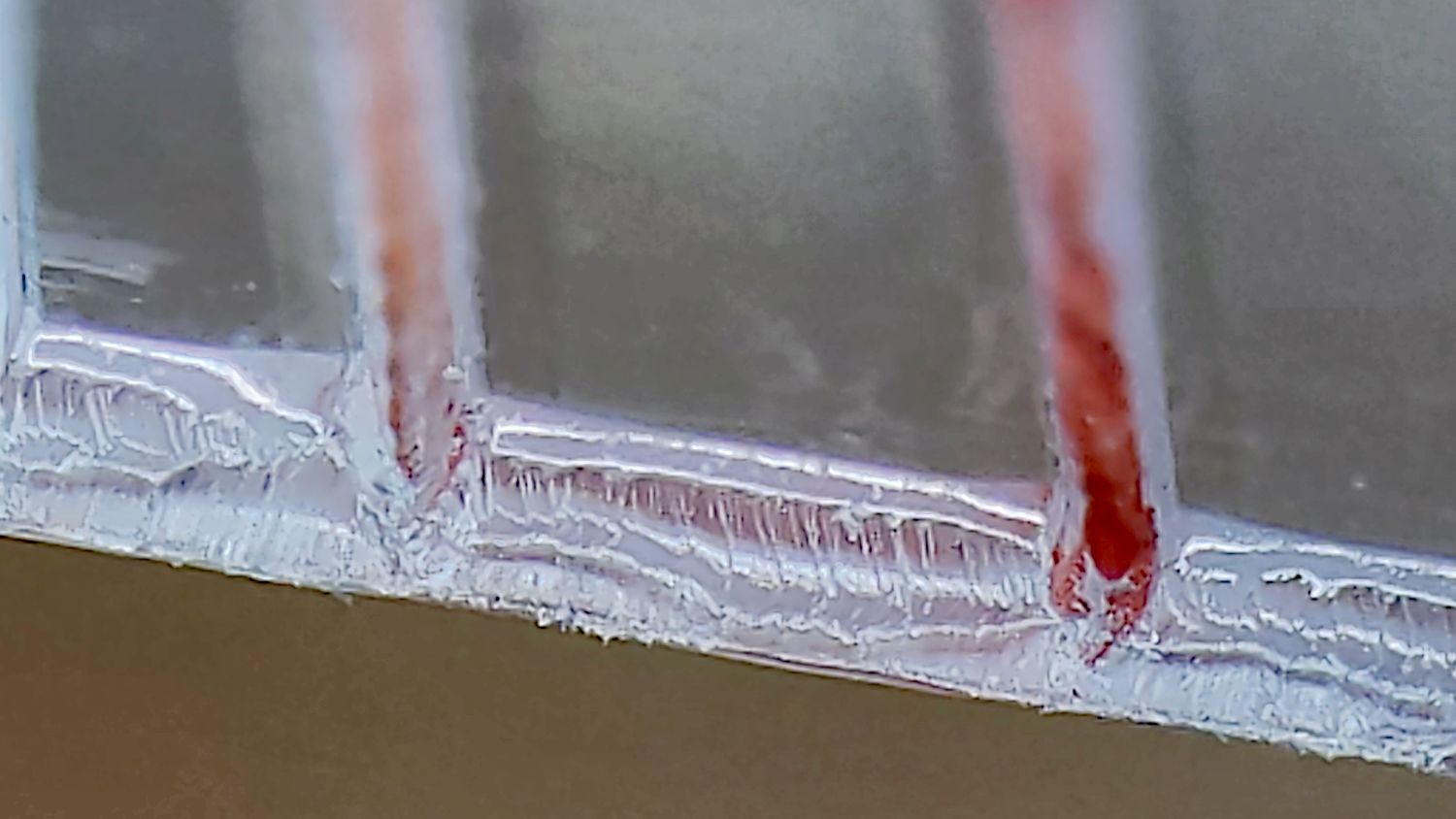

The beam forms a trench:

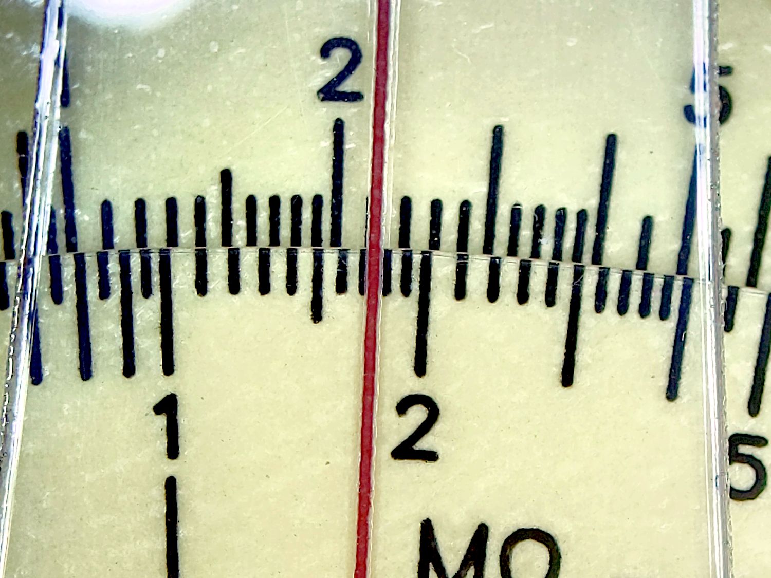

And in my utterly biased opinion, looks great:

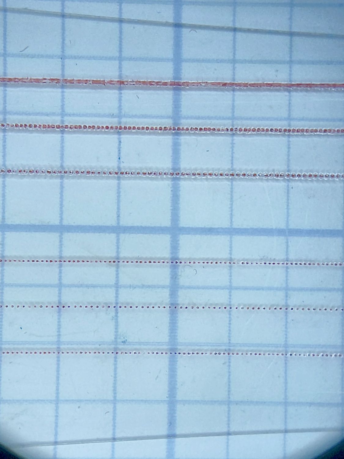

Some preliminary tests explored more variations:
Something like that should work for you, too. :grin:
