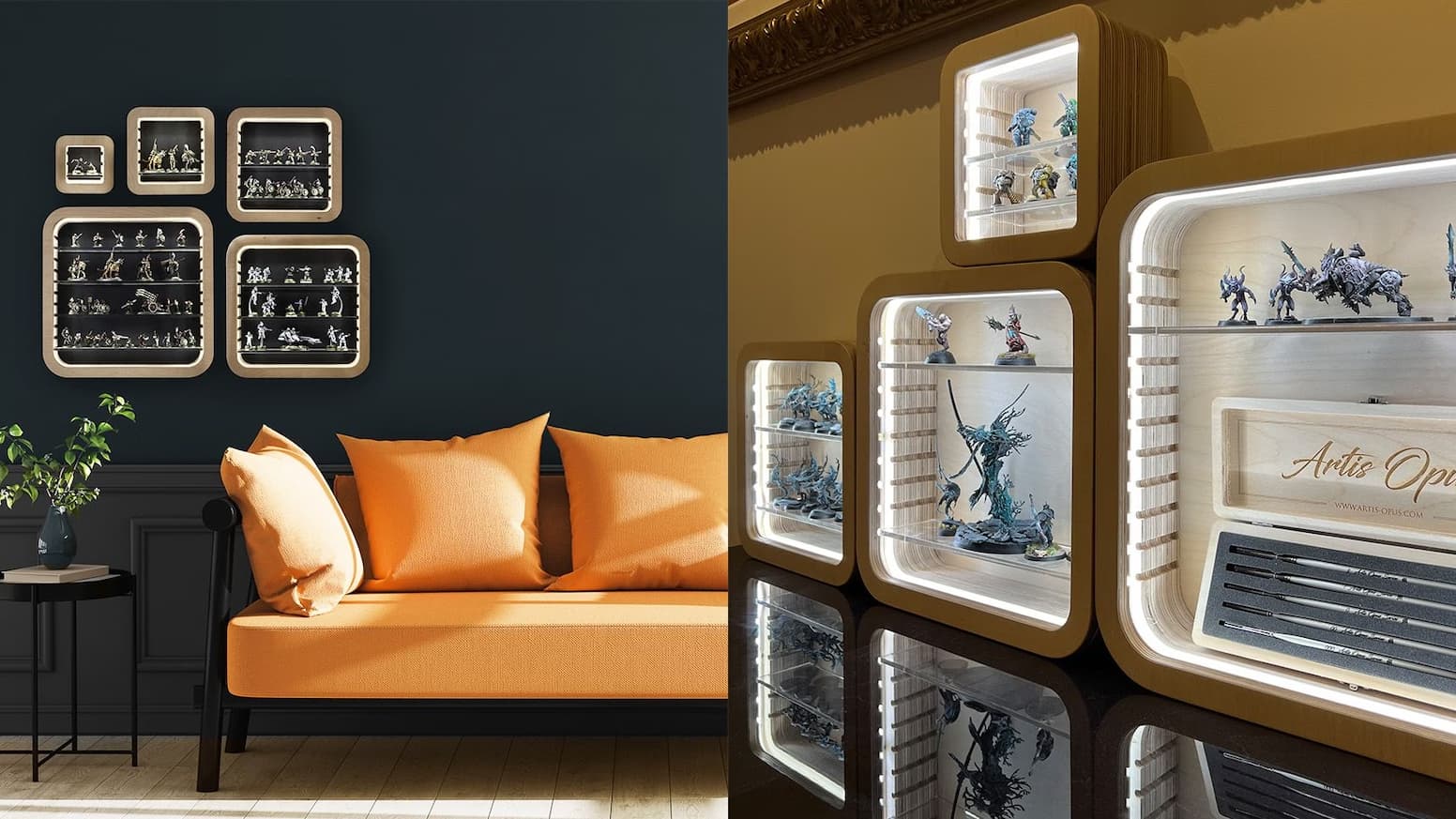

I have air assist and a honeycomb. My front and back are perfectly clean. I am talking about the actual cutting sides, because I want to create something like this:
So I need to sand the sides. White cloth surely does not suffice here, does it?
