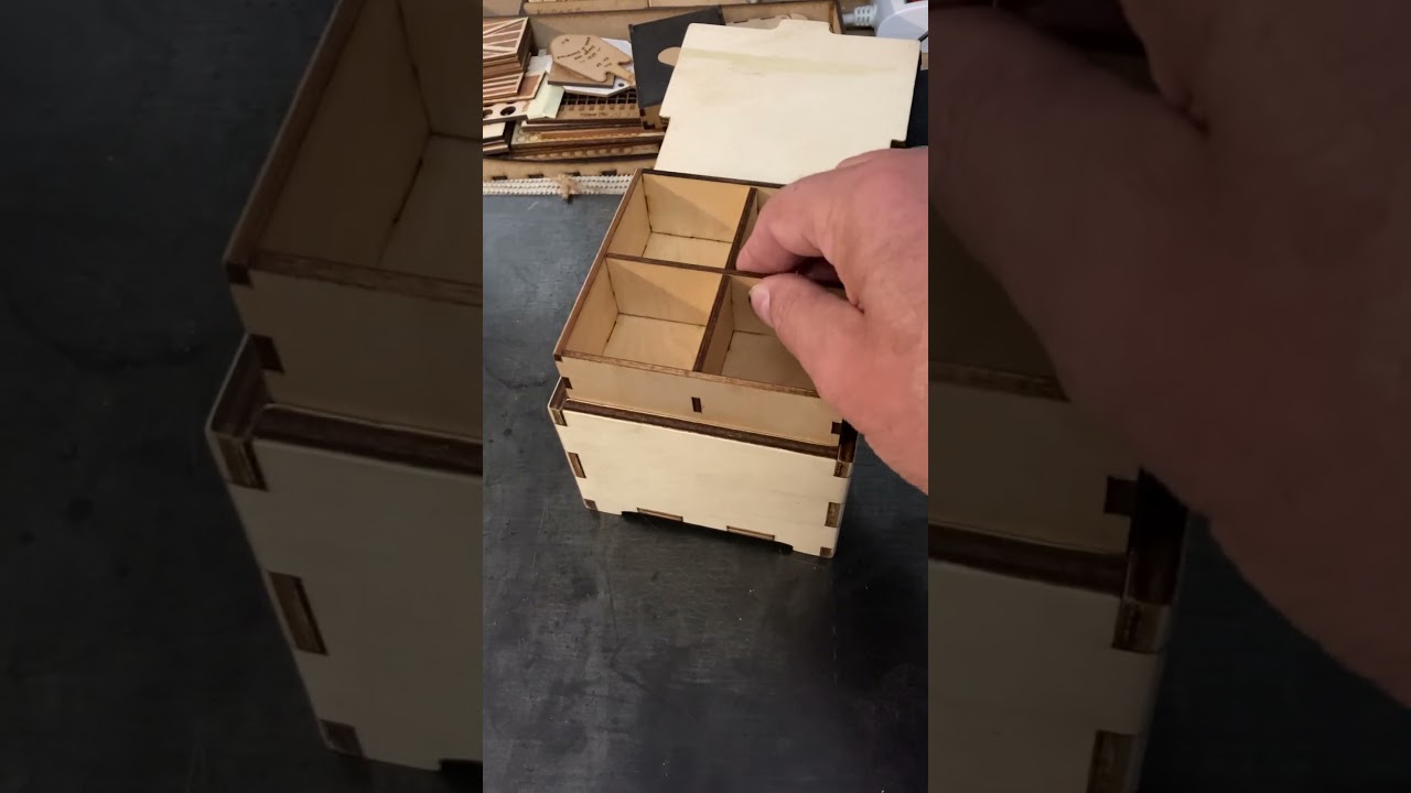

How do you test the squareness of your laser and your work? ;-)

I forgot to mention that everything is of course drawn/constructed in LightBurn. Material is 6mm and 3mm plywood, slightly sanded and wiped with leather grease. Outer dimensions of insert are 99mmx99mm which is exactly 1mm below the inner dimensions of the box itself. My kerf 0.075mm (is a tight fit) and secured with a few drops of superglue - will definitely last much longer than me.
Originally they are meant as a test objects for LightBurn because it “requires” many of the important functions of LB to construct them, but the little boxes became quite popular here, …especially around Christmas time :wink:
super nice video :slight_smile: I struggle with my acrylic picture cases getting the sides to line up with each sheet
of acrylic I cut :slight_smile: that extra .5mm adds up

There must be a magnet hidden underneath so no one can see it, creating the tight-looking effect. :innocent: :laughing:
Absolutely fantastic, the work and time required to fine-tune the machine so the work turns out like this!

Hi Luis, Thanks but I must admit that I haven’t done anything special to the machine or the cute little box :wink:
If (!) the material reasonably keeps its nominal size, then there is no need for magic or magnets.
But I am happy that this (my) laser has always been precise and well-functioning.
2-4 times a year, depending on the type of material and quantities I produce, I clean and lubricate the moving parts. I am always careful about my mirrors and lens alignment/cleanliness, - no more, no less.
