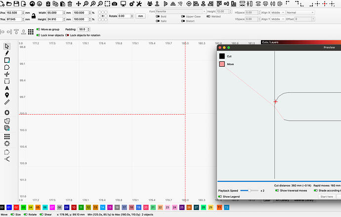

How I got Remove Overlapping Lines to work
Here’s what I did to get the ‘Remove Overlapping Lines’ (ROL) function to work with an array of rectangle.
My kerf offset is 0.1 mm. In creating the array, I set an offset of o.1 mm and set the same value in the ROL distance. Preview then shows it working as intended.
That sounds very interesting, I didn’t think it was possible. I’ll try it soon.
Ps. have you tried it in real life?, does kerfsetting work afterwards as it should?
It doesn’t work here for me and it would also surprise me if it did. :wink:
