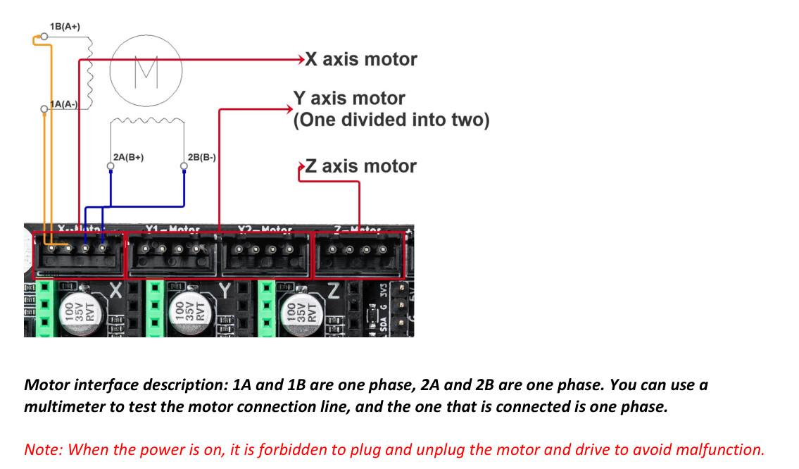

Hi I’m resurrecting my unused K40 and going for a full bed rebuild. I have bought an MKS DLC32 and a couple of TMC2208 drivers. Before I blow something up can anyone tell me if it is ok to plug them in (in the right orientation of course) and also since I have 2 motors on the y axis do I have to tweak the voltage on that one?

Hi
The DLC32 board has one Y axis driver chip and two output sockets. The motors run in opposite directions as required so I assume the board was planned for this type of installation. I cannot find any info for the correct settings in this scenario.
They did infact “divide” the dual Y axis output into two:
You can find the wiring manual here.
If you are running the stock firmware on the controller, the configuration needs to be done by editing the config file on the SD card: Firmware · makerbase-mks/MKS-DLC32 Wiki · GitHub

Yes I checked with a meter and the 2 y outputs are just paralleled, with one output reverse direction. I assume now that I have to up the Vref voltage to accomodate both.
