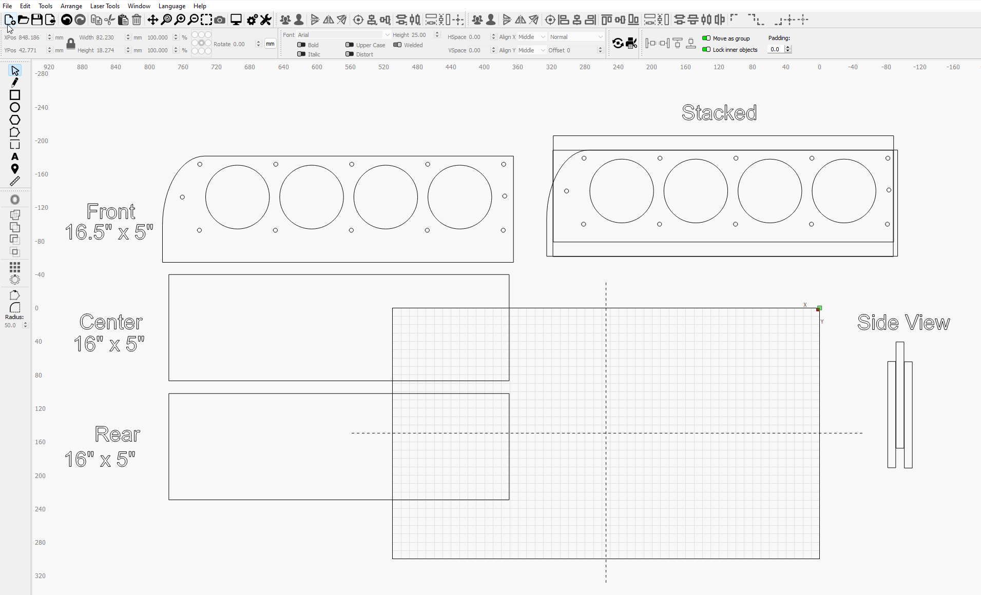

what is the process to align holes to part and through multiple offset layers so that the pieces can be fastened together. Does that make sense? Trying to create something like the picture at the bottom.

Yes through holes. My question is how to line them up the same on each piece?
Looking for best method to create the matching holes in the center and rear piece since they are different sizes and offset from each other
Does your stacked view reflect how you want them actually aligned?
If so then do the following:
  1. Duplicate the current hole positions twice
  2. Move away all shapes associated with Front, leaving the duplicated holes
  3. Select Center and one set of duplicated holes, move away
  4. Select Rear and one set of duplicated holes, move away
Note that you may want to group the holes on the Center piece before duplicating as to make it easy to handle.
