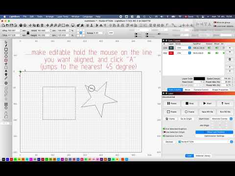

Hello,
often times when I do nesting I have a form, in this case a star, and I want to align it, so that it is “standing straight”.
Or there is one form, here the green one, which I want to align to another form, here the blue one, like that:
Is there a feature like that? It would save me a lot of time.
I know there is nesting software, but it didn’t work so well for me yet, I only tried deepnest.io yet though.
Thank you!
Best wishes,
Fabian
bernd.dk
(Bernd )
October 14, 2024, 10:27am
2
for your first example I will use, make editable, hold the mouse on the line you want horizontal or vertical and click “A” and for the second example I will use “2 point rotation”
PS In order for the star to succeed, a guide line can be drawn first.

Thank you very much Bernd!
That was the perfect answer to my questions

Can you please be more specific?
I have tried to replicate this with a square form and didn’t work…
What I am doing wrong?
thelmuth
(Tim Helmuth)
October 14, 2024, 12:27pm
5
You need to be in node editor for this to work.
Kuth
(Luis Jardim)
October 14, 2024, 12:30pm
6
Ok ok, that’s it!!! It works already!
Thank you very much Tim!!!
