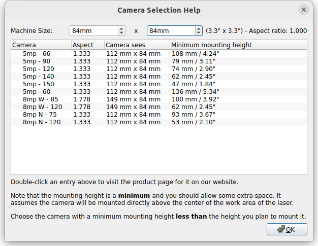

I’d suggest the help → camera selection help as the best guideline.
