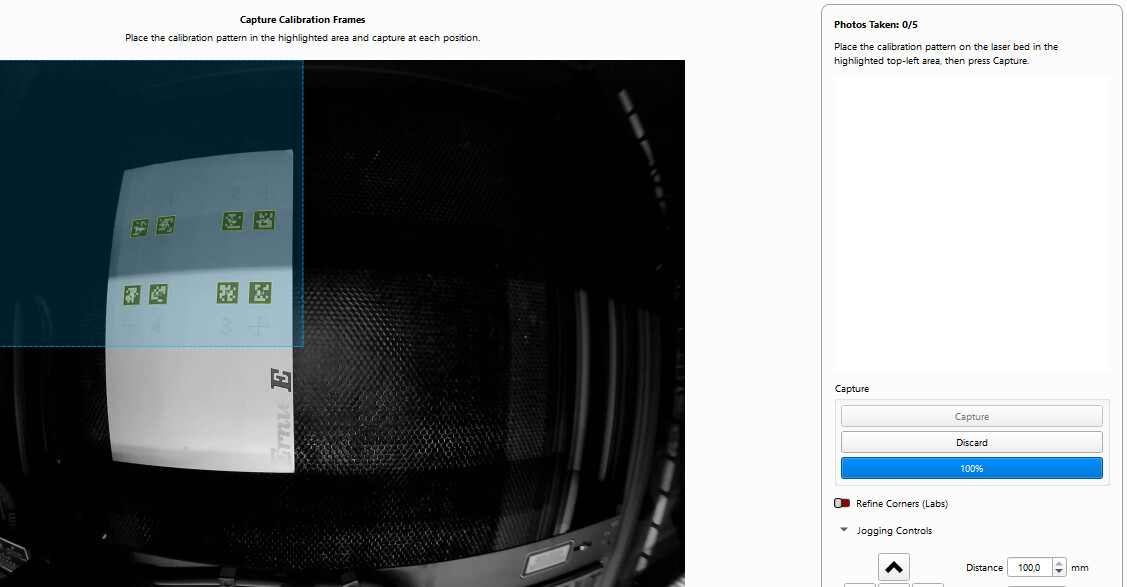

Good day, i tried over and over with success to calibrate my Falcon pro s camera using the new version 2.1.03. I follow the instruction but nothing happens. When i place the test patern, i can see yellow block move and align with the test patern. the percentage move to 100% but i cannot capture the image as the button is not active. please advice
Hi Ernie, It looks like you are using the wrong test pattern for lens calibration, the correct pattern looks like this:
It can be found and downloaded from here: Camera Lens Calibration - LightBurn User Guide
