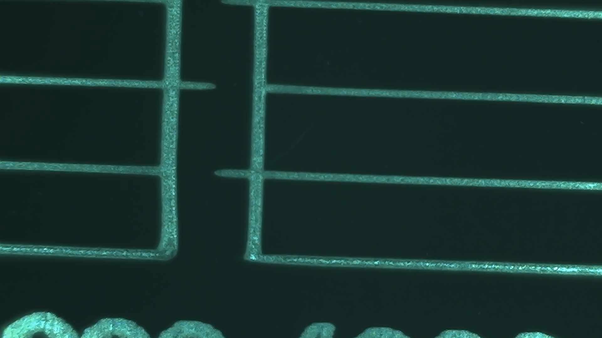

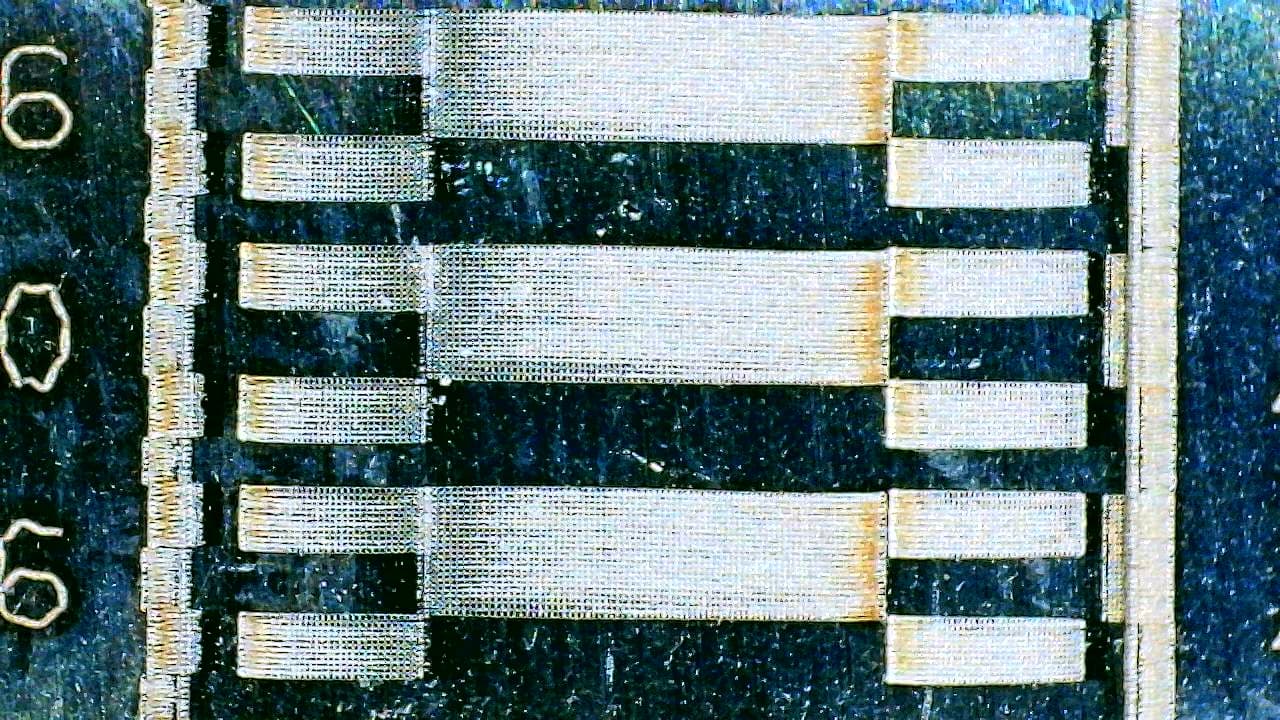

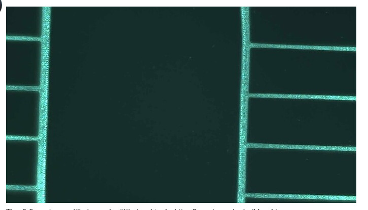

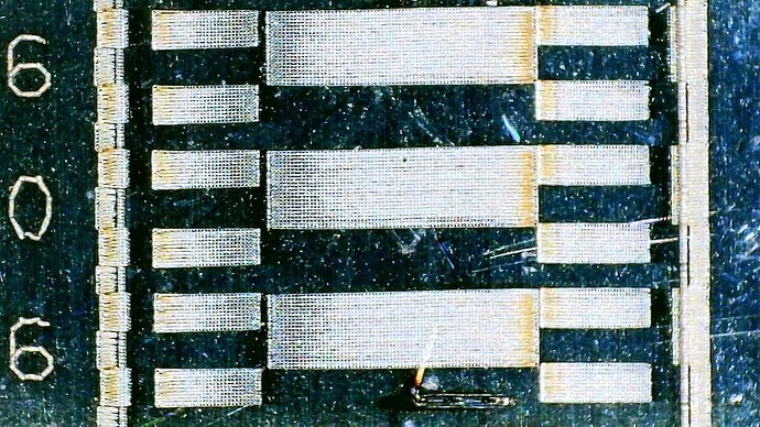

I’m not seeing that. On my 2mm jump test is appears to be maintaining CV while turning off and on. Jump delay does not affect it but TCON/OFF does. Comparing the 2mm jump to the “Back to start>change directions>wait for Jump delay>Start moving>Laser on” and also your tests where you add the sacrificial bar.
Agree

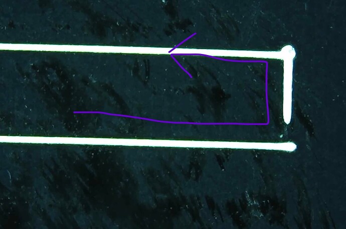

oh but i think you ARE seeing it
look at your OFF gap. see how the end of the raster feature over burns? that’s because it’s braking to a stop there it shouldn’t because there is more raster content on that line to do . i specifically included those bars on the left and right to give it content ahead of and after the calibration dash
you could make that overburn go away by reducing toff. but if toff is zero, then it has no wait after the end of the vector before jumping so you don’t see much overburn. i think there’s still a small drop in speed just because it stops as it processes the next vector.
they do still have function. if you zero out ton toff to keep the raster line running smoother, then the start of the raster line will be wobbly. that will happen in the margin bars and settle before scanning through the calibration dash
it looks like the best way to work around LB’s flawed raster method is to zero out ton toff and set jump speed the same as the raster speed to try to keep it CV. But the start points may be wobbly, and this does cause additional quality issues on vectors if that timing is used on a vector layer.
My Bad, sort of. Still don’t think in a straight line with a gap Jump delay stops the mirrors, it just delays the laser from firing.

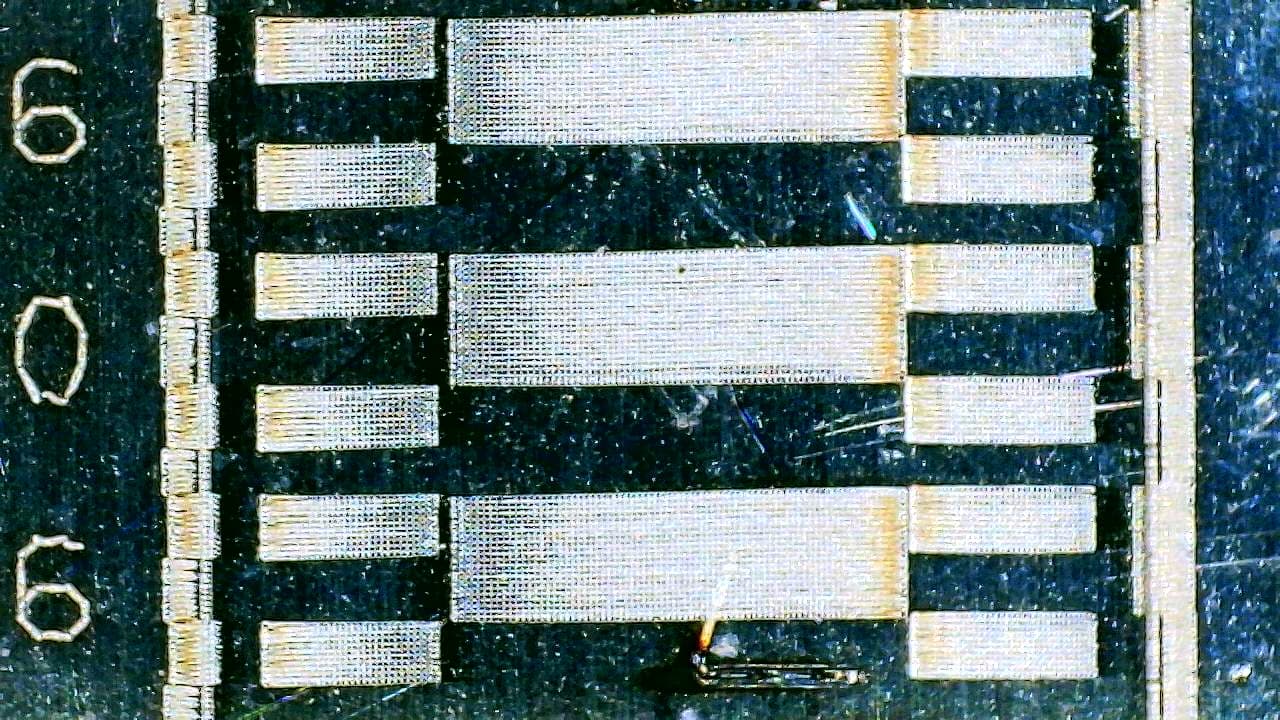

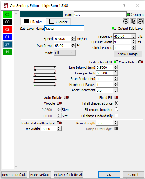

3 tests, one with 4000-500-750-2 and one with 4000-0-0-0 and one 2000-000 both bidirectional

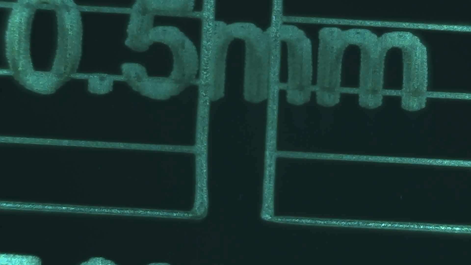

0.5mm jump at 5K mm/s 4000-500-750-2

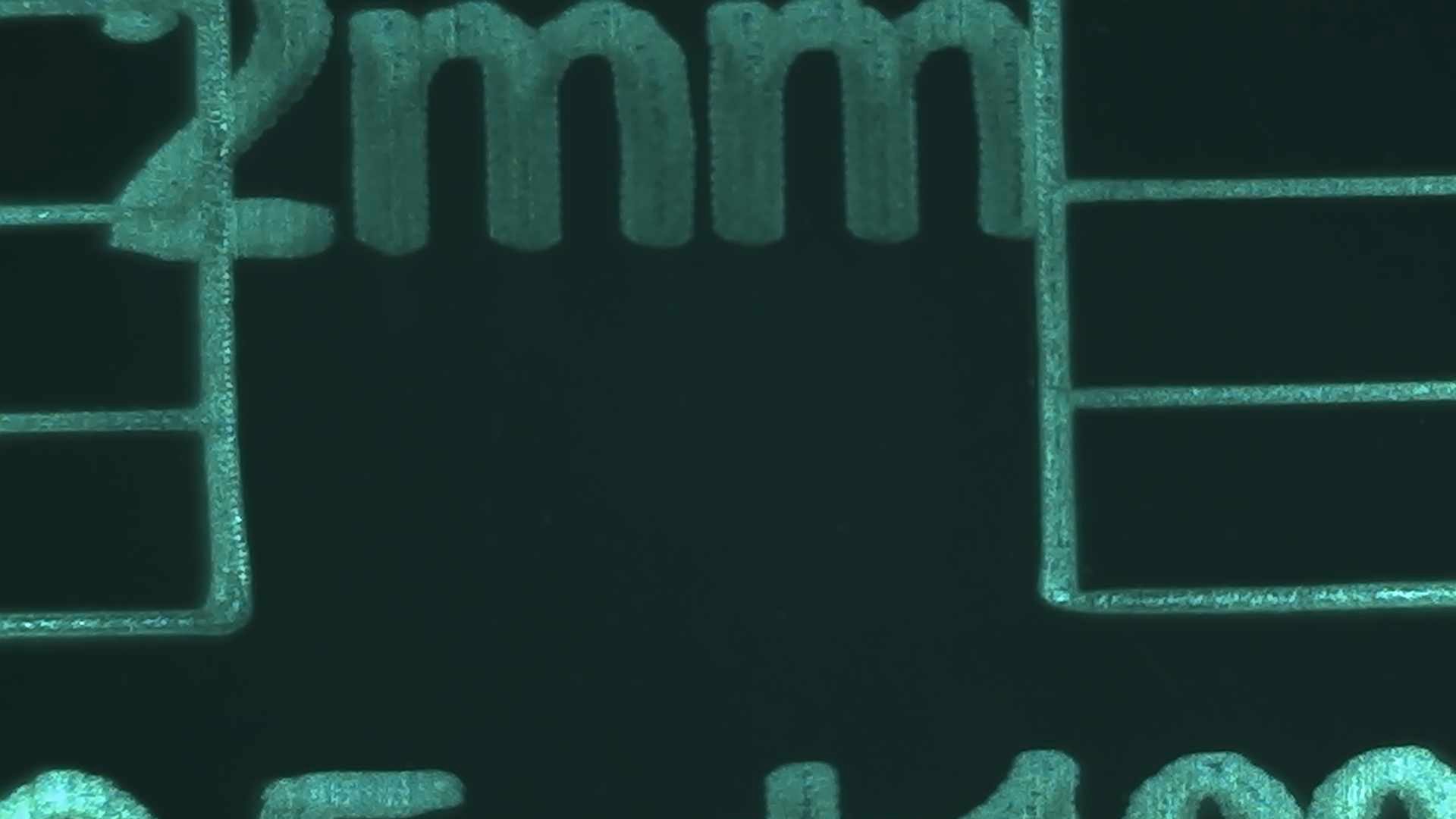

2mm jump at 5Kmm/s 4000-500-750-2
0.5mm jump at 5Kmm/s 4000-0-0-0
2mm jump at 4000-0-0-0

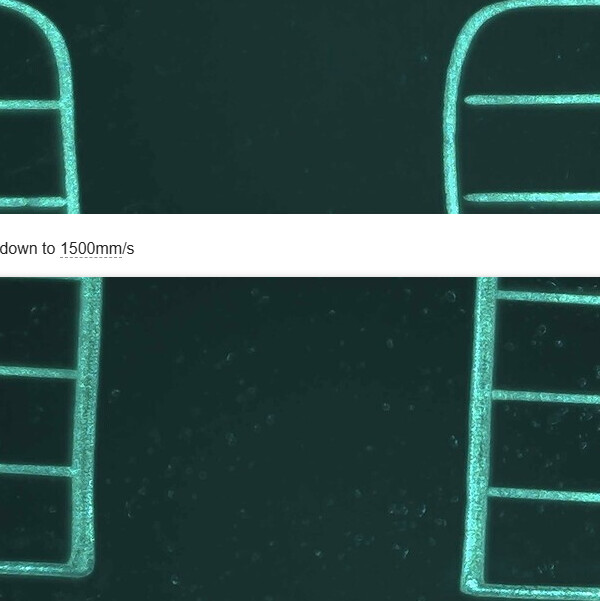

It appears the 0.5mm jump the fill started sooner then the 2mm jump which would say the mirrors decelerated to 4000mm/s during the 2mm, but didn’t decelerate as much at 0.5mm
So slowed the jump speed down to 2000
The 0.5mm jump still showed a little lead in, but the 2mm jump lost all lead in.
Suggests what?
The mirrors don’t stop, they coast? They have the ability to decelerate from 5000mm/s down to 2000mm/s in 2mm, but they can’t seem to decelerate from 5000mm/s to 2000mm/s in 0.5mm. ???

EDIT I don’t see burn in with a straight jump.

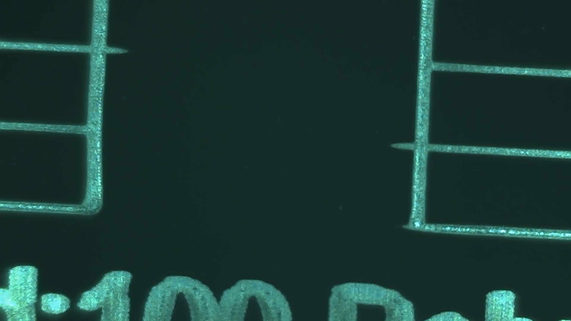

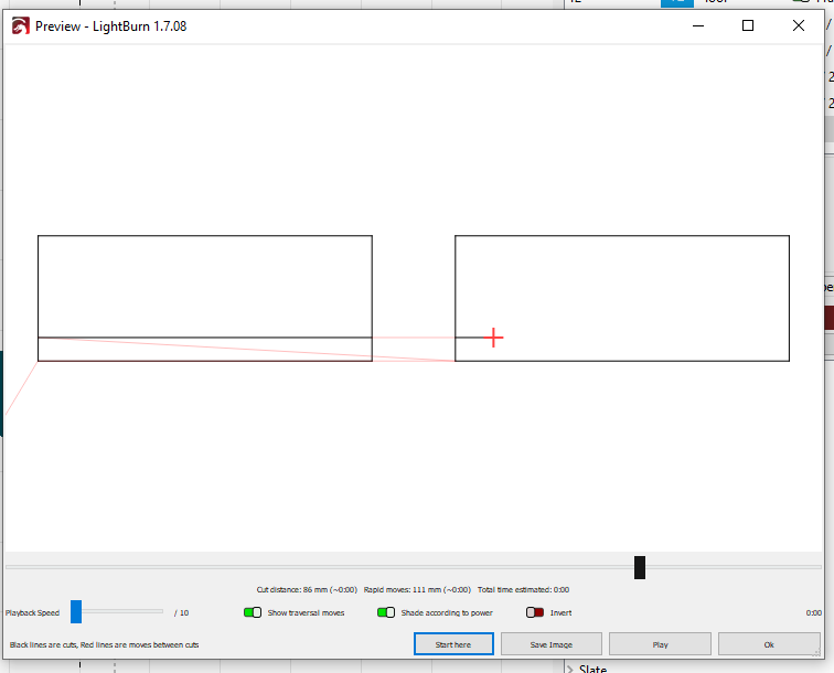

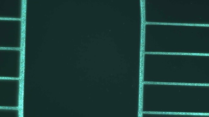

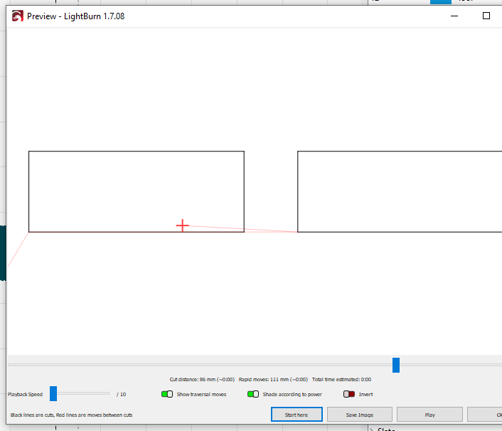

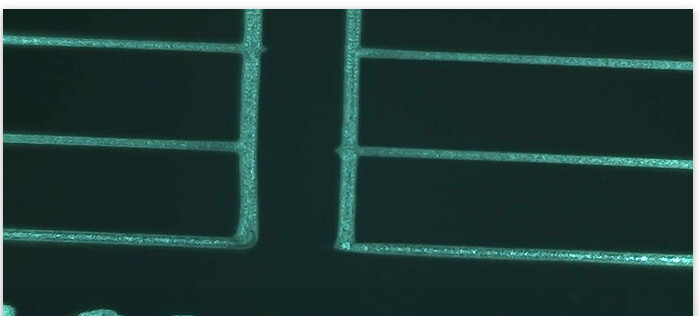

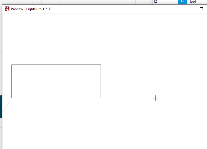

Is there any way to control which way these lines draw? This is one reason I want to test with raster. The Preview window can be stepped through to understand what went from where to where, but it can’t be documented from there- a screenshot would be nearly meaningless.
Like this one:

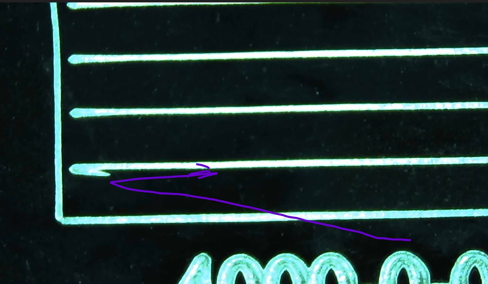

I first ASSUMED these tails are the TCOFF period where it’s jumping to the other segment collinear with it. But it could be the start point, for all I know.

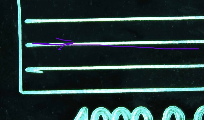

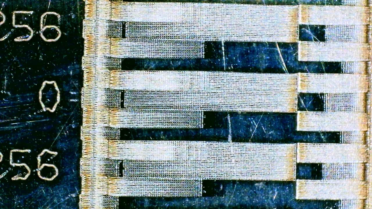

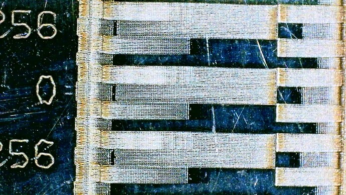

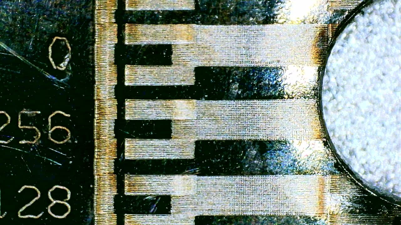

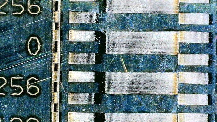

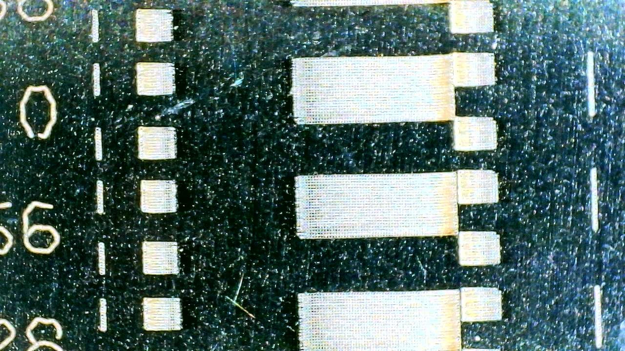

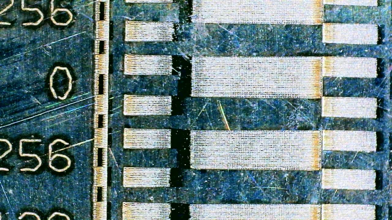

Or, maybe not? The new TCON/OFF tower test gave me this result. START on left, END on right. Again, this is where unidirectional leftgoing and rightgoing rasters meet.
A few notes:
First, the clearest fact here is the on the END gap on the right. There’s overburn there. At the end. So it didn’t coast past the endpoint.
I played with this again. Reducing TOFF delay (which makes it shut off sooner) doesn’t move the line- not at first. it rolls back the overburn. if you roll it back further, the overburn disappears, then the line starts to move.
So it looks like… hmm… theory, it may be coasting past the stop point at cv, but only by a very small amount and that amount is hardcoded into the bjjcz. So if you have it right, the beam OFF happens when it coast past at CV and no overburn. Go further and you get overburn, but the line will only move a little bit before it has the beam waiting at the motion STOP point
If that’s true… oh snap. Doesn’t that mean the beam has coasted past the motion STOP point, so even if we land beam OFF on motion STOP perfectly… if this is finishing “segment 2”, but then there’s only one white pixel then a black (segment 2), the mirror is past the motion START point for segment 2… it’s already overshot! so it will have to reverse itself to get back to the start point for segment 2?
Next point: if I reduce TON delay, the beam ON happens before the motion START point. But it’s not overburn, not when I have JUMP DELAY at 0. There’s just more overlap. So it never waited at the motion START point.

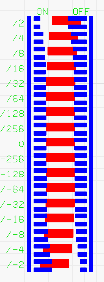

NEW TEST VERSION
I had the corrections twice as big as they were intended. Half the time they will still converge, but half the time it just oscillates. green numbering changed. DELETE THE OLD TEST
Also changed the instructions a bit
tcon_tcoff_test_v04.lbrn2 (1.9 MB)

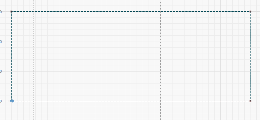

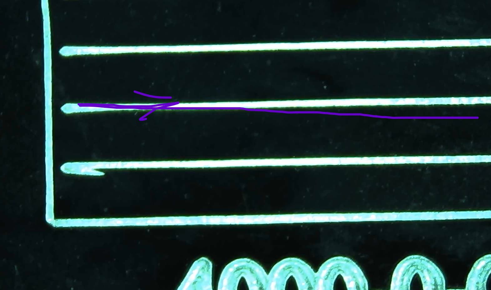

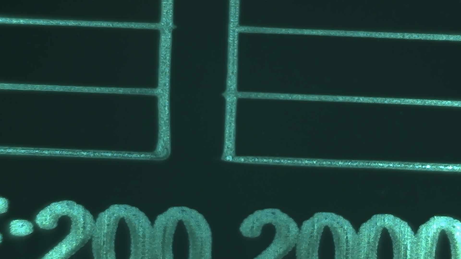

The tails are TCON. It can be shown. The polygon starts bottom left and goes CCW, first fill line up goes left to right. Second fill line up is going right to left. Both rectangles are filled or what you call raster as a group, creating the jump. I just increased the line increment on the fill to 0.5mm to get a better look AND to differentiate overburn from overcrowding affecting the material in a way that mimics overburn.
If you notice the image that was a 2mm Jump:2000 Min:0 Max:0 Dist:0 mirrors had no issue and the laser fired in the correct position with a fill speed of 5000mm/s, but the 0.5mm jump there was still an issue.
I think the tiny jumps are skewing results when I run your test grids. Hardware limit, not software limit.

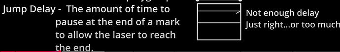

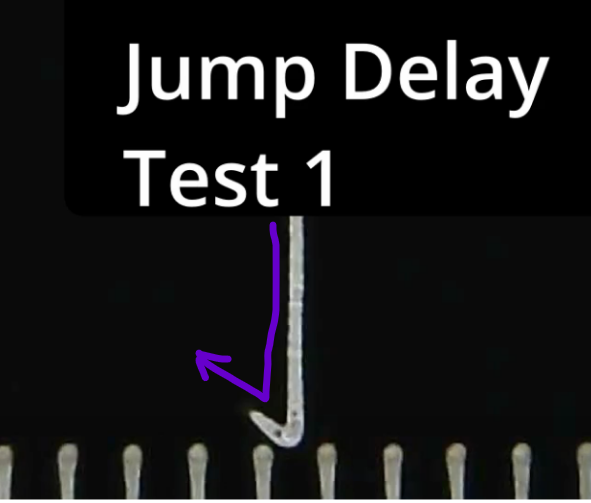

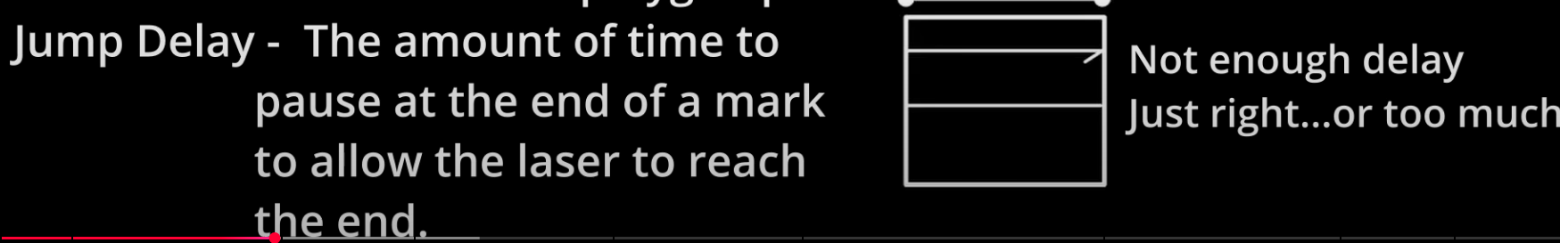

From another video, EZCAD Jump delay.
The amount of time to pause at the end of a mark to allow laser to reach end. That’s not what the definition typically is.

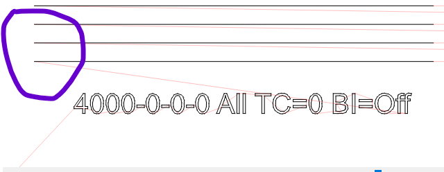

My test 4000-0-0-0
No Bi
All TC=0
So Jump Delay pauses at the start in LB, but at the stop in EZCAD.

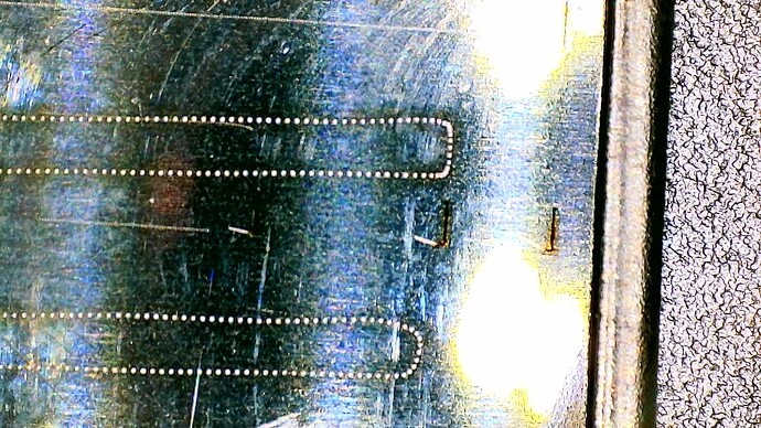

I don’t have the photos I took on this PC. Set TCOFF very high and or TCON very low (negative), high LI (1mm or more) and the beam won’t turn off at all during these short hops.
With POLY_TC at zero, the raster lines don’t corner, they make a loop on the turnaround. Add some POLY_TC and it turns into corners.
On unidirectional or rotation, that will change the manifestation of defects. The endpoint won’t show curvature because it’s coming from a transit reversing at almost 180 deg. POLYGON_TC affects mirror MOTION, the trajectory plan, NOT beam on/off timing from the corner except that the corner point in time happens earlier is POLY_TC is zero.
So zero POLYGON_TC on a unidir would fail to wait for the mirror at the second line’s start point. If it doesn’t affect beam timing, I assume it declares the start point is happening while the mirror is still going to the start point so it could catch a “tail” for the reversal and the reversal point will be short of the correct point because we didn’t wait at the “corner” to stabilize or even reach it
Man, I ran a lot of tests do not see it running by and looping. I don’t want to burn a a lot of server space with 20 more images but POLY did not affect the Bi directional 1mm fill reverse direction. Start and Jump did.

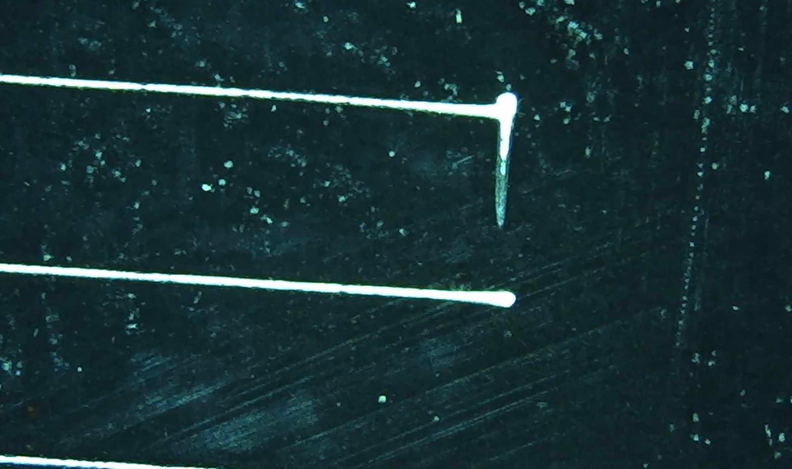

Closest I could get for run by and loop

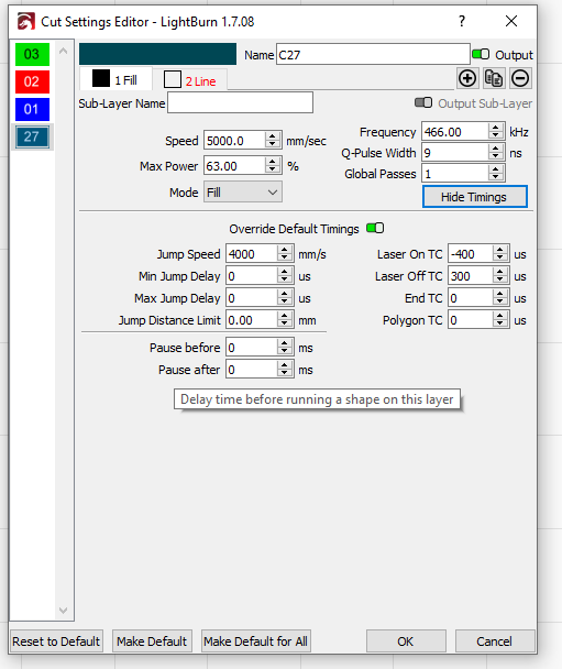

TCOFF shuts laser off Mirror changes direction (UP) TCON turns on way too early (Laser On TC = -400) Mirror makes corner heading -X (R2L) Laser overburns corner while mirror stops and changes direction. Might have looped a little.
Same settings power turned way down and QPulse down from 9 to 1

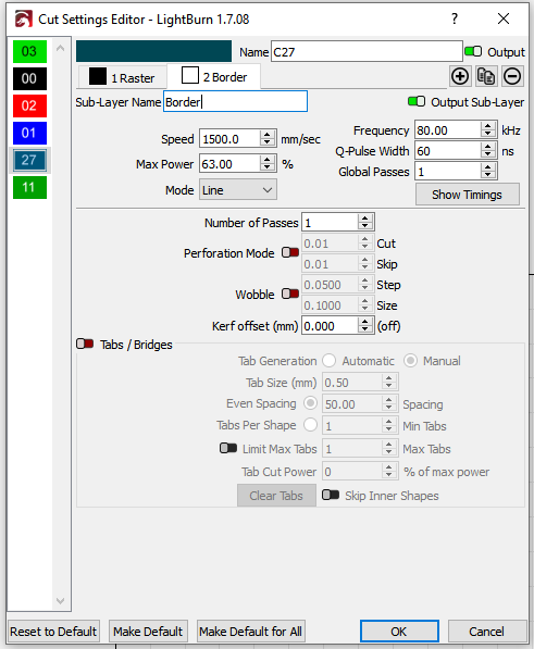

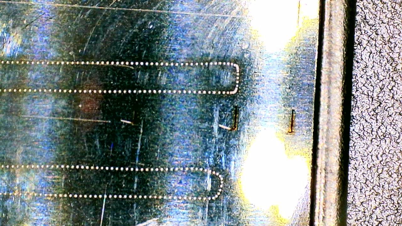

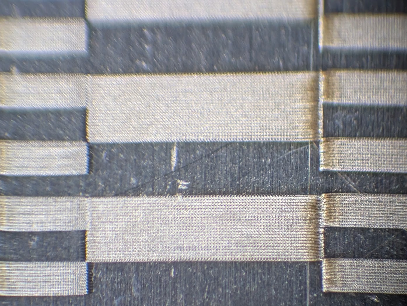

Here’s where I lowered the freq so basically I can measure time by pulses.
This is a bidir Fill with 1mm spacing and only tall enough for two lines.
The top has PolygonTC set, the bottom has it at zero.
Good timing
Add 100 to JumpDelay (none of this is cumulative unless explicitly stated)
I noted that there’s now an area where it appears to have led with some weak energy then the energy met spec. I’m guessing the M7 source isn’t precharged and actually does get the Fire command more in sync with the mirror position, but at least part of StartTc is waiting for the laser to fire for real.
Ton -100 too low
Ton+100
Ton-100, jumpdelay +1000
EndTC+100,PolygonTC+100
