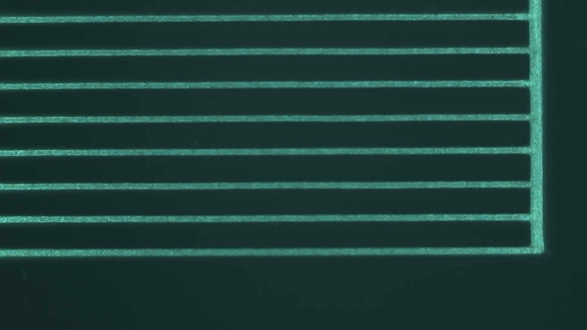

In a raster context, TCON/TCOFF shift where ALL features start and stop, not just the start/stop of the raster line. e.g. if you are rastering a bunch of 1mm dashes with the beam going left to right, increasing TCON will shift all the start points to the right. This narrows the dashes.
Increasing TCOFF shifts the stop points to the right. The dashes get longer.
If you add the same amount to both TCON and TCOFF, the entire raster line will shift to the right without distorting the dash lengths.
TCON/TCOFF is critical for all rasters that use bidir, cross hatch, or rotation. If you increase TCON to reduce the overburn on vectors, simple unidirectional rastering (graphics or fill) won’t look that bad at first, the features are just narrowed a bit by the delayed start every time it encounters something to fire for.
But once you click Bidir, then the left-going line and right-going lines do not line up. If we do a simple horizontal raster on an aligned rectangle, both left and right sides will be jagged. Some may try to fix this by using rotation, which then spreads the timing errors all over the place and it will “smooth” the edge and make it appear blurry, but generally not jagged. This isn’t the right way to do it, it will not be crisp and small features will disappear.
Also, the linear size of that error will be reduced proportionately by rastering slower. This leads to a widespread belief that the rasters are just less accurate at higher speeds, and settle for unnecessarily slow rasters. That’s not the case. The common SG7110 should be pretty accurate all the way up to 7000mm/s. Just FYI, if we go with 0.015mm as the focal spot size, at 7000mm/s is still 2us per spot size. The interesting point is the q-pulse is in nanoseconds, so the q-pulse time of even 500ns is still significantly smaller (1/4th) than a spot, so it can’t “smear” the pixels by taking too long. Also of note, the center of the energy output would only shift over by about 1/8th of a spot if you switched all the way over to a 2ns q-pulse. This explains why timing seems to be unaffected by q-pulse choice.

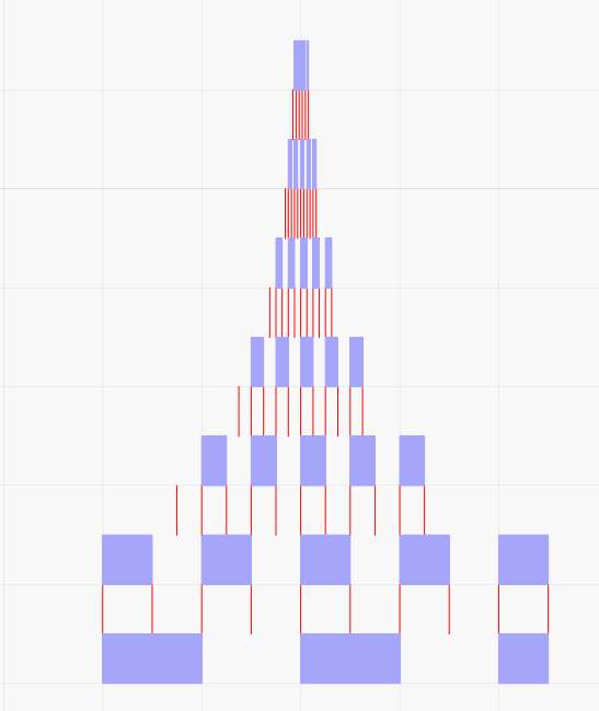

TCON/TCOFF should not be calibrated by vectors, but by raster. What I did hear is create vertical reference vector lines. It won’t matter much what is already in TCON/TCOFF, that would only shift the line’s endpoints up or down, it can’t shift them left/right. You can zero them out before starting if you want, or not.
This test takes only a tiny space, and gives an instant, objective, precise measured answer for the correct TCON/TCOFF.
The raster must by unidirectional (not bidir), oriented horizontally, with no rotation, single pass, standard LI (probably 0.015mm for a 110mmx110mm lens), that does all the shapes at once (not individually). I use left-to-right travel. Higher raster speeds, ~3000mm/s, are best since any TC error will shift the features more measurably. I’d recommend freq=speed/LI although I didn’t follow that here.
We want want to keep the line narrow, so use the shortest q-pulse that makes a mark.
All we’re looking for is the raster rectangles line up with the tick mark- and the correct tick mark in both start and stop point. It’s fairly easy to calculate from speed, the large rectangles and the tick marks are 1mm apart and then halve over and over.

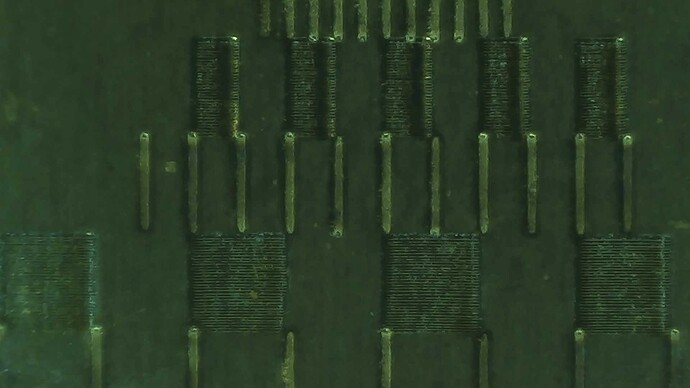

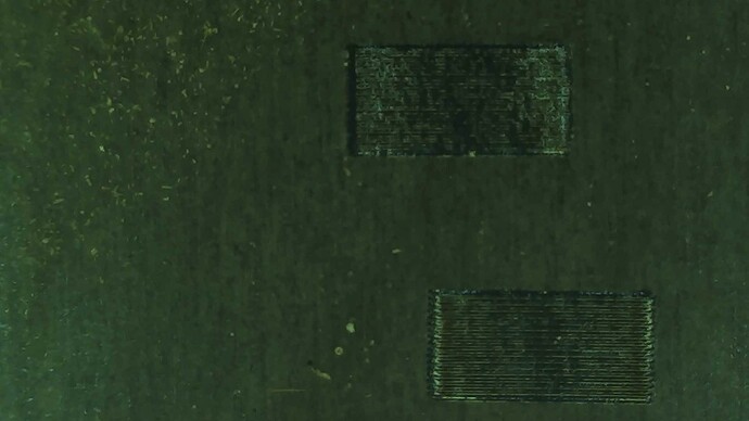

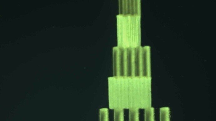

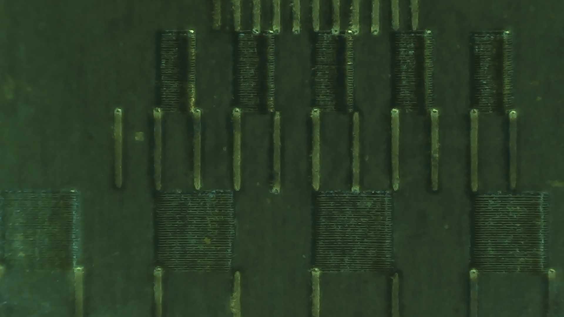

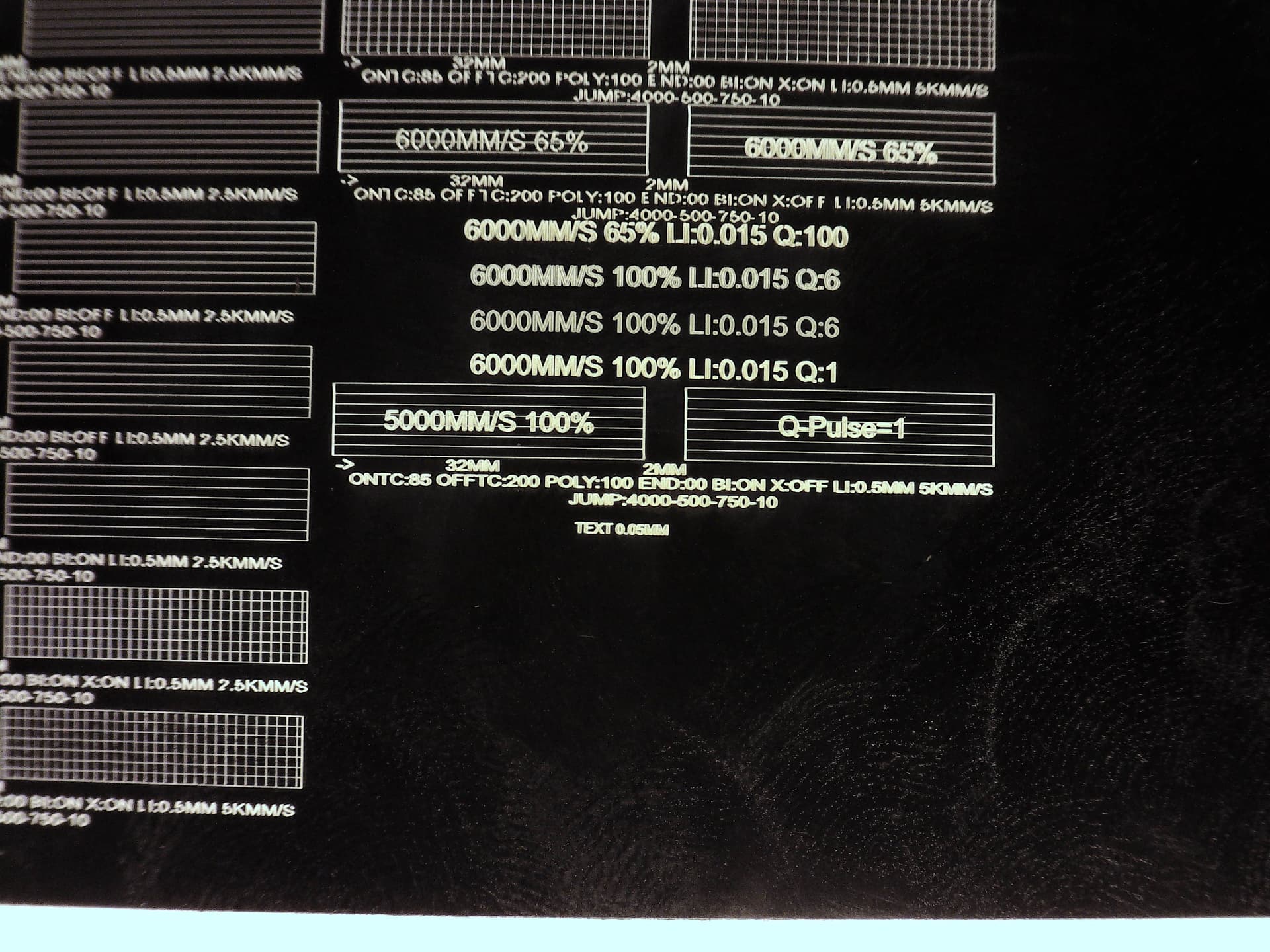

Some images

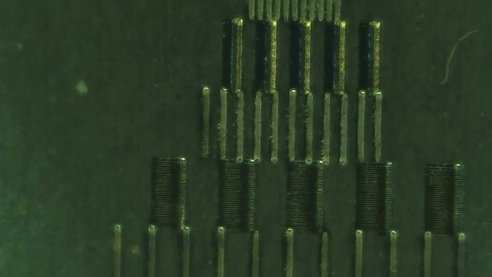

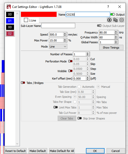

Titanium 110x110 lens 50% power on the fill 15% power on the lines Didn’t change anything else.
Black cheap business cards 20% line 25% fill other settings same as above.

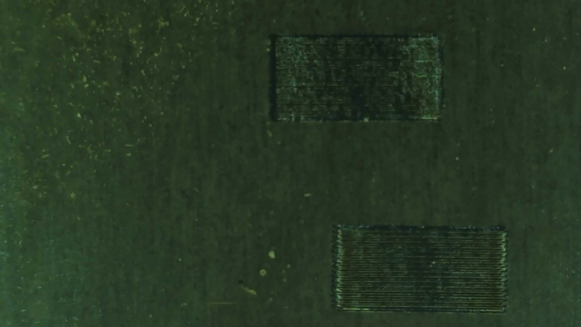

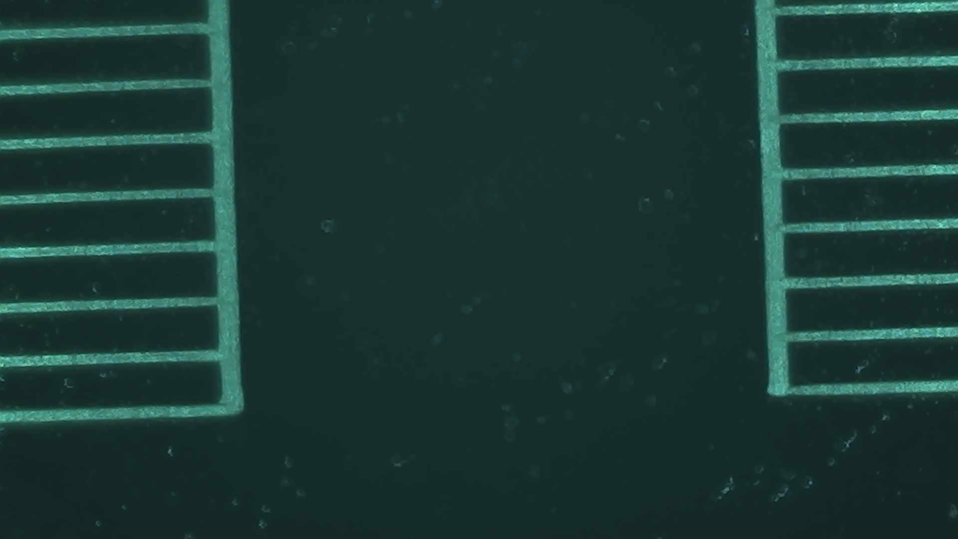

Fill with border Bi off and Fill with border Bi on titanium W=1.0mm H=0.5mm
Vertical scan, Bi off, Bi on

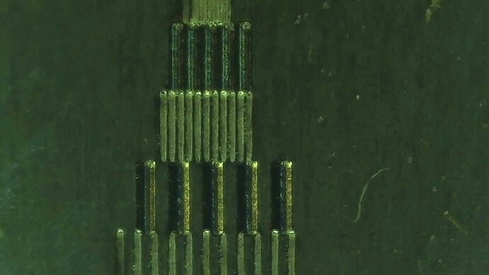

So, @Dannym , what do these results suggest?
Looks like your timing is off in the horizontal scan. But it’s confusing.
I would expect that switching to bidir could expand the boundaries. It shouldn’t be able to reduce it, because the initial one (let’s assume it’s right-going) is still there for half the passes. It might start the left-going passes too early and make a new edge further to the right, and/or might stop too late and thus make a new left edge further out. For every other line.

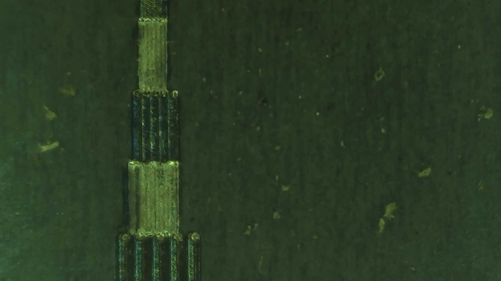

On the pyramid tests looks like the fills are pretty much centered in the tick lines, correct? So per that test my timing looks solid, correct?
So I had a list of questions about the test, big one is your rectangles you refer to “Rasters” The Cuts/ layers settings show a fill of vectors going left to right, 0.015 line interval. So when you say
You are, as far as I can see, still using vectors. Vectors 0.0150 apart, but no difference between those and vectors, say, 1mm apart. Please help me understand.

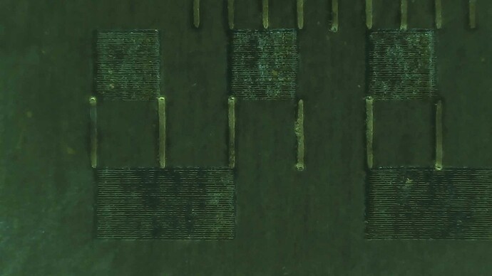

This was a rectangle fill, plus a sublayer line, typical of what we do setting our timing. Using your settings except I increased the LI for clarity and bi=on. Start of the polygon was bottom left moving CCW.

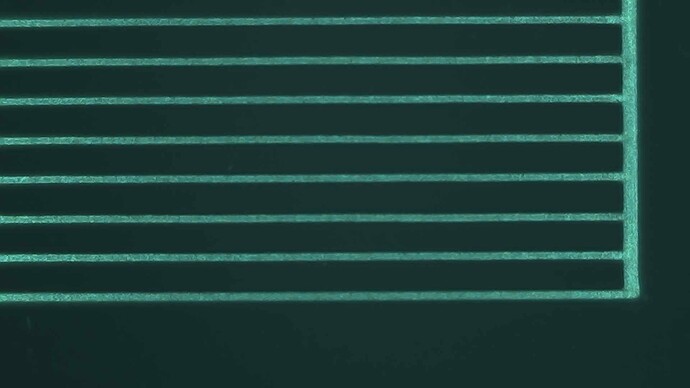

First line up left to right, second line up is stop. Timing on the poly shows too much delay, start looks really nice, stop had too much delay. Similar to the last titanium rectangle above post.
These two rectangles were run at the same time, with a sublayer set to line starting bottom left and moving CCW. Fill starts 1 line up left to right and bi direction =on. I reduced the delays a little for both start and stop.
The start of the polygon vector and the first vector up on the left rectangle Still show a thin start, but after jumping the gap neither one shows the thin start and the stops look good.
So what I’m seeing, and I believe you were getting at with this
I agree that start is turning it on correctly after the jump, but not at the very start. I have run into this before.

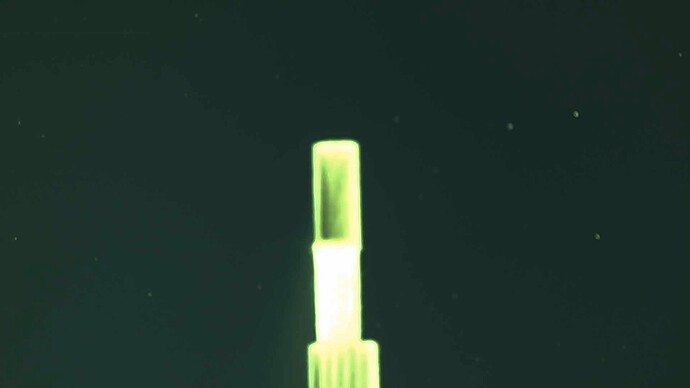

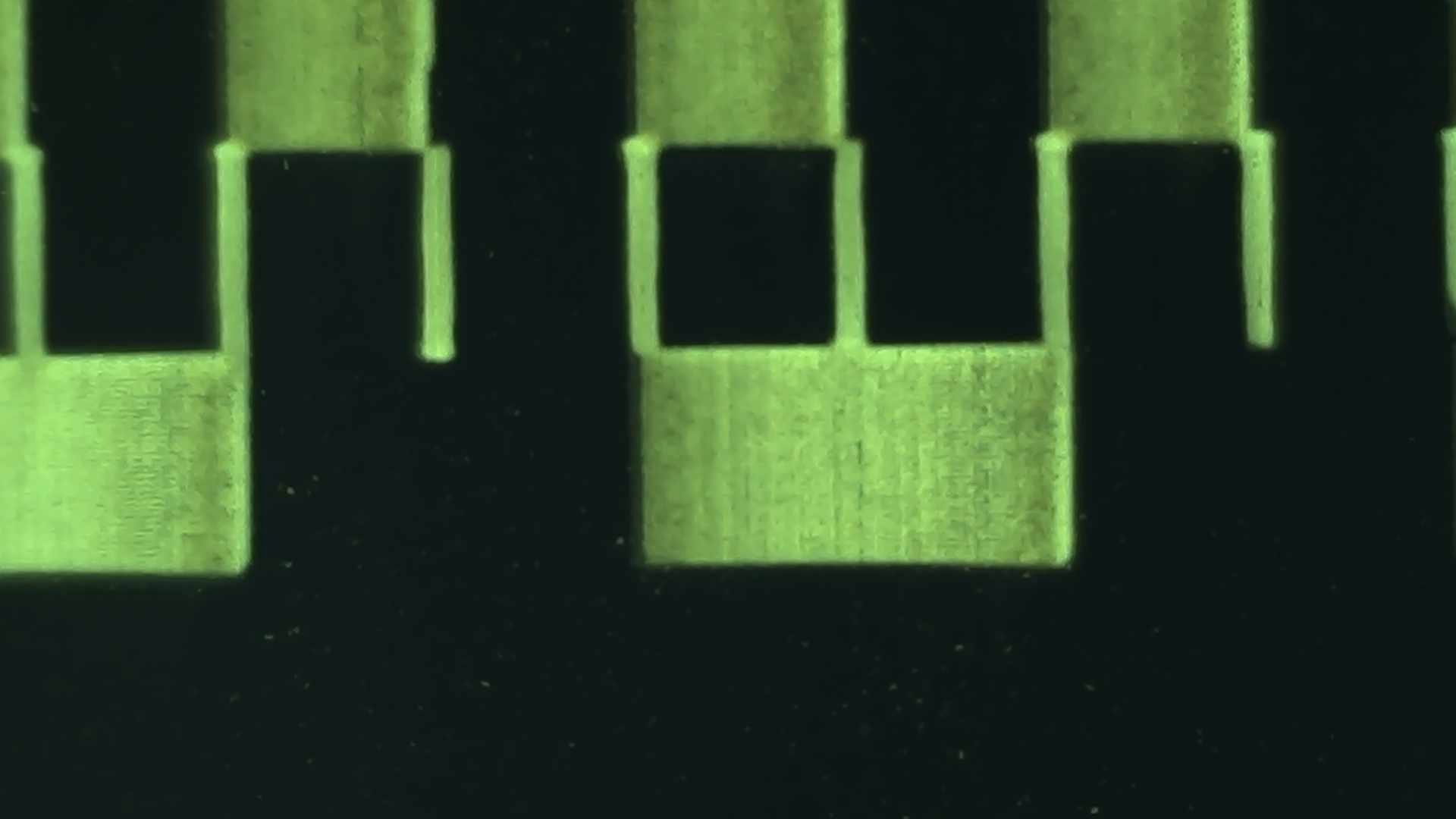

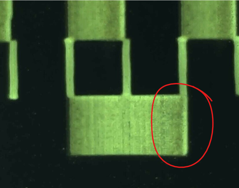

Centered, yes. But it looks like there is some burn-in at the end of the rectangles:
If you shorten the Laser Off TC, it should still be centered.
You should leave Bidirectional off for this test so that it only marks from left to right.

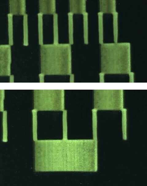

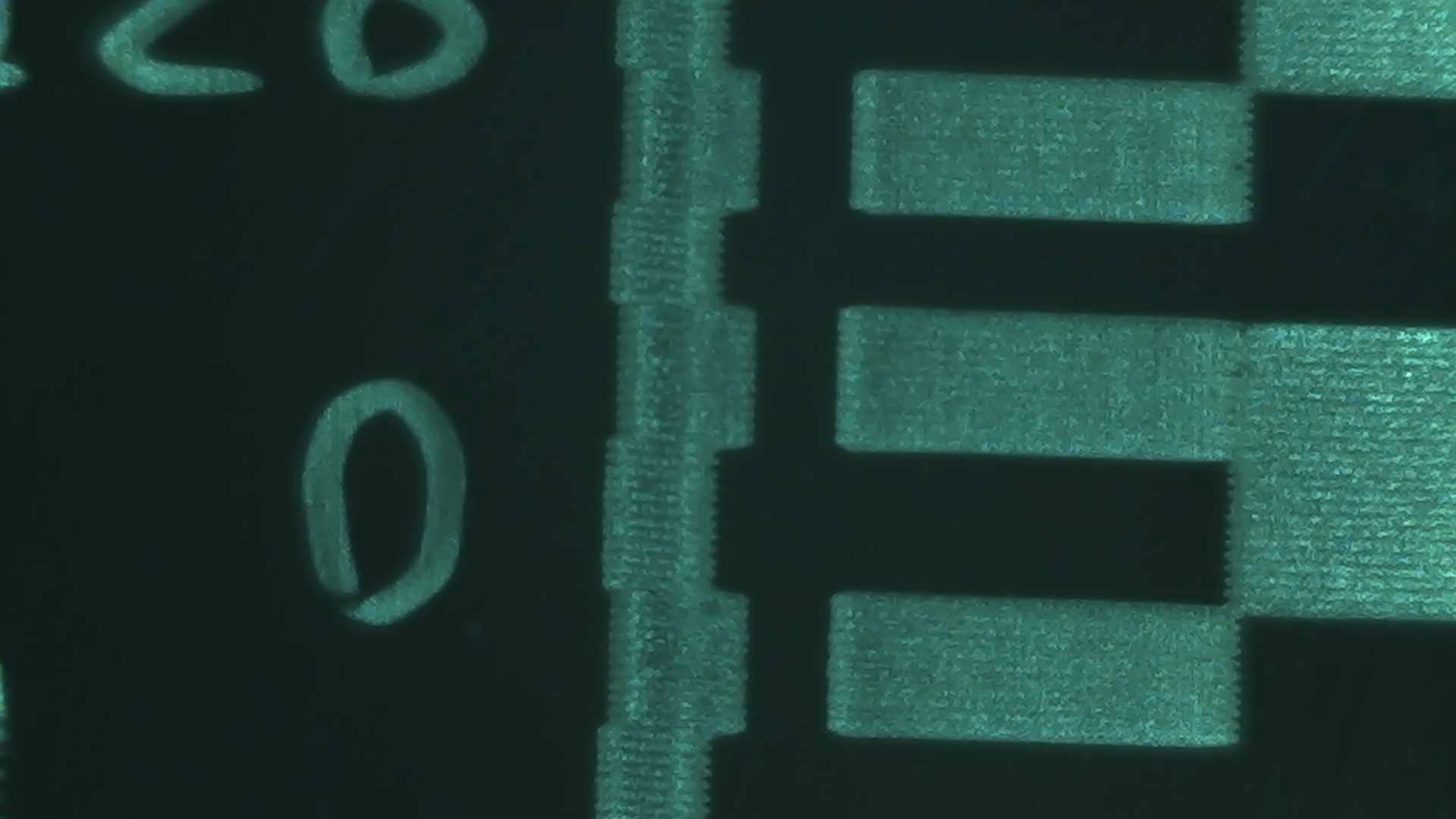

New test:
The red is right-going raster, blue is left-going. So they make an error appear twice as wide. Each row has a calibrated overlap or gap that would make them line up on that row if the overlap or gap is equal to the timing error’s distance.
Left gap is TON, right is TOFF.
You find the row with the closest to no gap or overlap, like this:
Find the row where the left ON gap looks closest, and note the signed row number.
Say TON was 50, SPEED was 7000, and it’s labeled “/-16”
Then use this equation to determine the correction:
(new TON)=(old TON)+(1,000,000/SPEED)/(ROW)
(new TON)=50+(1,000,000/7,000)/(-16)
=50-8.92
=41
The closest row will likely be different for TON and TOFF. Iterate both each time.
If you have reached 0, stop iterating that parameter.
The correction should decrease by at least one row each time, so you should be at the zero row in at most 8 iterations.
If it’s not meeting up on any row, reduce speed by say a factor of 4 on red and blue layers and run to get it “ballpark”

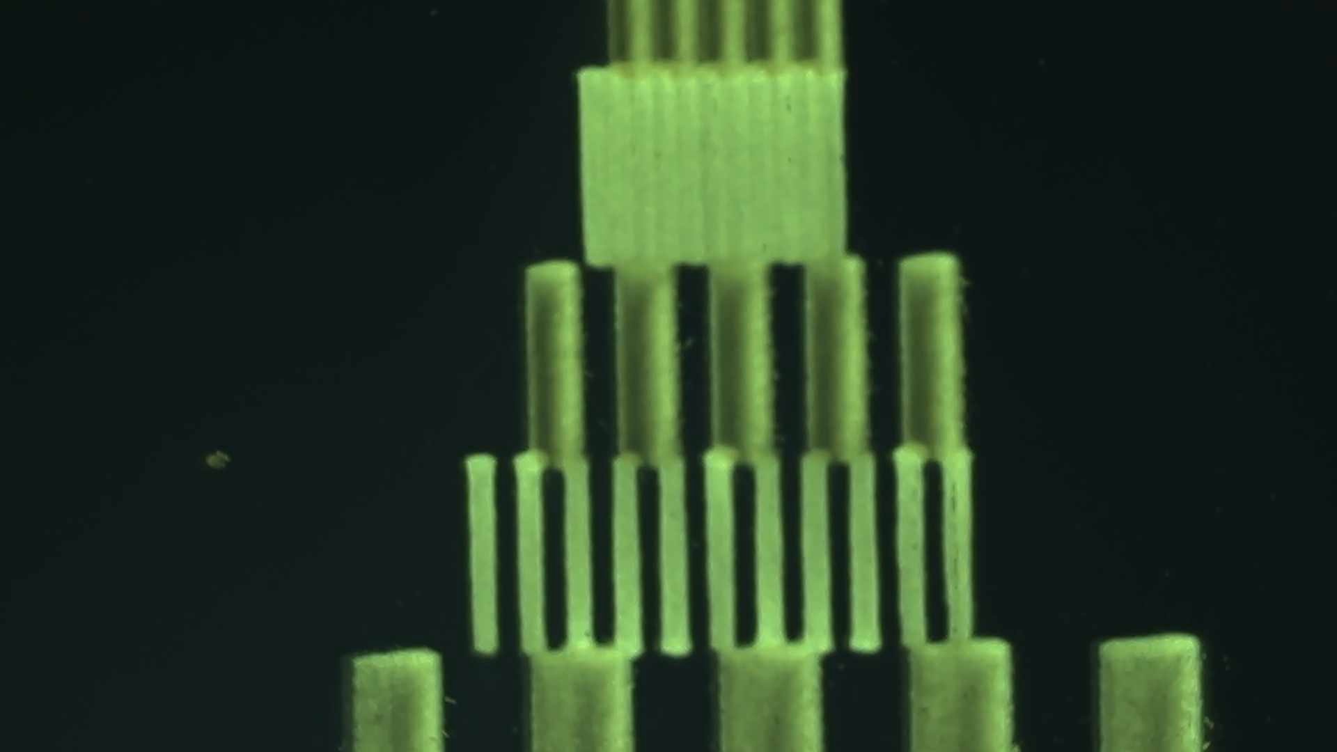

What I’m still fighting is trying to balance:
TCON after a jump, direction change.
TCON after a same direction off-on jump.
TCON starting a poly.
As far as I can tell it is different for each. I split the difference but that aint right. My fills though look better splitting the difference then they did just setting the direction change dead stop TCON.
And… 5000mm/s and bidirectional look good as well. I like the 5000mm/s.

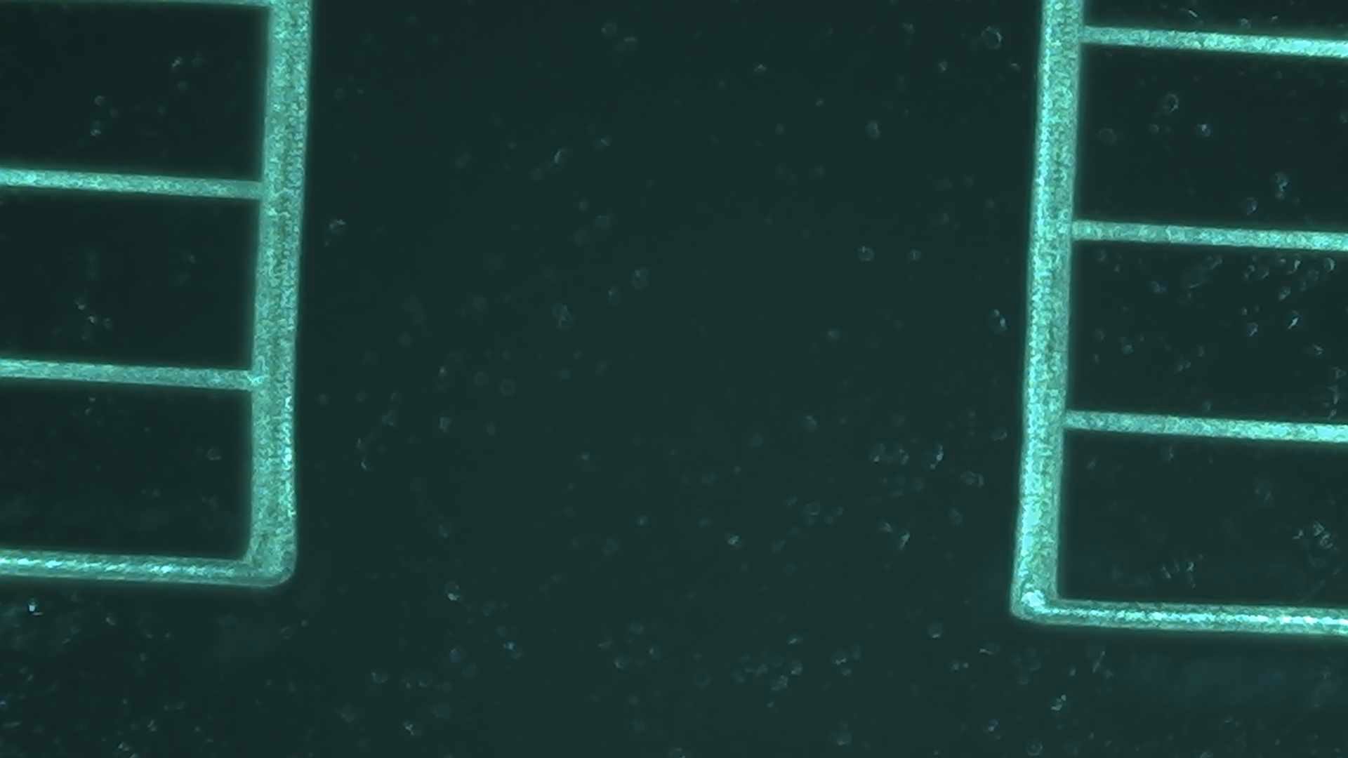

Dead stop TCON and Poly TCON
TCOFF Jump 2mm and TCON
0.75 and 0.5mm high text at 5000 and 6000mm/s bi directional. Not as fast as lines or fills because of all the TCOFF-TCON between the letters but still zippy.

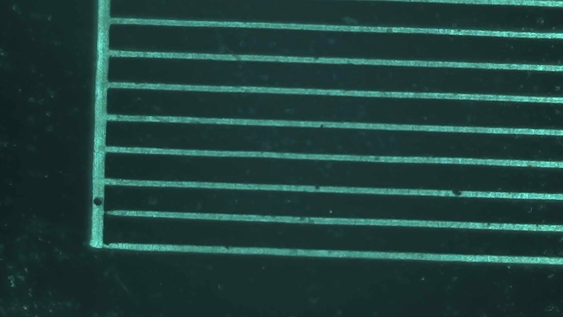

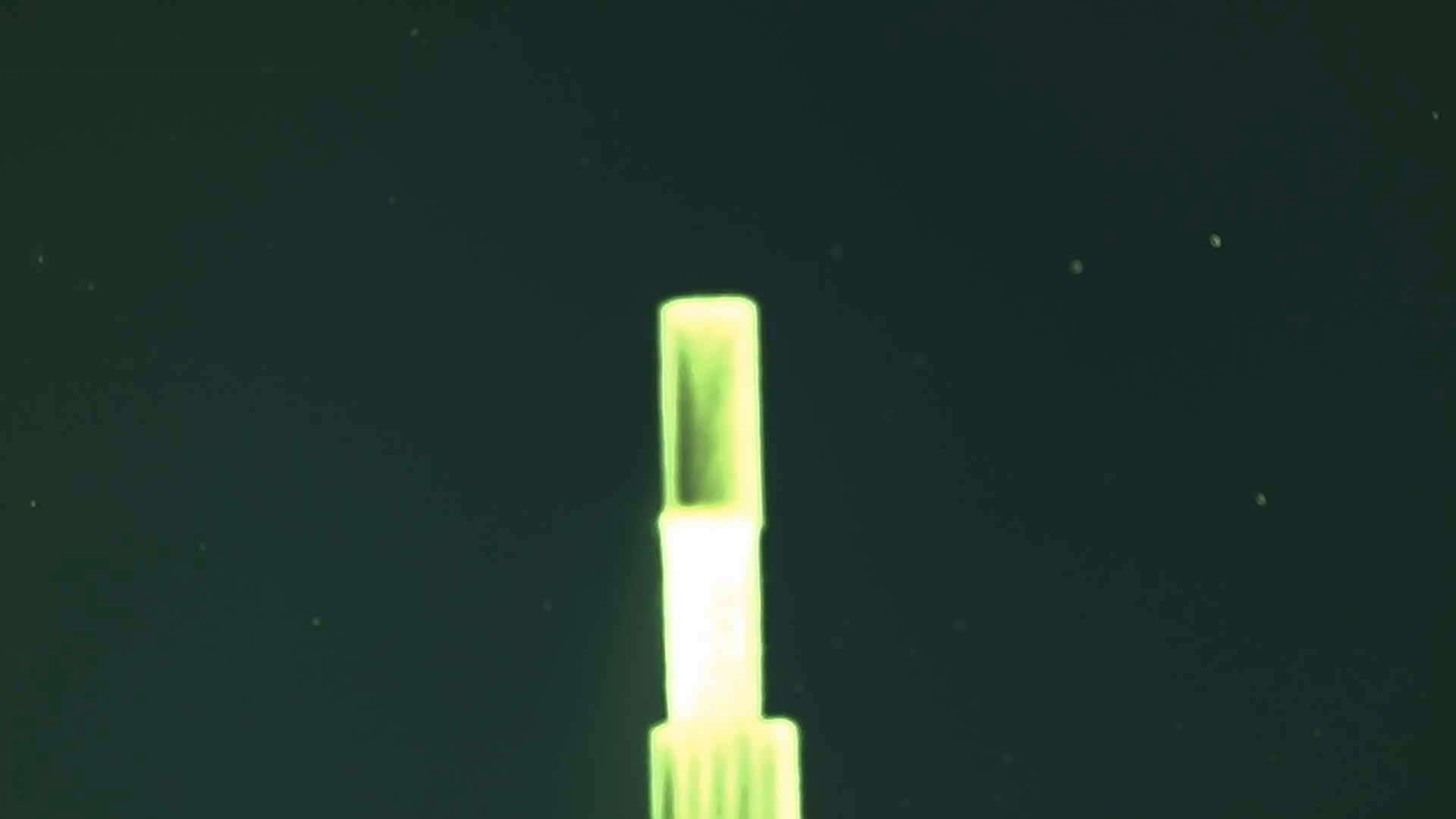

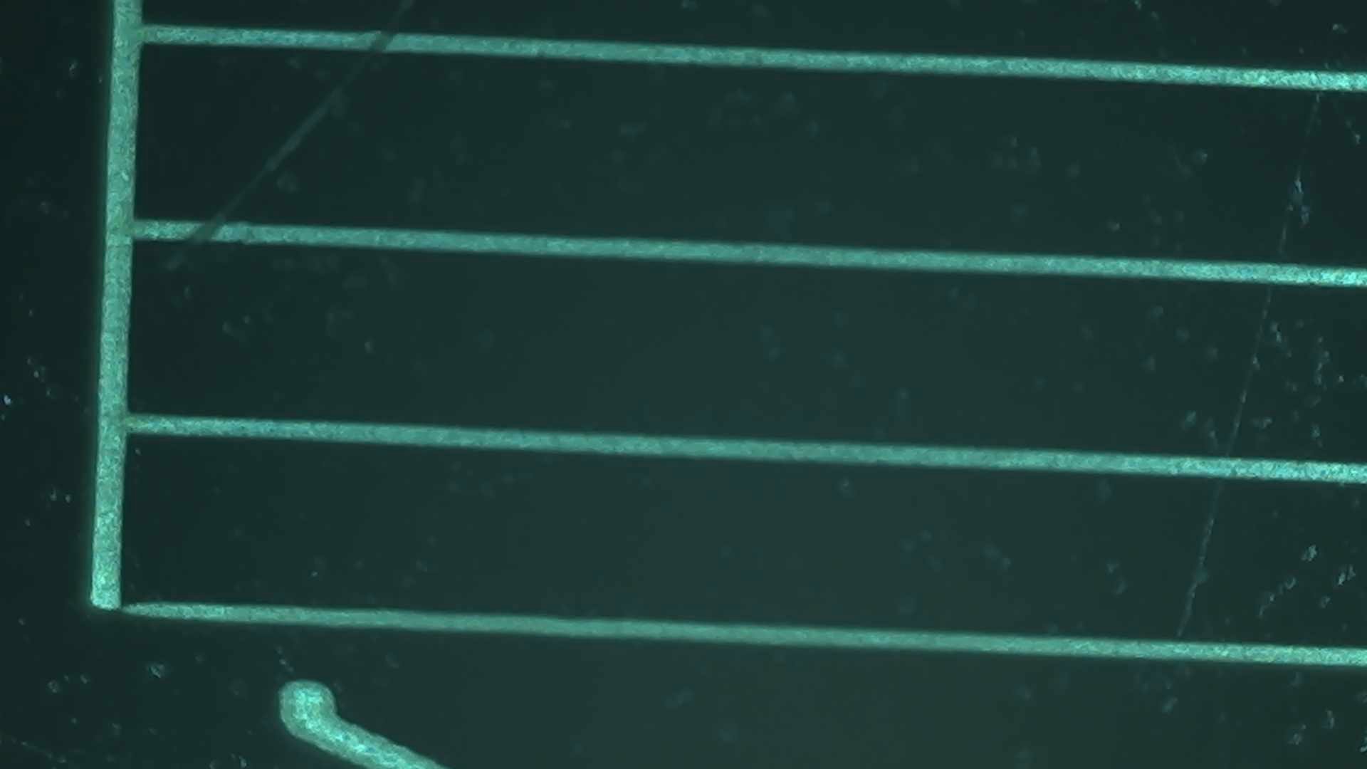

OK, tested a theory and genuinely surprised with the result.
I assumed a raster line would jump from the end of the last line, wait a jump delay, then start and go constant-velocity down the line.
But I’d also noticed rasters run slower each line when there’s more detail.
Nope, it doesn’t do what I thought. A 30ns Q-pulse is the minimum on my machine that marks on stainless when a “lone pulse” (no overlap) and the mark is approx 0.3mm dia. With speed=5000, I lowered the freq to 25KHz so the pulses are 0.2mm apart. I assume the oscillator is going to give the same freq from the first pulse, so the mark spacing indicates velocity.

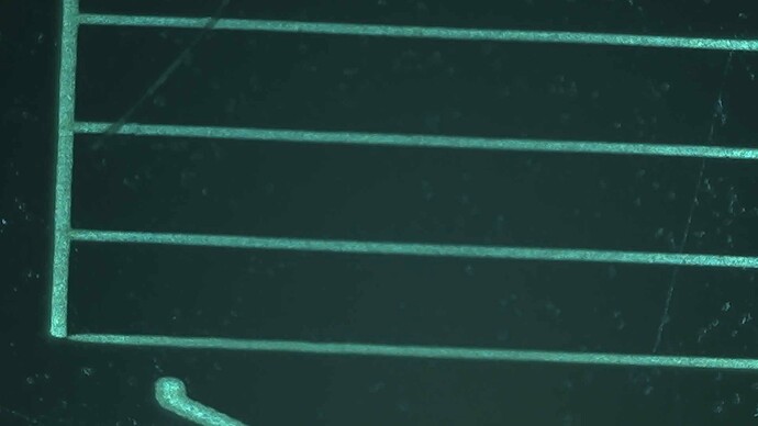

I see the pulses compress near the start and stop of vectors. This can mean only one thing.
Each pixel or series of pixels (let’s call both a “dash”) is sent as an independent vector. It does a jump between them, and waits a jump delay at the start point.
This is going to cause a number of confusing effects.
A dash will have overburn on start/stop points. It’s actually capable of higher accel than I imagined- clicking on “device settings”, it suggests 1,500,000 mm/s^2. As best I understand this doesn’t actually come from the BJJCZ, nor does it get sent, it’s a LB-only sim param, so it could be anything, but I assumed it was somehow similar.
To get to 5000mm/s would need (5000mm/s)/(1,500,00 mm/s^2) =3.333ms
distance traveled
=1/2*a*t^2
=0.5*1,500,000mm/s^2*0.00333s^2
=8.3mm
but, no, it looks like 4 pulses before it reaches CV, or before it brakes to a stop. That would be 0.8mm.
Still, there’s overburn at the start and stop points. But if you set jump delay=0, and jump speed=raster speed, it will not wait at the stop point, and the command to fire for a dash is immediately followed by command to jump in the same direction at the same speed. So, no settling time is even needed anyways. It WILL go constant velocity. In fact this seems to be the only way to get CV without overburn!
Except now will distort the line jump START point. I had to set jump delay=0, and there’s no other delay that would apply to start of the raster line. Since the jump either from 90 deg off (bidir) or almost 180 deg (unidir), it’s going to need settling time for that one. This distortion could go unnoticed for a coin because it would just have some funk on the edges.
I think LB is maybe handling the BJJCZ commands wrong here. I can’t find a manual with the protocol description yet, though. Just pinouts, they’re hardware integration manuals.
I may try to convert back to EZCAD and see how it handles it

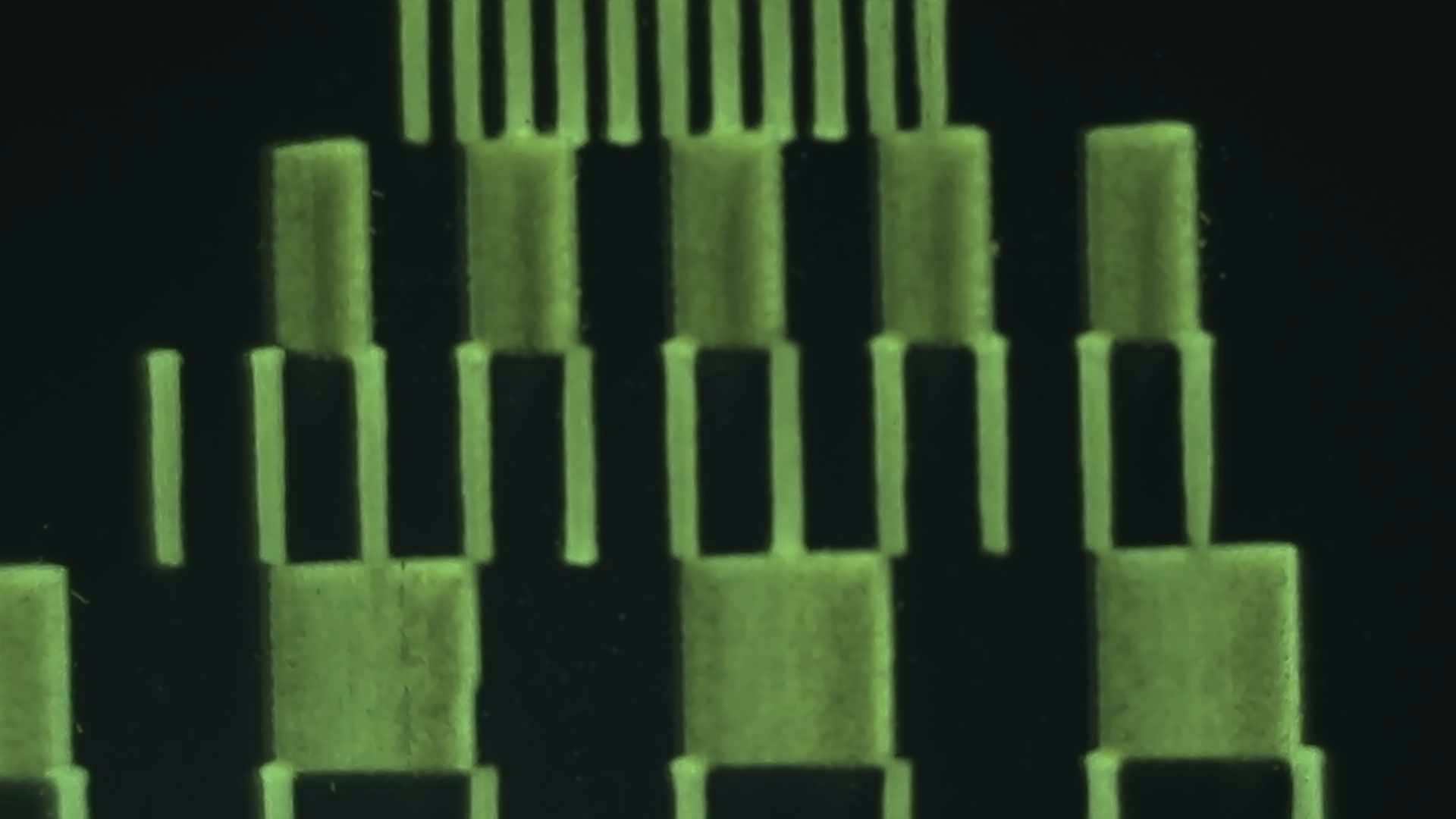

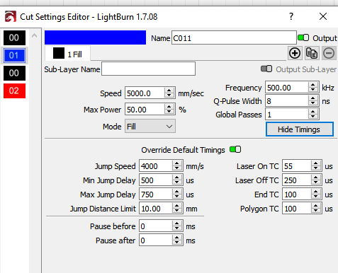

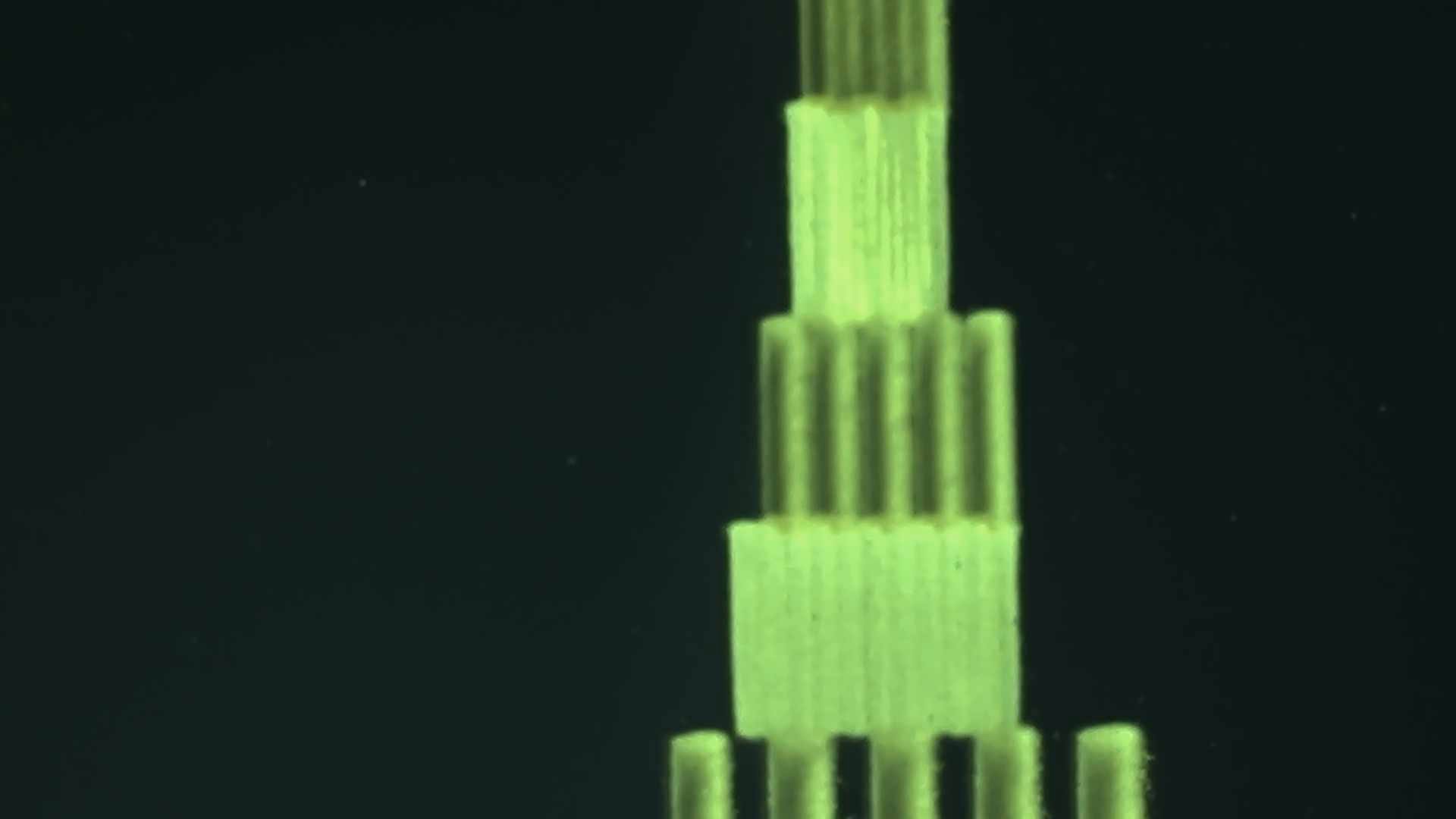

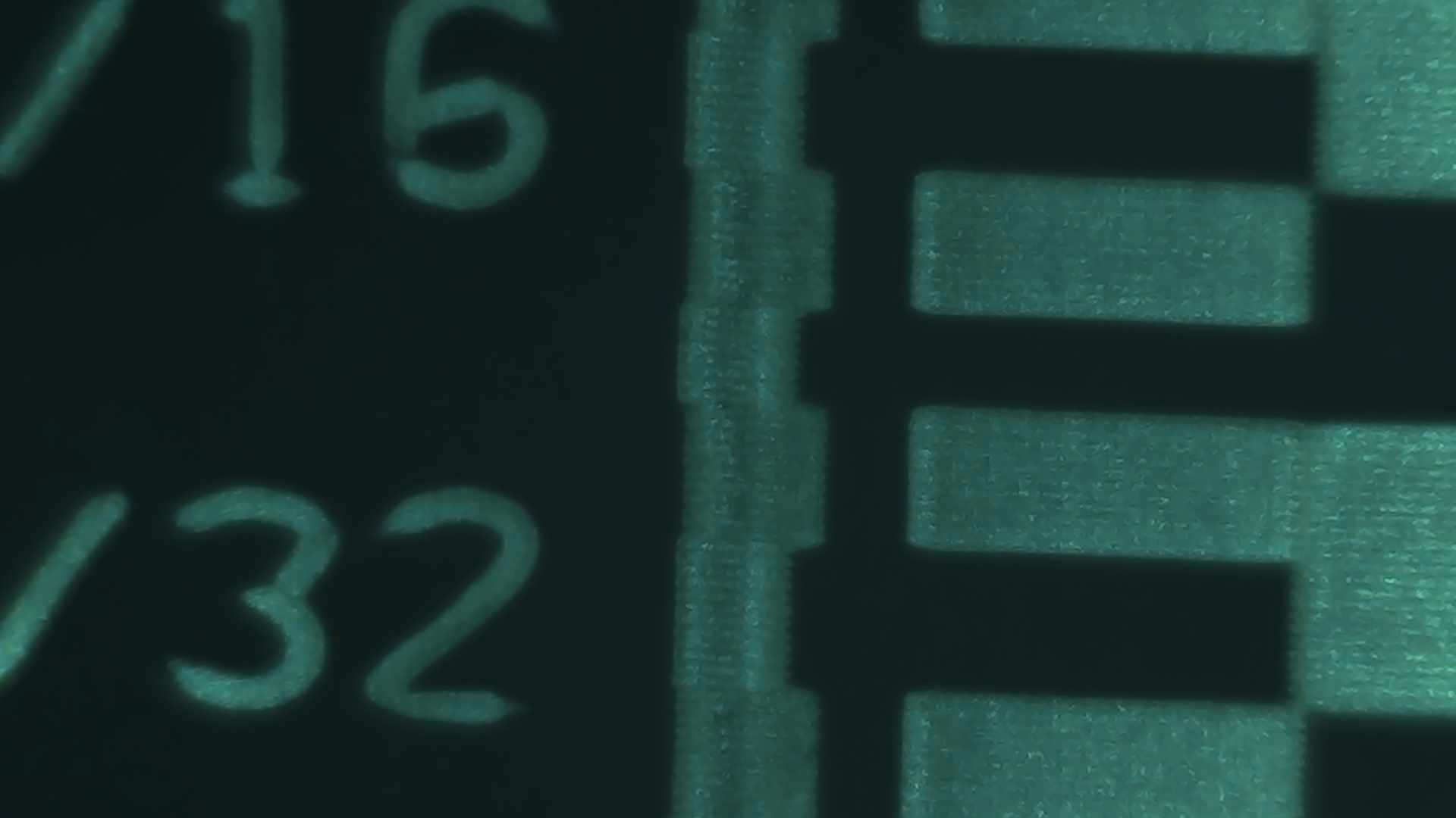

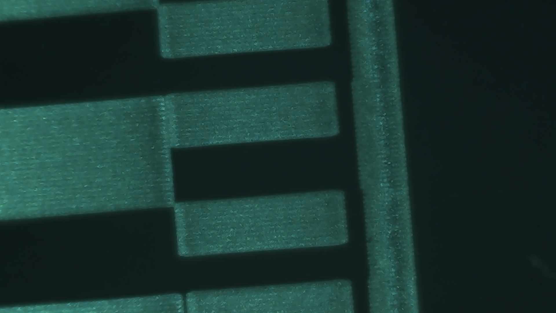

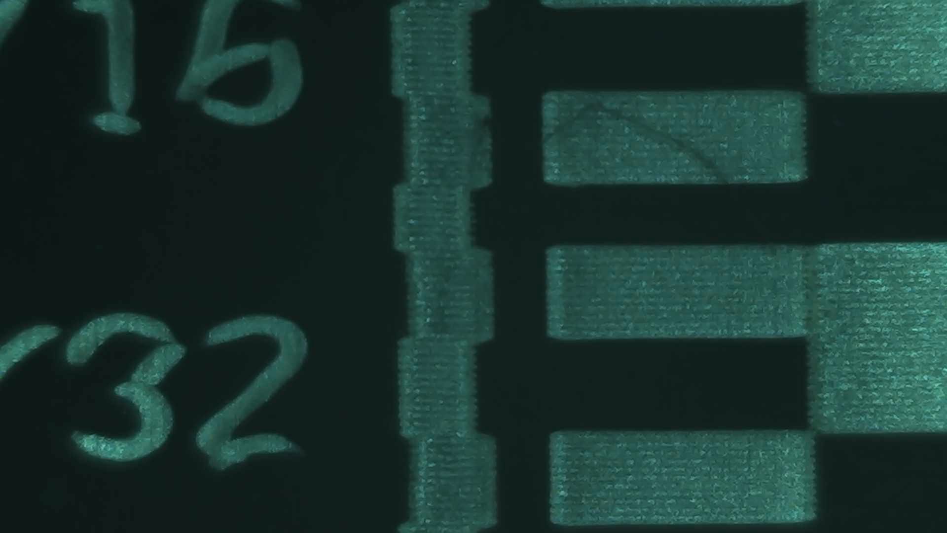

Current settings this is what I have with the new test.
About halfway between 8 and 16 on the left.
Right about 0 on the right
Math: Old TCON 85+(1000000/5000)/12=101.667 New TCON
Results
So I’m going to sat between +64 and +32
Old TCON 102+(200/48)=106.167 New TCON
Try again
Old TCON 106+(200/32)=112.25 New TCON
Woo Hoo!

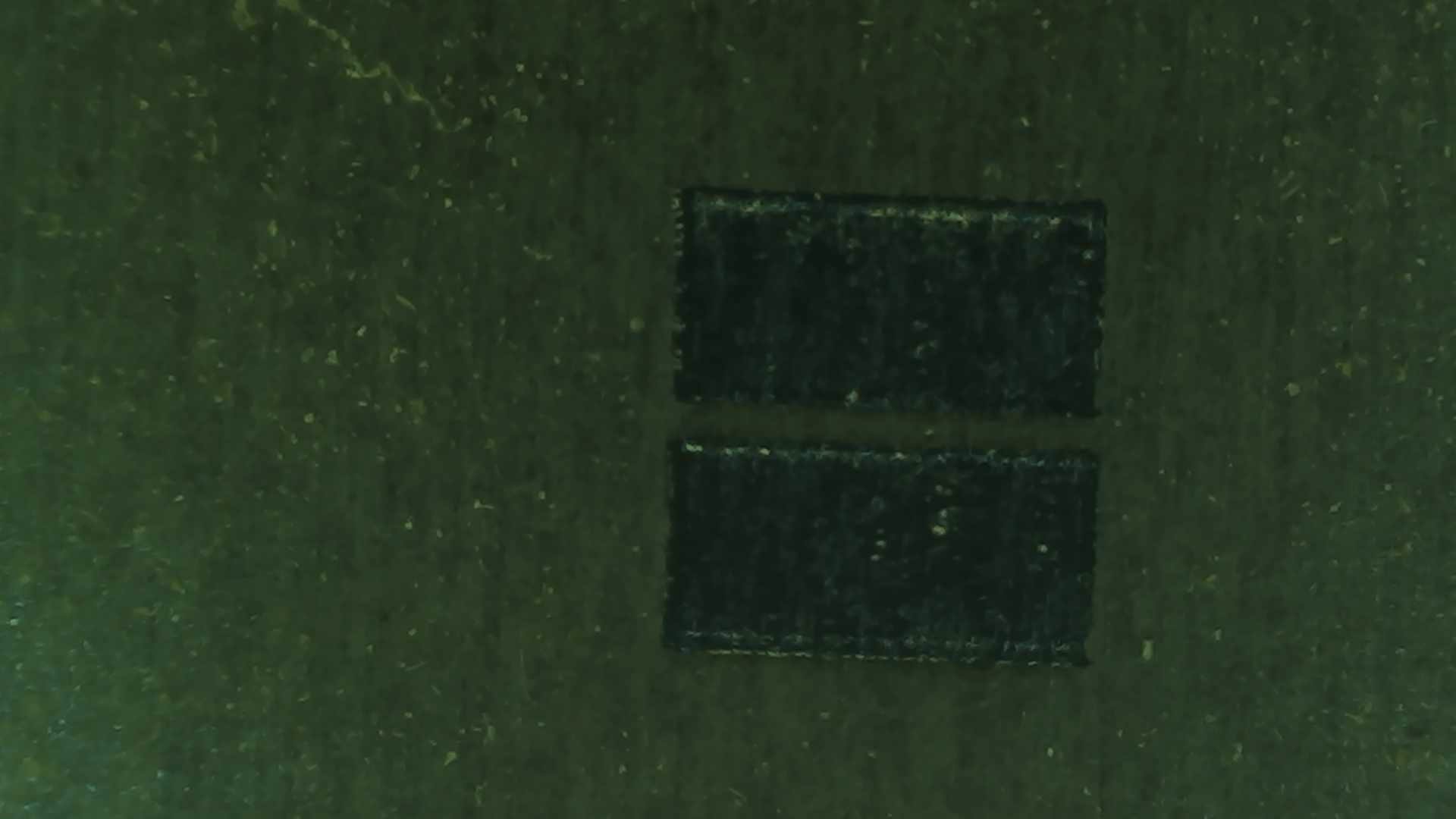

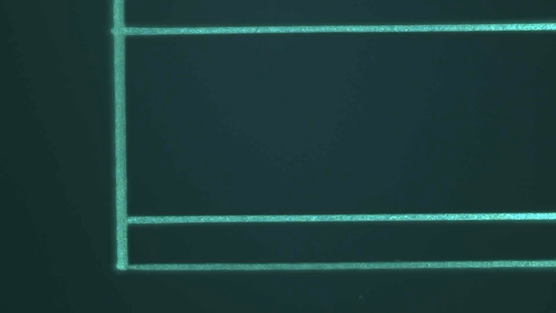

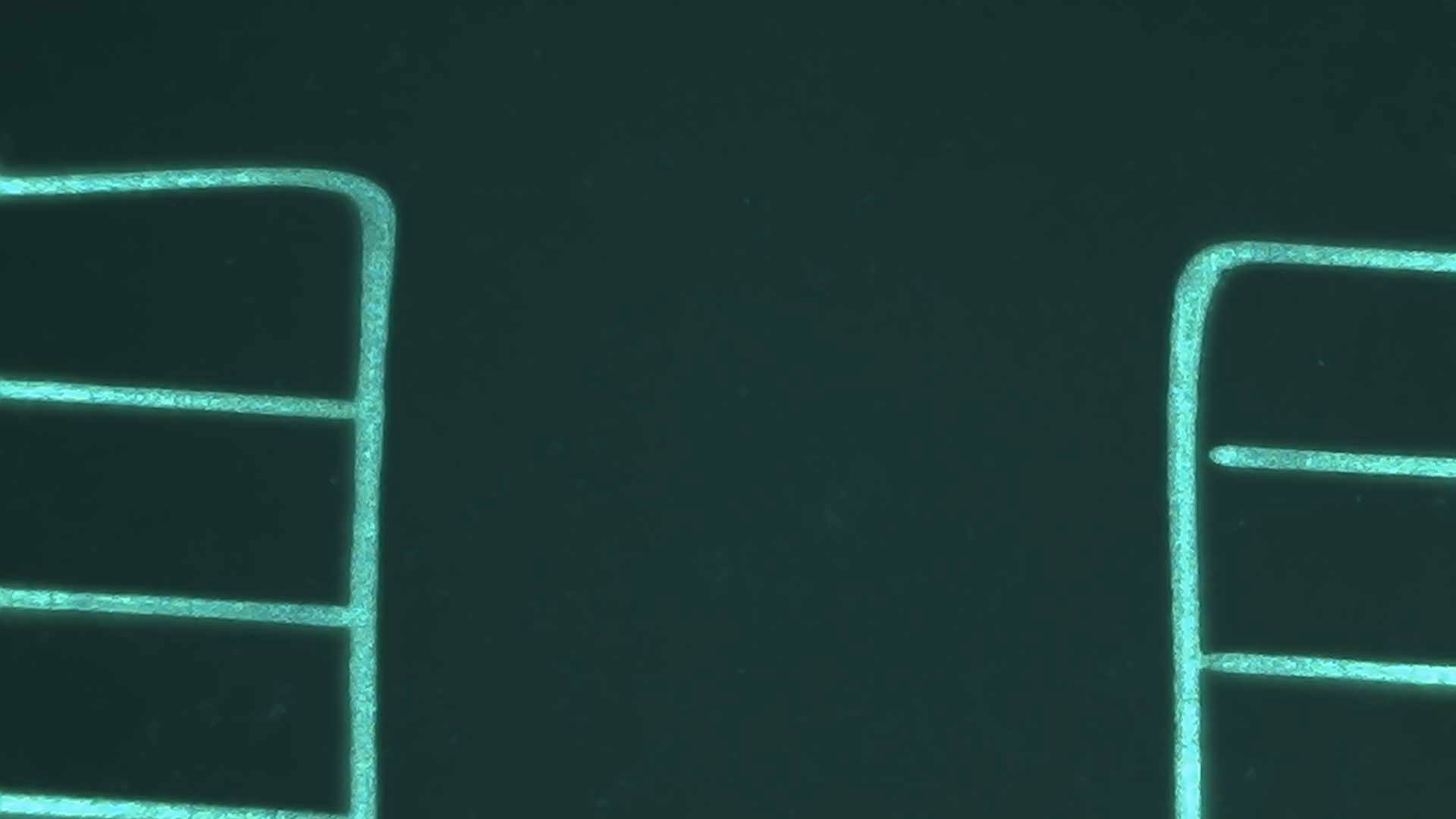

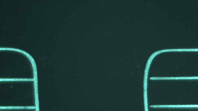

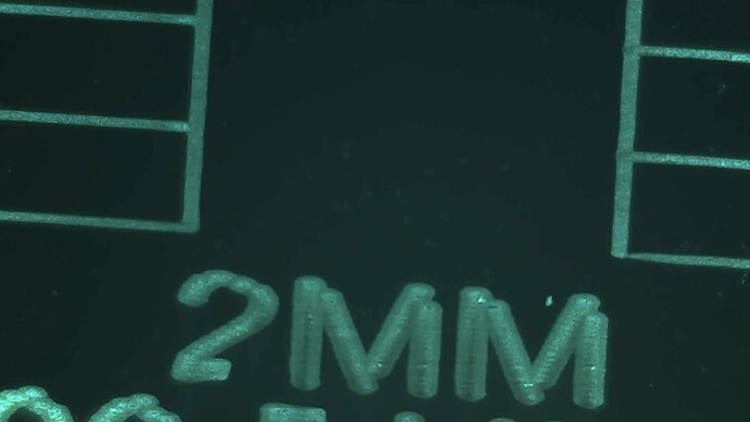

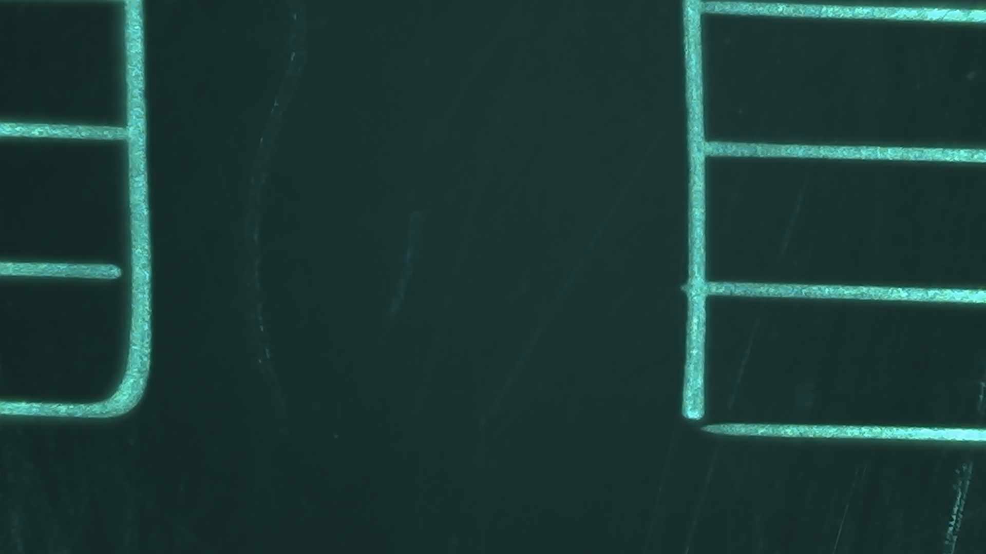

Tried the rectangles, 2 mm apart, 0.5 LI on the fill. Poly could not corner at 5000mm/s. Turned jump delay up to 2000-2000, No difference.
Tried upping the Poly Delay, just ran by and burned in.
Lowering made it worse as could be guessed.
Slowed down to 1500mm/s
So need to get Poly to corner better. Another argument for overscanning.

this isn’t the right way to do it. it should be going down the line at constant velocity and switch the laser source onoff as it goes down. and it should “overscan” by starting about 1 mm ahead of the start point, colinear with the raster line, accelerate to CV before the line starts and switch the laser onoff as it goes.
seeing as it’s not able to do CV at all, asking for overscan seems to have little purpose well, it does mean you can set jumpspeed to equal raster speed and zero out the jump delay to make it raster a line smoother. but then there’s no jump delay after the mirrors jump to the start of a line and it will be a bit wavy. this kind of sucks as a fix because even though you can override the jump speed and delay per layer, that overrides ALL the parameters. so if you calibrate a new timing number, all your materials library entries that override the jump stuff will have to be updated because they override everything and discard the global one
if we had overscan today and fixed nothing else, then it would start outside the raster, then jump towards the raster line while already colinear with it, and the wobble would dampen out before reaching the line itself so no jump delay needed anyways
