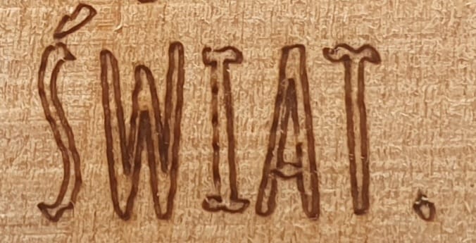

How can I convert entire double-lined texts into single-lined texts for each letter, using different fonts? I need to print and engrave very small, thin texts.
The photo shows a double line for each letter.
Look into SHX fonts and how to set them up.
That’s possible for Text generated within LightBurn: double-click the text and use the text editor box that will pop up.
However, if those shapes were imported from another program through an SVG / DXF file, they’re (almost certainly) paths with no connection to the text / font that produced them in the other program. In that case you cannot change the font within LightBurn, because the shapes are not Text.
