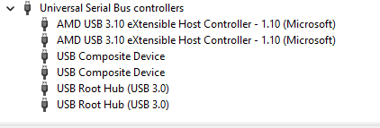

There is No CH340 driver in device manager, and I can not get it to show when I download and install.
Does it show when you plug in the laser USB cord? It should pop up and include the COM port number. When you unplug the laser, it will go away.
This is a “sudden” new problem? You showed your GRBL parameters via $$, so it was working.
When I connect and disconect the usb, the pc chimes. The device is ready and shows on com 3.
Yes, it shows the $$ values. It has been 6-8 months since i have used it.
