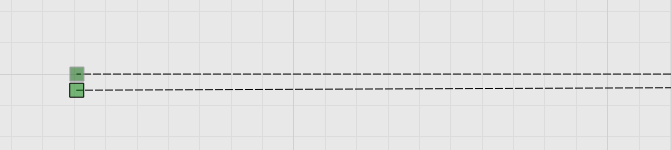

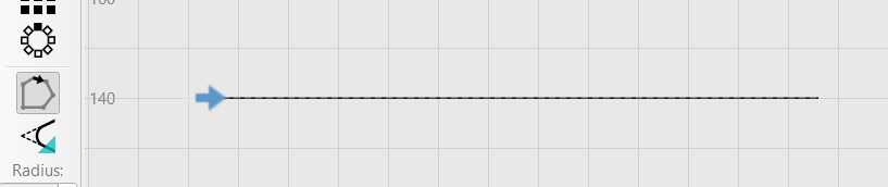

You’d have to draw the path as two lines - One from start to end, and one from end back to start. We don’t have the ability to set retraction speed in the software, so it would do a full speed lift at the end of a single-direction line, and that would be too fast, so you’ll want it to come back out the hole it went in.
If you want to guarantee the entry point, use the ‘Start Point’ tool and click on the start. The blue arrow is the starting point:
That “line” is actually two on top of each other, drawn by clicking the start, the end, and then the start again, then hitting Esc.
If I pull the ends apart, you get the above ^
Do a profile, ‘Along Line’, with the Final Depth and Depth Per Pass set identically, with a Plunge entry.
In the preview it will look like a slot (we don’t handle undercuts), and if you’ve done it right you’ll see the entry and exit lines are the same, like this:
