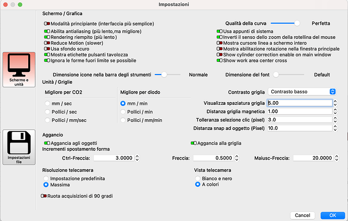

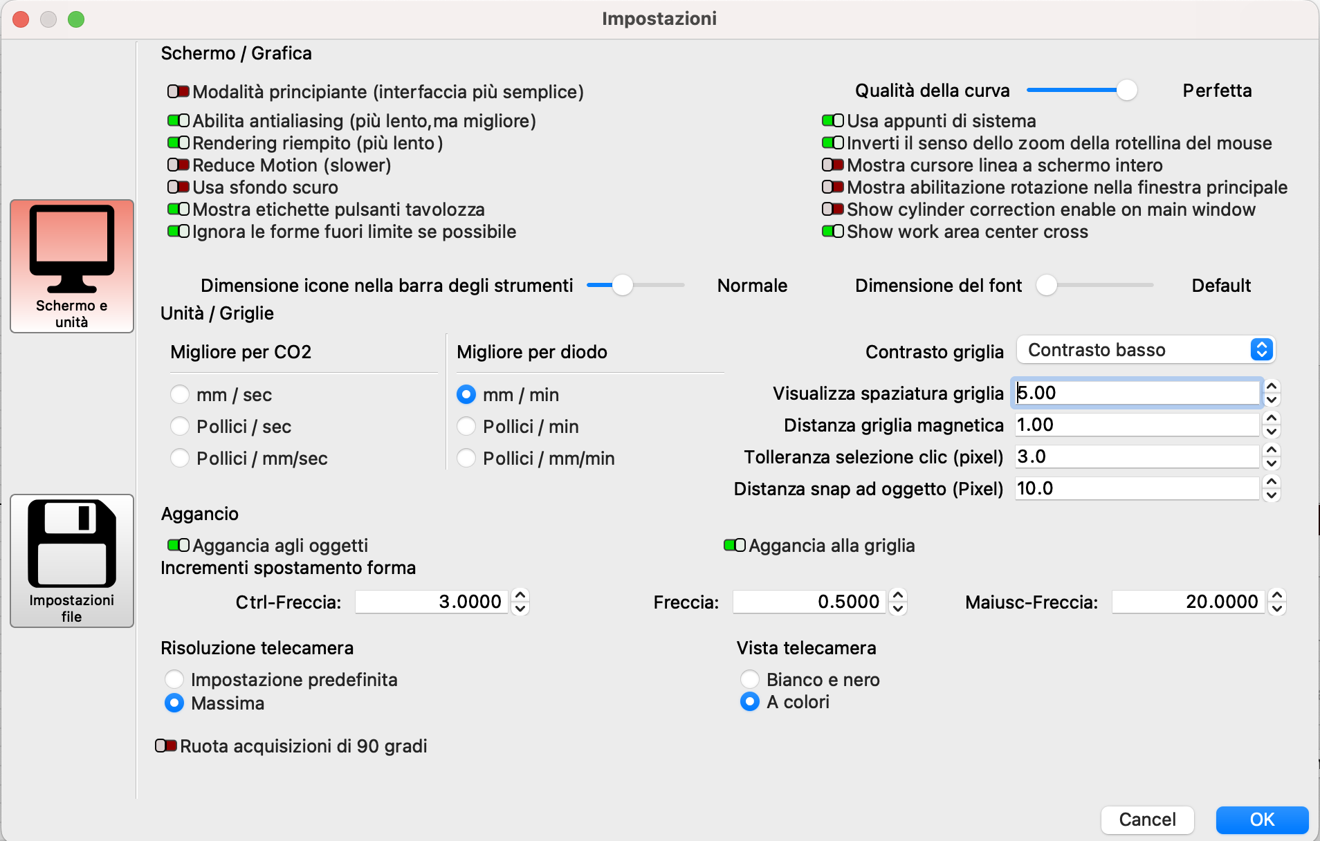

Perhaps you have LightBurn set for mm/sec rather than mm/min, in which case the laser will be moving 60 times too fast and won’t make much of a mark on anything.
Or it can be set for in/min when you’re thinking mm/min, which will run only 25.4 times too fast.
All those are in Edit → Settings.

Hi ednisley
I work in mm/min and with air assist and It has a fixed focus that I adjust with a 2mm plate
I am attaching my settings

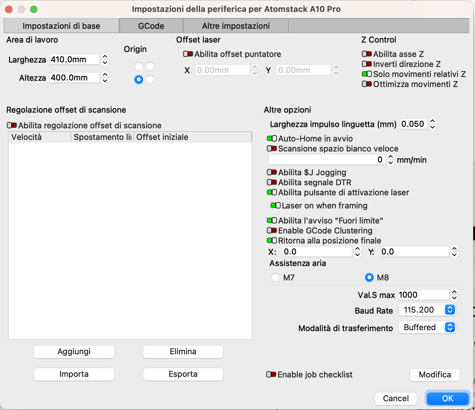

Does the value of GRBL $30 match LightBurn’s S-value Max? Both should be 1000.
Beyond that, I must defer to other folks around here who know more about the less obvious problems.
Value of GRBL $30 match LightBurn’s S-value Max ? Both should be 1000 ?
I don’t understand which setting you are referring to
In the Console window, enter $$. You can scroll and find the $30 value there. In the Edit, Device Settings window, look in the lower right for S-value max. Those two numbers should match.
Hi MikeyH
It seems that the values are correct

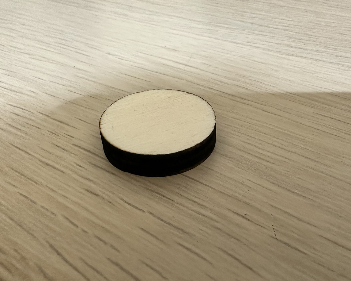

I tried various types of plywood and at most I managed to cut the 4mm.

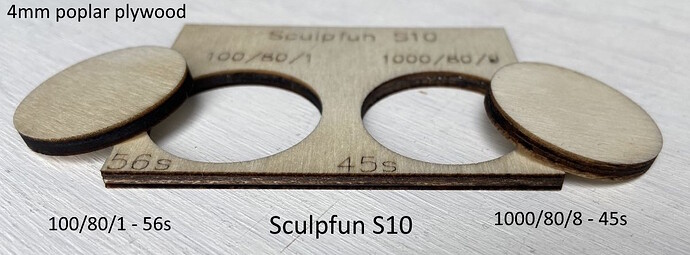

In general, try to use faster speeds and more passes. The picture you show shows a very dark edge with a lot of charring. That is even harder to cut. Going faster will lead to less charring end easier cutting. See this as an example:
