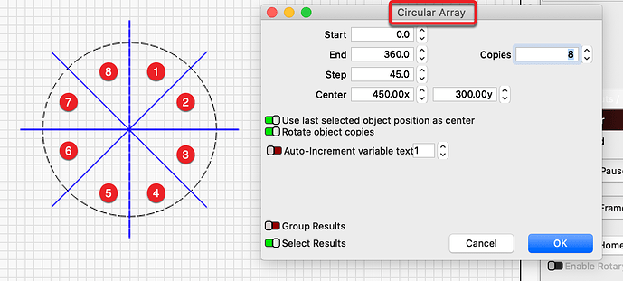

How to cut a circle to 1/8 of a piece?
I am trying to divide a circle to 8 pieces but I can’t seem to make it work, I can do 1/4.
Any advice?
How do you plan to use the divided circle? That will determine strategy for how to divide it. And are you assuming pie slices? Or some other shape?
Draw circle
Draw vertical line
Draw horizontal line
Select all, click on icon that looks like a bullseye
Draw another V and H line, center those two.
Press SHIFT + “,” to rotate 45 degrees
Select all again, and press the bullseye icon again.
Drink coffee and be happy
Thank you!
Another way… :wink:
