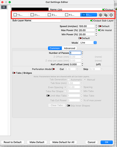

If creating a closed shape is not an option for whatever reson, there is a beter workflow than creating multiple copies. In the Cut Settings Editor, add 4 sublayers with the same cut settings. This will cause the entire shape to burn on each layer. This eliminates any possibility of alignment issue when duplicating the shapes.

  3. Open the Cut Settings Editor on the layer you’re working with
  4. Use the + button to increase the number of sub-layers. This only goes up to 11 as an arbitrary limit. I suggest setting this to 10. Make sure each sub-layer pass has the appropriate settings.
  5. Run the job 3 separate times to get you the 30 overall passes you want.

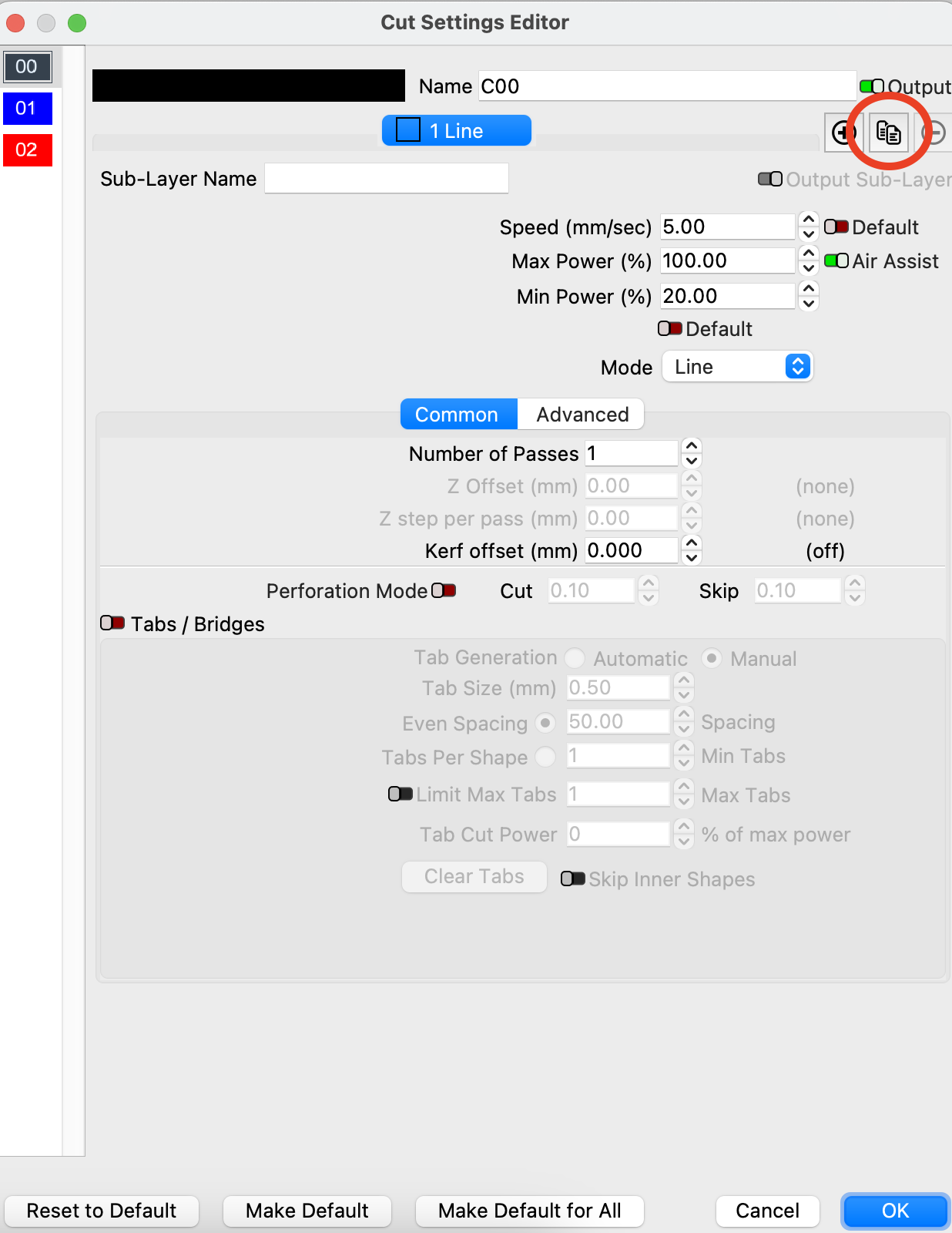

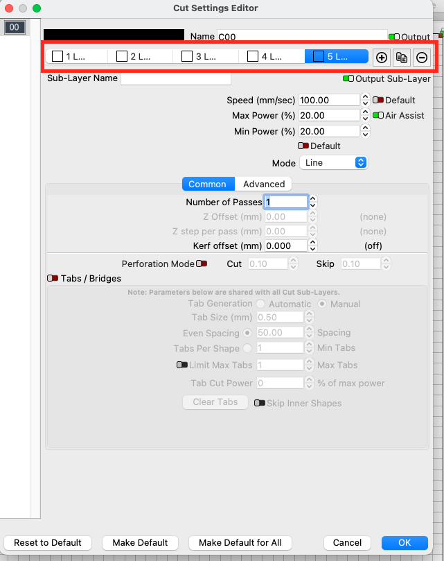

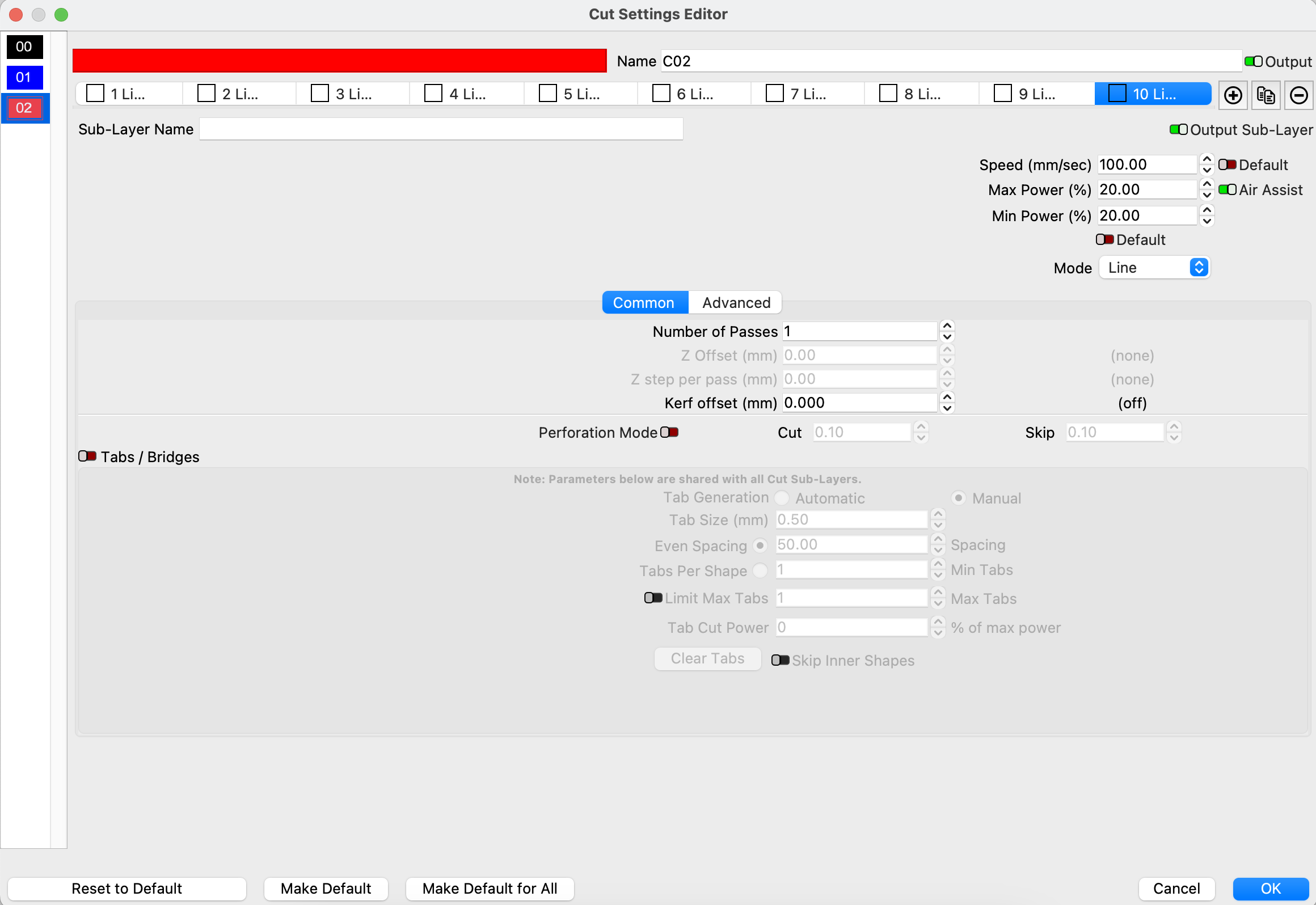

I think I found a way to get the results you’re looking for. First, get rid of all the duplicate shapes, leaving just one copy of the clock hands and hole. Group the shapes together (both sets). Create 1 duplicate and set it to a different color layer. Repeat this step again. That will give you the same shape on top of each other 3 times, each with a different color.
Now, select one layer in the Cuts/layers panel and double click to bring up cut settings. In this dialog box set all 3 layers to the proper speed and power settings with only 1 pass. You can select the different layers from the left side of the dialog. Once you have those set properly, click the clone layer button 9 times. (see images below) This will give you a total of 10 sublayers for that color. Repeat for the other 2 colors. This will give you a total of 30 cuts, with each shape being completely cut (hole and outline) before repeating. When you click OK, your cuts/Layers will say multi instead of line. We have to do it this way because we are limited to 11 sublayers per color.
I did try it with setting to 3 passes for each sublayer, which works, but because of the algorithm it runs 6 passes on the hole between sublayers. The way I did it above it only does 2.
Beware, the outer shape may cut completely before finishing and the entire hand may shift slightly before finishing the holes.
Worked absolutely perfectly.
