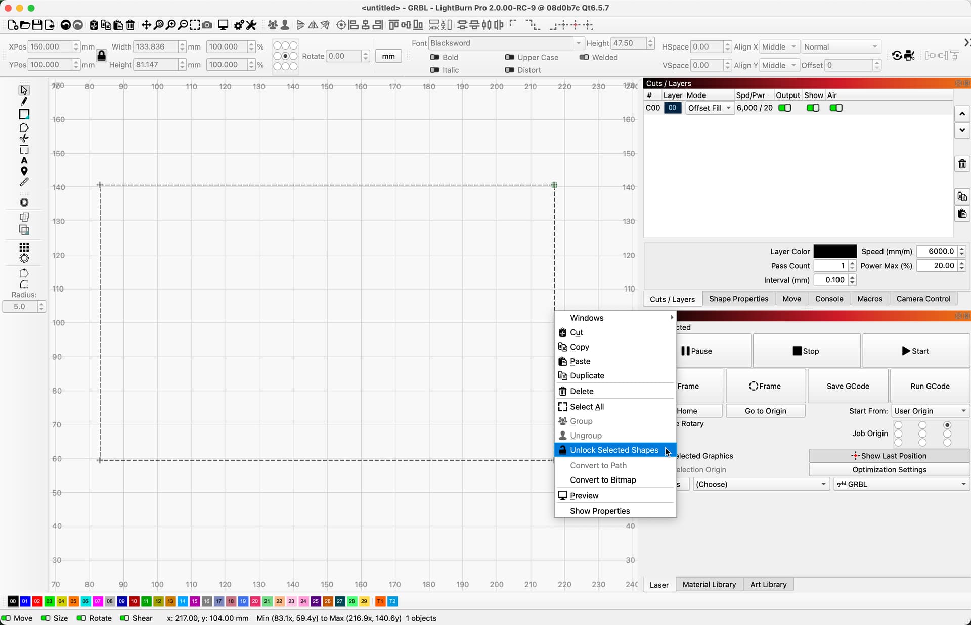

When i first installed lightburn, i just had a blank grid, but the rectangular box now stays on the screen, despite what i type over it. It will not expand or delete.
A screenshot of your entire Lightburn screen(not a phone pic) would be very helpful.

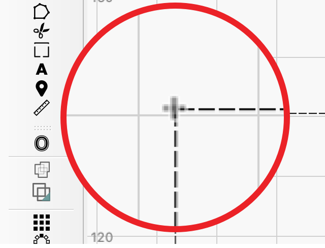

@Flarge, when zooming into a corner of this rectangle box, do you see a ‘+’ similar to what I show below? :slight_smile:
This indicates the shape is ‘Locked’, meaning you cannot move, re-size or delete the shape until it is ‘Unlocked’. If this is the case, you can unlock a selected shape(s) using a right-click and selecting ‘Unlock Selected Shapes’.
