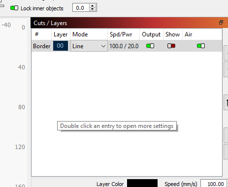

If I press the circle icon on the left and then hold down the shift key, then drag the mouse to make my circle, when I let go of the mouse button, the circle dissappears. What am I doing wrong?
Is your current active layer (color) set to “show” in the layer list… or did that perhaps get turned off?
