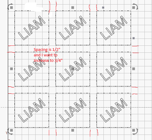

I am an old whiteheaded guy so not the most tech savvy… I have searched to find a way to increase the Edge Padding of several Grid Array projects I have Saved to no avail… I can only find the Grid Array Icons on Main Screen as well as in the Edits, which seem to only take me to Design of a New Grid Array… I really do not want to have to start over as it was painstaking for me to get to where I am now… Will appreciate any suggestions, ideas or guidance on this issue… Thank You, John R. Petrea

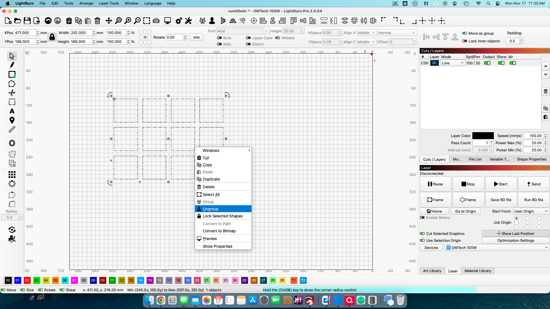

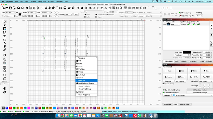

It’s not starting over. Your design will remain unchanged. Just ungroup the results, delete everything except the first item and recreate the array with your new spacing dimension.
