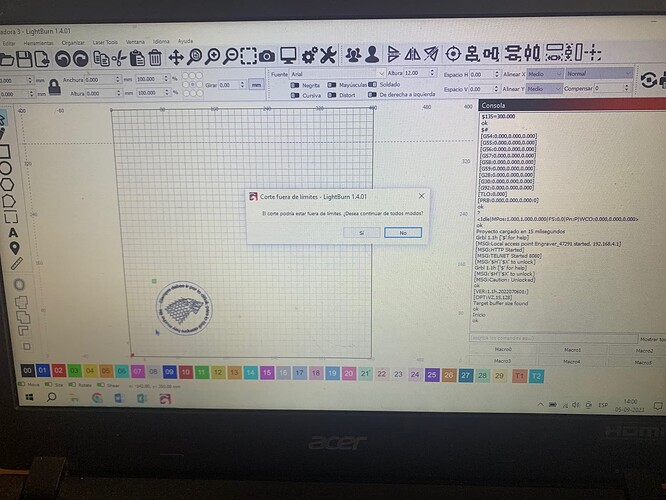

It shows this warning for out of limits
berainlb
(PY)
September 5, 2023, 5:07pm
30
Has it always shown this when attempting to burn? If not, make sure you home first. Don’t move the laser head by hand after homing.

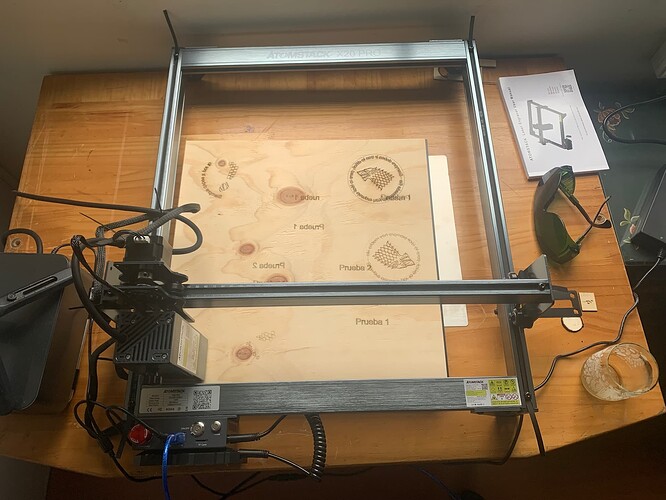

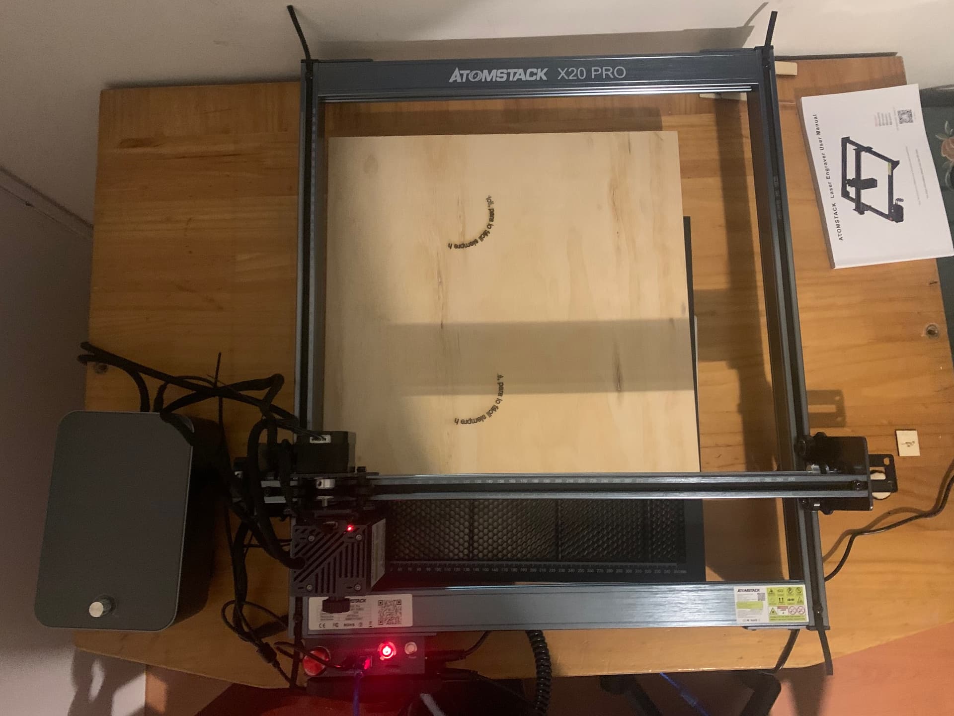

Maybe I put together the machine in a wrong way?
berainlb
(PY)
September 5, 2023, 10:05pm
35
I was considering that as a possibility because of the symptoms but you saying that jogging controls and homing all work in the correct direction so that doesn’t seem as likely.

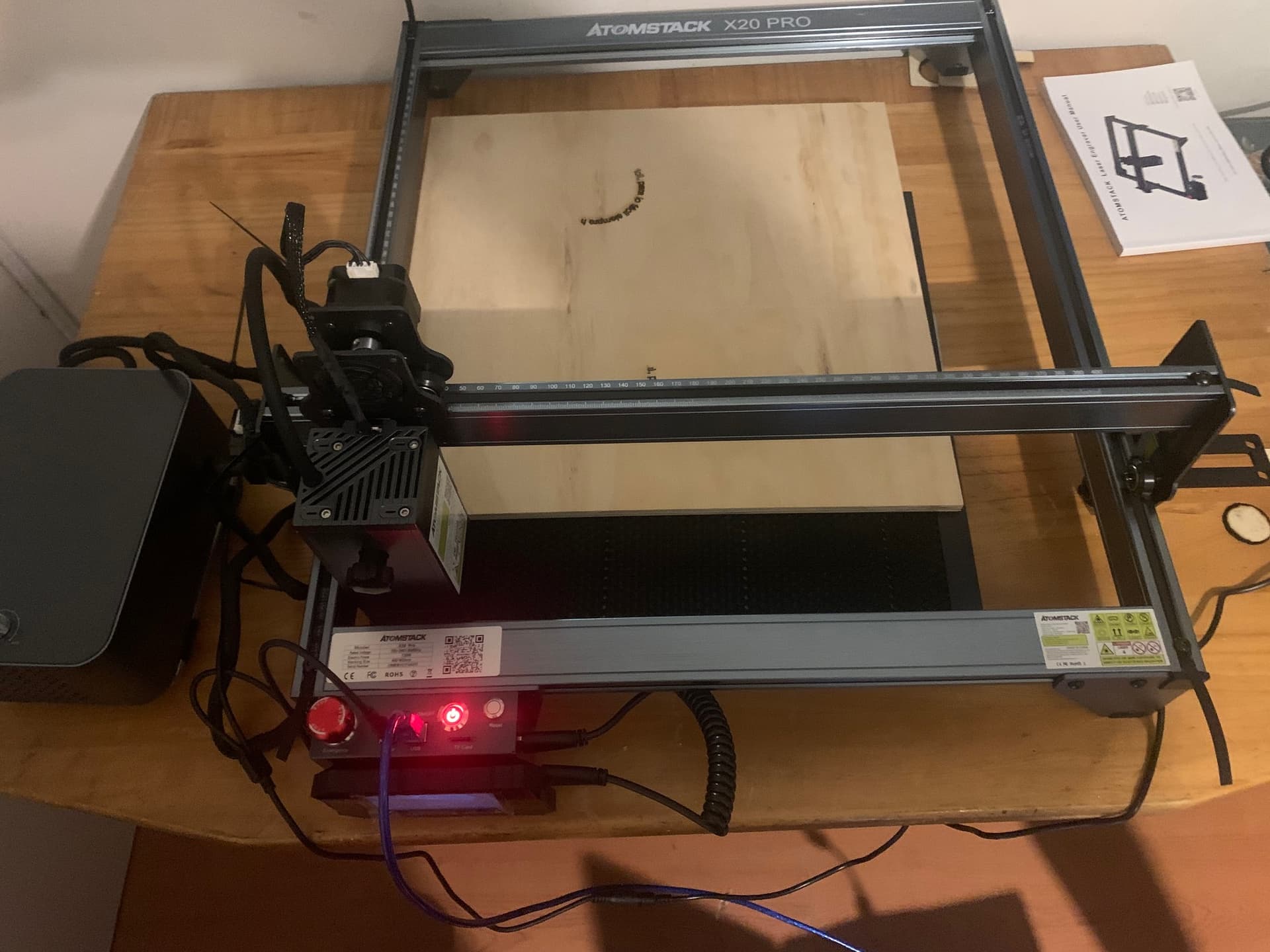

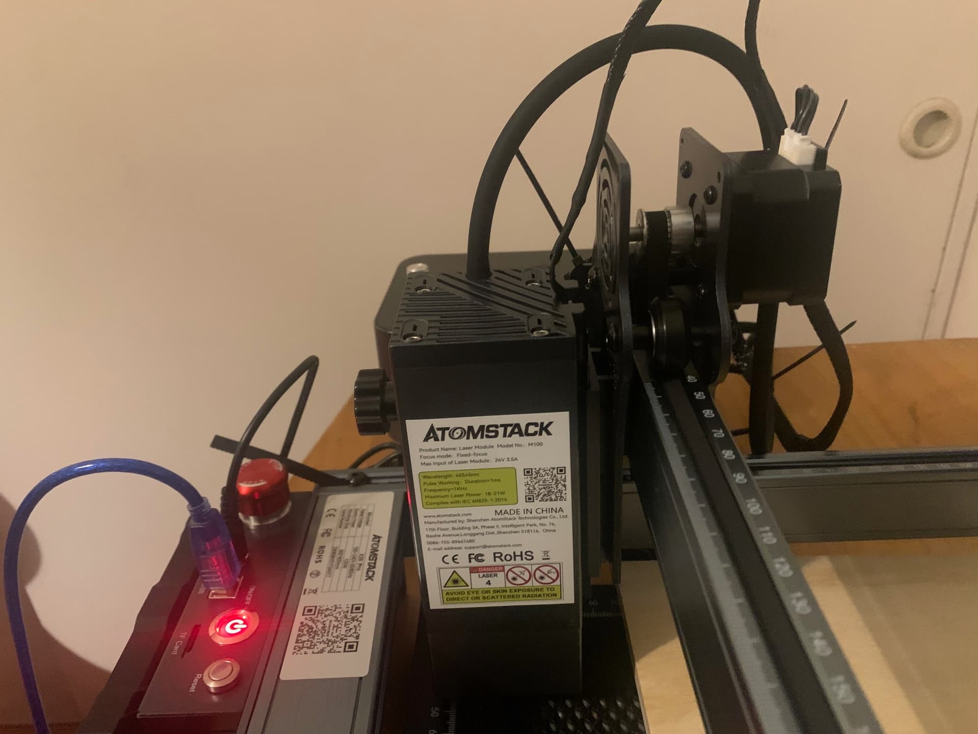

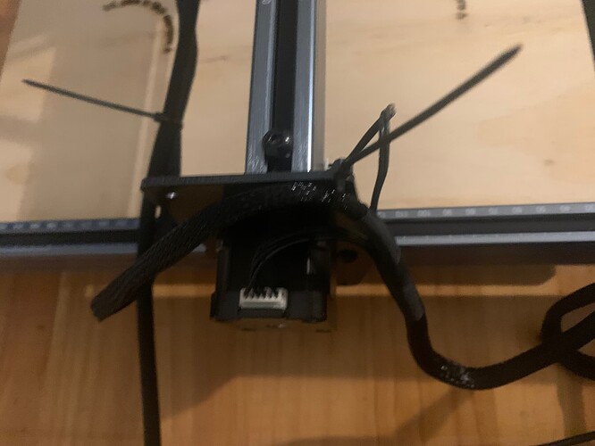

Emiliofa
(Emilio Farga)
September 6, 2023, 1:04am
39
I do not understand what you mean, I’ll send you photos of how is my machine build
Emiliofa
(Emilio Farga)
September 6, 2023, 10:51pm
40
Can you send me a picture/Diagram of what are you say?
