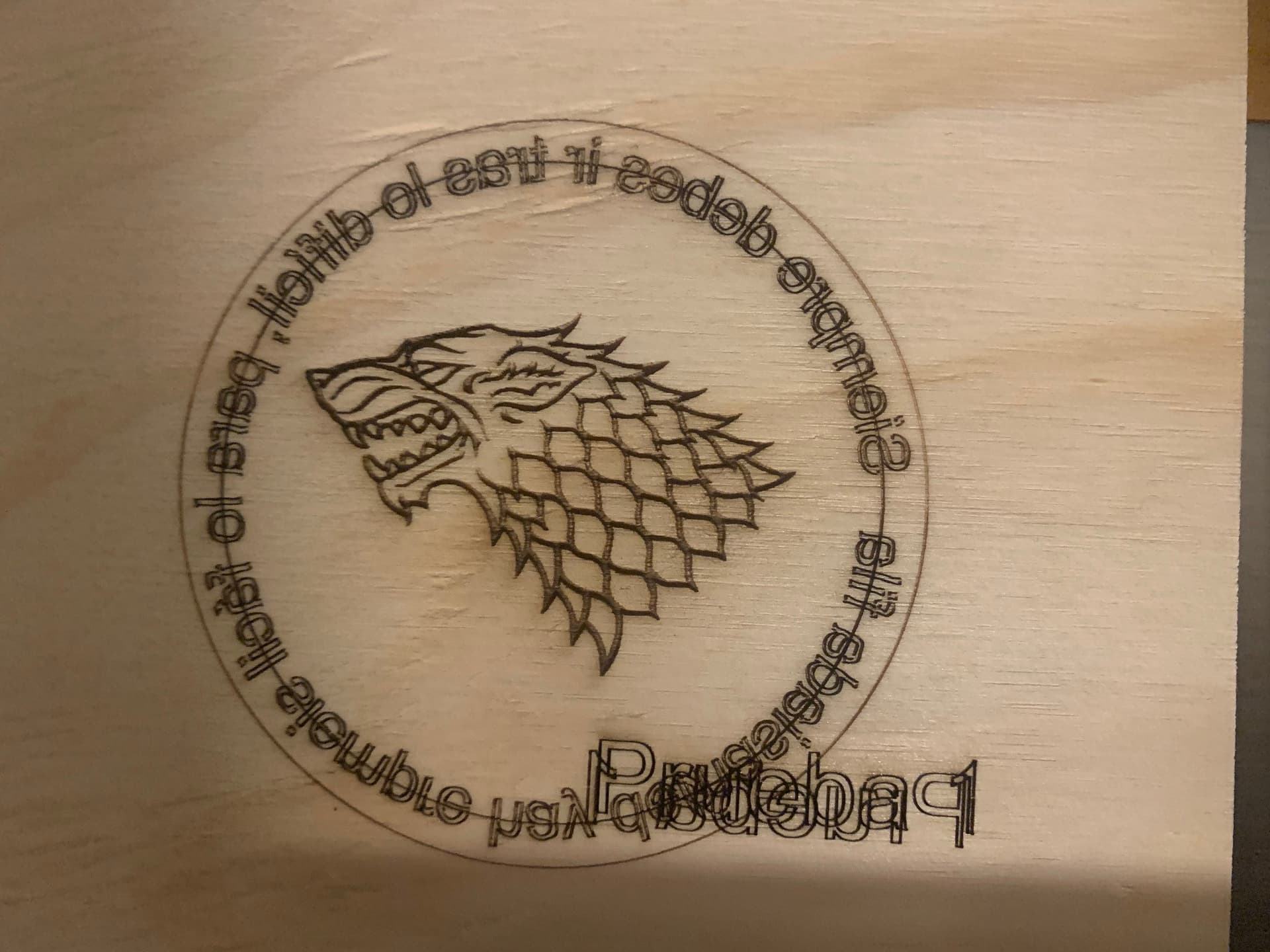

All my works come out inverse, like a mirror, I don´t know how fix that bug. I Have a Atomstack X20 Pro. Please Help

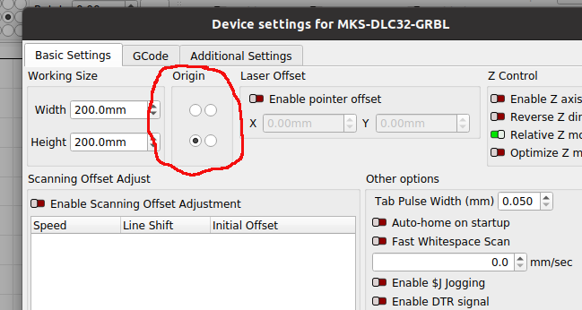

This is usually caused by the wrong origin in the device settings…
Which ever corner your machine goes to on power up is the origin…

The origin determines which quadrant you are operating within. The only thing I know of that causes artwork to be mirrored, is operating in an incorrect quadrant.
Is the image flipped vertically or horizontally?
It flipped vertically, I’ll try changing spots to see if it works right

If it’s a vertical flip then it’s across the X axes moving it to the same side but opposite end will probably correct the issue.
I put the origin in the 4 positions, when I change the position, the text changed to a mirror look, in front left position and the text in a mirror way, the work came out ok, but I d not want to work this way

writing every thing in mirror look

Did you set the origin in the Device Settings of Lightburn to same corner?
Yap just lke that

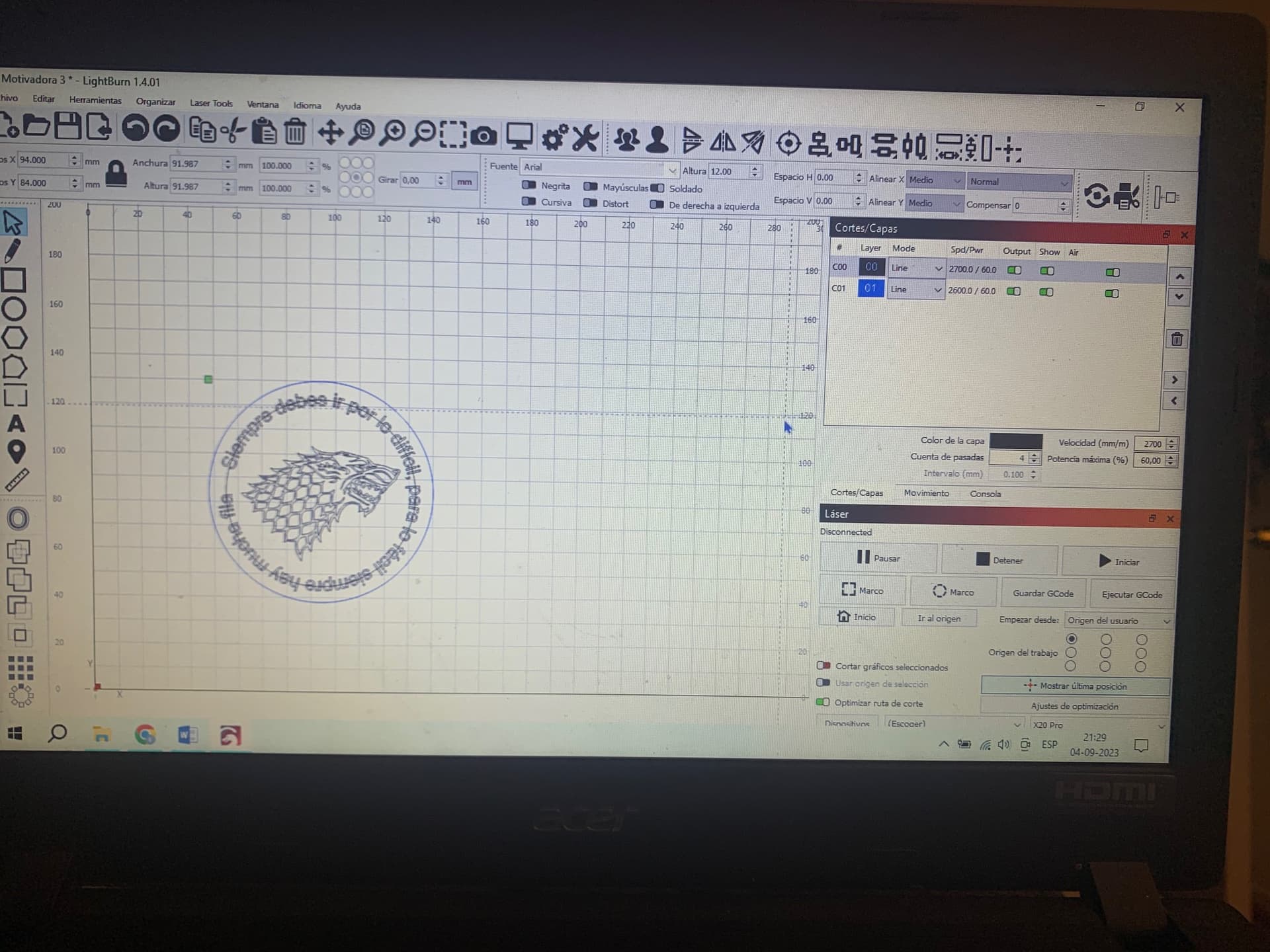

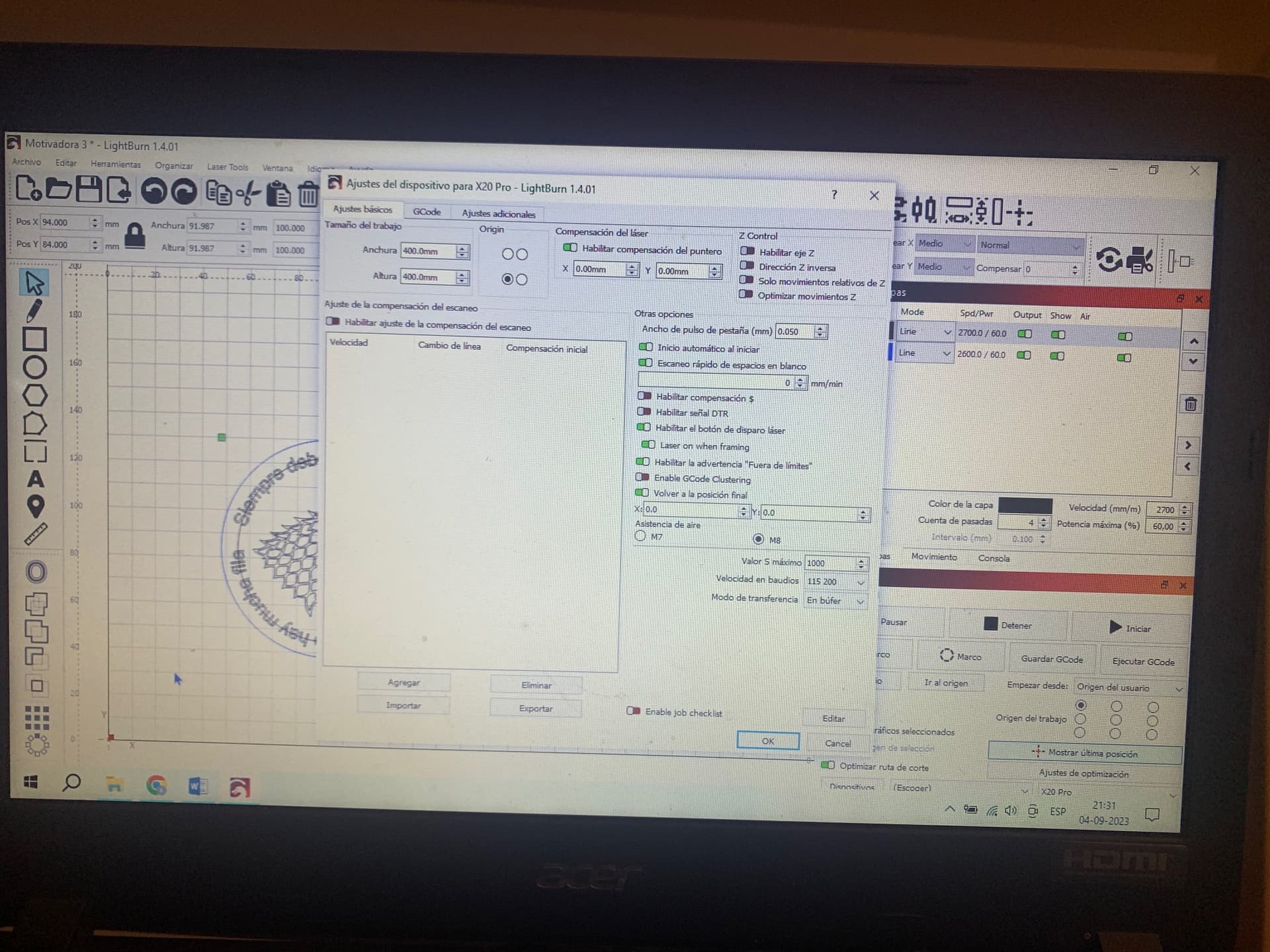

Please provide the following:
  1. full screenshot of LightBurn with your design loaded and ready to burn
  2. screenshot of Edit->Device Settings
  3. photo of resulting burn
Thanks… wasn’t sure where to go next…
Thank you for getting involved, I’ll send the pictures tomorrow, today I’m not at home
